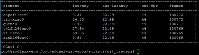

I'm working with SDK 9.0.0.8 and trying to get an OnSemi AR0521 sensor to stream clearly at 60 FPS. I have written my own driver for the AR0521 that is very similar to the OV5647 driver since I found issue with the native linux driver and have yet to get it to stream even with the little I have tried using it. I'm set up for a resolution of 2600x1952 and believe there to be 440 Horizontal Blanking and 316 Vertical Blanking. I have measured the frame time with a oscilloscope and found it to be 16.6 ms as expected for 60FPS. The MIPI clock is running at ~515MHz measured by the oscilloscope. The max exposure time (Course Integration Time for the sensor) in the driver and gsttiovxisp.c is set to 2260. I'm using bin files created using Imaging project version 9.0.0.5. I'm currently seeing choppy video which leads me to believe that my configuration is dropping frames and I also don't believe that the frame rate is at 60, as expected.
I'm using the following Gstreamer command to stream H264 packets:
GST_DEBUG_FILE=/run/trace.log GST_DEBUG_NO_COLOR=1 GST_DEBUG="GST_TRACER:7" GST_TRACERS="latency(flags=element+pipeline)" gst-launch-1.0 v4l2src io-mode=dmabuf-import device=/dev/video3 ! video/x-bayer, width=2600, height=1952, format=grbg10, framerate=60/1 ! tiovxisp sink_0::device=/dev/v4l-subdev2 sensor-name="SENSOR_ONSEMI_AR0521" dcc-isp-file=/opt/imaging/ar0521/linear/dcc_viss_GRBG_10b_2600x1952.bin sink_0::dcc-2a-file=/opt/imaging/ar0521/linear/dcc_2a_GRBG_10b_2600x1952.bin format-msb=9 ! queue max-size-buffers=1 leaky=0 ! v4l2h264enc ! rtph264pay config-interval=1 pt=96 ! udpsink host=xxx.xxx.xxx.xxx port=5000
And here is the output from the TI gst_tracers utility:
I see the same/similar results in gst_traces if I use a fakesink instead after the v4l2h264enc plugin.
I have produced smooth streams at with the AR0521 configured at 27.5 FPS (an FPS provided by the sensor configuration software).
I have tried using SDK 9.1.0.0 but currently am seeing 35 out-fps across the board. Also, I would highly prefer a solution using the 9.0 SDK as I have a custom image for my custom board that I don't want to migrate at this point.
I'm hoping to get some assistance on where to look to see what piece is causing the bottleneck or dropping frames at this point since I've done a bit of troubleshooting and haven't found the root cause yet.

  • Hello Steve,
    Can you share the source code of gsttiovxisp.c? Did you mean you fixed the exposure time to 2260? What's the unit of 2260, e.g. number of line periods?

  • Hello Jianzhong,
    Thank you once again for your assistance! Here are my current gsttiovxisp.c settings:

    I realize that I will need to adjust exposure time to make it work with the DCC tool and will do when I need to.
    I have been testing some things out using your provided commands but I did find that none of them would run on my system as is, most likely due to not having a monitor attached that supports the high resolution. Also, I don't think 1) would work due to not doing any kind of Bayer conversion.
    So for example, "2)  measure the fps with ISP"
    root@am62axx-evm:~# gst-launch-1.0 v4l2src io-mode=dmabuf-import device=/dev/video3 ! video/x-bayer, width=2600, height=1952, format=grbg10, framerate=60/1 ! tiovxisp sink_0::device=/dev/v4l-subdev2 sensor-name="SENSOR_ONSEMI_AR0521" dcc-isp-file=/opt/imaging/ar0521/linear/dcc_viss_GRBG_10b_2600x1952.bin sink_0::dcc-2a-file=/opt/imaging/ar0521/linear/dcc_2a_GRBG_10b_2600x1952.bin format-msb=9 ! fpsdisplaysink text-overlay=false

    I did some researching and believe I got what your were requesting to work in a "headless" mode:
    GST_DEBUG=fpsdisplaysink:6 gst-launch-1.0 v4l2src io-mode=dmabuf-import device=/dev/video3 ! video/x-bayer, width=2600, height=1952, format=grbg10, framerate=60/1 ! tiovxisp sink_0::device=/dev/v4l-subdev2 sensor-name="SENSOR_ONSEMI_AR0521" dcc-isp-file=/opt/imaging/ar0521/linear/dcc_viss_GRBG_10b_2600x1952.bin sink_0::dcc-2a-file=/opt/imaging/ar0521/linear/dcc_2a_GRBG_10b_2600x1952.bin format-msb=9 ! fpsdisplaysink text-overlay=false video-sink=fakesink signal-fps-measurements=true

    Rates were the same for "3) add some optimization to the GStreamer pipeline":
    root@am62axx-evm:/opt/edgeai-gst-apps/scripts/gst_tracers# GST_DEBUG=fpsdisplaysink:6 gst-launch-1.0 v4l2src io-mode=dmabuf-import device=/dev/video3 ! video/x-bayer, width=2600, height=1952, format=grbg10, framerate=60/1 ! tiovxisp sink_0::device=/dev/v4l-subdev2 sensor-name="SENSOR_ONSEMI_AR0521" dcc-isp-file=/opt/imaging/ar0521/linear/dcc_viss_GRBG_10b_2600x1952.bin sink_0::dcc-2a-file=/opt/imaging/ar0521/linear/dcc_2a_GRBG_10b_2600x1952.bin format-msb=9 sink_0::pool-size=8 src_0::pool-size=8 ! queue ! fpsdisplaysink text-overlay=false video-sink=fakesink signal-fps-measurements=true

    However it dropped to ~45 FPS adding in the v4l2h264enc piece to the pipeline:
    root@am62axx-evm:~# GST_DEBUG=fpsdisplaysink:6 gst-launch-1.0 v4l2src io-mode=dmabuf-import device=/dev/video3 ! video/x-bayer, width=2600, height=1952, format=grbg10, framerate=60/1 ! tiovxisp sink_0::device=/dev/v4l-subdev2 sensor-name="SENSOR_ONSEMI_AR0521" dcc-isp-file=/opt/imaging/ar0521/linear/dcc_viss_GRBG_10b_2600x1952.bin sink_0::dcc-2a-file=/opt/imaging/ar0521/linear/dcc_2a_GRBG_10b_2600x1952.bin format-msb=9 sink_0::pool-size=8 src_0::pool-size=8 ! queue ! v4l2h264enc ! fpsdisplaysink text-overlay=false video-sink=fakesink signal-fps-measurements=true

    1.) Does this definitely point to the encoder slowing the framerate down then at this point in the pipeline?
    I generated some mp4 files and VLC other tools are saying that they are also ~45FPS.
    gst-launch-1.0 v4l2src io-mode=dmabuf-import device=/dev/video3 ! video/x-bayer, width=2600, height=1952, format=grbg10, framerate=60/1 ! tiovxisp sink_0::device=/dev/v4l-subdev2 sensor-name="SENSOR_ONSEMI_AR0521" dcc-isp-file=/opt/imaging/ar0521/linear/dcc_viss_GRBG_10b_2600x1952.bin sink_0::dcc-2a-file=/opt/imaging/ar0521/linear/dcc_2a_GRBG_10b_2600x1952.bin format-msb=9 sink_0::pool-size=8 src_0::pool-size=8 ! queue ! v4l2h264enc ! h264parse config-interval=3 ! qtmux ! filesink location=ar521_60fps_capture4.mp4 -e
    Perhaps I'm off the mark troubleshooting here but I tried to set some of the extra-controls in the GStreamer original posted pipeline for the v4l2h264enc but I never saw that their "value" changed issuing a "v4l2-ctl -d 1 --list-ctrls-menu" command (while streaming or not and even setting them with "v4l2-ctl -d 1 --set-ctrl h264_profile=4")
    Here is the pipeline with the H264 extra-controls added:
    gst-launch-1.0 v4l2src io-mode=dmabuf-import device=/dev/video3 ! \
    video/x-bayer, width=2600, height=1952, format=grbg10, framerate=60/1 ! \
    tiovxisp sink_0::device=/dev/v4l-subdev2 sensor-name="SENSOR_ONSEMI_AR0521" dcc-isp-file=/opt/imaging/ar0521/linear/dcc_viss_GRBG_10b_2600x1952.bin sink_0::dcc-2a-file=/opt/imaging/ar0521/linear/dcc_2a_GRBG_10b_2600x1952.bin format-msb=9 sink_0::pool-size=8 src_0::pool-size=8 ! \
    queue ! v4l2h264enc extra-controls="controls, h264_profile=4, h264_level=15" ! \
    2.) Are these extra-controls supported even? How would I set them if so? (assuming the driver doesn't override them...)
    I see in the TRM that the H264 Encoder is "capable" of baseline, compatible baseline, main and high profiles and 5.2 H264 Level. It seems to me currently having it configured to use a 5.2 Level and the High profile would be best.
    Steve T.
  • Hi Steve,
    The AM62A supports up to 240MPixels/s, as per the data sheet:
    Your sensor resolution is 5MP, so the maximum frame rate that the encoder can support is 240/5 = 48fps. That is approximately what you observed.
    Jianzhong
  • Ohhhh! I see I wasn't interpreting that correctly. Alright, I will work on reconfiguring the driver/image sensor accordingly and give an update hopefully by end of the day.
    Thank you!
  • Configuring the driver to work  at 45 FPS stopped the jumpy/choppy video and my software receiving the stream is reporting 45 FPS as expected. Thanks for the help troubleshooting to get the configuration correct.
