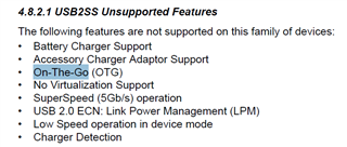

I found AM62x didn`t support OTG function as shown in TRM.
I`d like to know whether all of two USB didn`t support OTG?
BR
Cayden

Hello Cayden
Thank you for the query.
I assume you meant USB0 and USB1. This is correct. Both USBs do not support OTG.

Hi Cayden,
BTW, could USB0 and USB1 support OTG if customer code driver files by themselves?
Do you really mean to the true OTG protocols? What is the USB usecase?
For more than a decade I haven't hear any customer using OTG protocols on any TI processor.
Hi Bin, Sreenivasa,
So sorry. I have confirmd with customer this morning. Customer requirements as following:
It operates in slave mode when there are no USB equipment inserted. When a U disk (or other USB equipment) is inserted, it automatically switches to master mode.
Could DRD mode achieve this function?
BR
Cayden
Hi Cayden,
Yes, this is supported. Please refer to the design of the USB0 port on SK-AM62B-P1 EVM.
