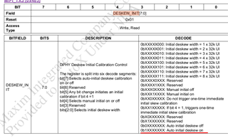

1920x1536 YUV422_8 * 2  ---> max96792A - - ->   CSI1
1.

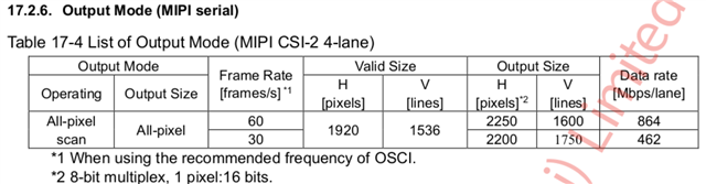

We now have 2 60fps cameras connected,The data_land of 60FPS is 864Mbps/lane.
max96792A deserializer rate set to: 1800 MHz
2.
When the image is set to
CSIRX_LANE_BAND_SPEED_1350_TO_1500_MBPS, the graph is working, but the camera is working at 30FPS.
When CSIRX_LANE_BAND_SPEED_1750_TO_2000_MBPS,
./run_app_multi_cam.sh gets stuck after running:
app_run_graph_for_one_pipeline: frame 1 beginning, pipeline:-2,line:1264
app_run_graph_for_one_pipeline: frame 2 beginning, pipeline:-1,line:1264
In order for two 60FPS cameras to work properly, what should our CSI rate be set to?

    2).
    According to the camera bandwidth requirements, the deserializer rate is set to 1800 MHz. When trying to set the CSI to any value greater than CSIRX_LANE_BAND_SPEED_1350_TO_1500_MBPS, it will get stuck after running: (CSIRX cannot get the data)
    log:
    When set to CSIRX_LANE_BAND_SPEED_1350_TO_1500_MBPS, the graph runs, and the frame rate is 60 accompanied by Frame Drop.
    We would like to ask the experts:
    1.What should be set to csi_laneBandSpeed?
    2. What is the cause of the Frame Drop problem? What needs to be done?
    Looking forward to your reply.
    Barry

  • Hi Brijesh,
    thank you for your reply.
    The DESKE description of each TX in the deserializer is: DESKEW_INIT[7:0] and DESKEW_PER[7:0]
    Whether we enable one of them or both, capture can only run when CSIRX_LANE_BAND_SPEED_1350_TO_1500_MBPS.
    1. Should we enable one of DESKEW_INIT and DESKEW_PER or both?
    2.What should be the value of csi_laneBandSpeed in image?
    Looking forward to experts’ help, thank you
    Barry
  • Hi Barry,
    Sorry i am not familiar with this deserializer, so can't help much in the deserializer configuration.
    From the CSIRX perspective, CSIRX does not support periodic de-skew calibration, so it needs to be available at init time and it is mandatory for the lane speed more than 1.5Gbps.
    Brijesh
