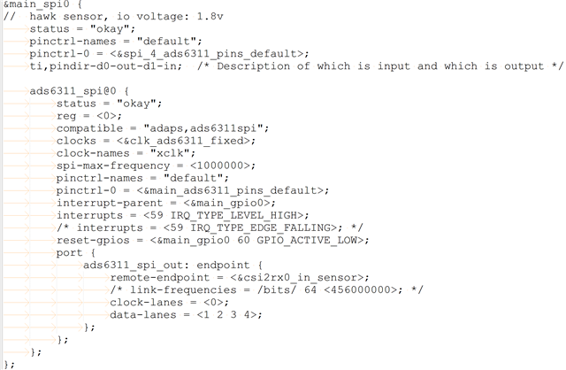

We are porting our dToF sensor to TI AM62ax SoC platform. We had porting this dToF sensor to rockchip rk3568 last year, It works well.   Recently we are porting it to Am62ax.  The Linux kernel version is 6.1.46.
We already modified dts and added ads6311.c as a camera sensor driver, we almost are done, except some errors as below:

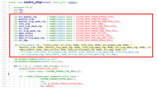

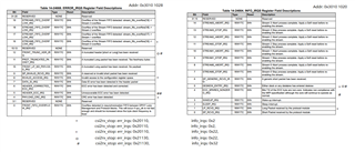

1. There is some errors in the log, it looks some DMA error are happening, but we don't know why so?
[ 138.058123] j721e-csi2rx 30102000.ticsi2rx: DMA transfer timed out for drain buffer
[ 138.065813] j721e-csi2rx 30102000.ticsi2rx: Failed to drain DMA. Next frame might be bogus
[ 138.178139] j721e-csi2rx 30102000.ticsi2rx: DMA transfer timed out for drain buffer
[ 138.185813] j721e-csi2rx 30102000.ticsi2rx: Failed to drain DMA. Next frame might be bogus
[ 138.298207] j721e-csi2rx 30102000.ticsi2rx: DMA transfer timed out for drain buffer
[ 138.305888] j721e-csi2rx 30102000.ticsi2rx: Failed to drain DMA. Next frame might be bogus
[ 138.394094] j721e-csi2rx 30102000.ticsi2rx: DMA transfer timed out for drain buffer
[ 138.401778] j721e-csi2rx 30102000.ticsi2rx: ti_csi2rx_cleanup_buffers: Failed: -110 to drain DMA. Next frame might be bogus
[ 138.466288] j721e-csi2rx 30102000.ticsi2rx: DMA transfer timed out for drain buffer
[ 138.473983] j721e-csi2rx 30102000.ticsi2rx: ti_csi2rx_cleanup_buffers: Failed: -110 to drain DMA. Next frame might be bogus

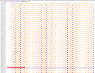

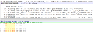

2. Some captured raw data files are incorrect according the MD5sum value.  BTW, I enabled TEST PATTERN output for our dToF sensor, the output raw data is fixed, with a fixed MD5 value, as I tested before on Rk3568.  As below, the highlighted files has incorrect MD5 value, while other files are correct.
root@am62axx-evm:~# md5sum /tmp/video*
6471076892740e3a2aab7206a01869c4 /tmp/video0_frame000_2688x192_1032192.depth_raw
6471076892740e3a2aab7206a01869c4 /tmp/video0_frame001_2688x192_1032192.depth_raw
6471076892740e3a2aab7206a01869c4 /tmp/video0_frame002_2688x192_1032192.depth_raw
6471076892740e3a2aab7206a01869c4 /tmp/video0_frame003_2688x192_1032192.depth_raw
6471076892740e3a2aab7206a01869c4 /tmp/video0_frame004_2688x192_1032192.depth_raw
6471076892740e3a2aab7206a01869c4 /tmp/video0_frame005_2688x192_1032192.depth_raw
6471076892740e3a2aab7206a01869c4 /tmp/video0_frame006_2688x192_1032192.depth_raw
6471076892740e3a2aab7206a01869c4 /tmp/video0_frame007_2688x192_1032192.depth_raw
6471076892740e3a2aab7206a01869c4 /tmp/video0_frame008_2688x192_1032192.depth_raw
6471076892740e3a2aab7206a01869c4 /tmp/video0_frame009_2688x192_1032192.depth_raw
6471076892740e3a2aab7206a01869c4 /tmp/video1_frame000_2688x192_1032192.depth_raw
47532ad8274f164da0c6e804f1e65223 /tmp/video1_frame001_2688x192_1032192.depth_raw
6471076892740e3a2aab7206a01869c4 /tmp/video1_frame002_2688x192_1032192.depth_raw
47532ad8274f164da0c6e804f1e65223 /tmp/video1_frame003_2688x192_1032192.depth_raw
6471076892740e3a2aab7206a01869c4 /tmp/video1_frame004_2688x192_1032192.depth_raw
47532ad8274f164da0c6e804f1e65223 /tmp/video1_frame005_2688x192_1032192.depth_raw
6471076892740e3a2aab7206a01869c4 /tmp/video1_frame006_2688x192_1032192.depth_raw
47532ad8274f164da0c6e804f1e65223 /tmp/video1_frame007_2688x192_1032192.depth_raw
6471076892740e3a2aab7206a01869c4 /tmp/video1_frame008_2688x192_1032192.depth_raw
47532ad8274f164da0c6e804f1e65223 /tmp/video1_frame009_2688x192_1032192.depth_raw

    [ 137.011017] <DRV_ADS6311> [2024-02-04 18:28:39.647.036.400] <N> 6797 ====================MCU Register Dump from <__sensor_start_stream> Line: 3558=====================
    [ 137.025960] <DRV_ADS6311> [2024-02-04 18:28:39.661.979.415] <N> 6806 ---------0----1----2----3----4----5----6----7----8----9----a----b----c----d----e----f
    [ 137.039777] <DRV_ADS6311> [2024-02-04 18:28:39.675.796.655] <N> 6829 0000: 0000 0000 0000 0000 0000 0000 0000 0000 0000 0000 0000 0000 0000 0000 0000 0000
    [ 137.053593] <DRV_ADS6311> [2024-02-04 18:28:39.689.612.555] <N> 6829 0010: 0000 0000 0000 0000 0000 0000 0000 0000 0000 0000 0000 0000 0000 0000 0000 0000
    [ 137.067411] <DRV_ADS6311> [2024-02-04 18:28:39.703.430.750] <N> 6829 0020: 0000 0000 0000 0000 0000 0000 0000 0000 0000 0000 0000 0000 0000 0000 0000 0000
    [ 137.081231] <DRV_ADS6311> [2024-02-04 18:28:39.717.250.545] <N> 6829 0030: 0000 0000 0000 0000 0000 0000 0000 0000 0000 0000 0000 0000 0000 0000 0000 0000
    [ 137.095049] <DRV_ADS6311> [2024-02-04 18:28:39.731.068.910] <N> 6829 0040: 0000 0000 0000 0000 0000 0000 0000 0000 0000 0000 0000 0000 0000 0000 0000 0000
    [ 137.108871] <DRV_ADS6311> [2024-02-04 18:28:39.744.890.150] <N> 6829 0050: 0000 0000 0000 0000 0000 0000 0000 0000 0000 0000 0000 0000 0000 0000 0000 0000
    [ 137.122687] <DRV_ADS6311> [2024-02-04 18:28:39.758.705.830] <N> 6829 0060: 0000 0000 0000 0000 0000 0000 0000 0000 0000 0000 0000 0000 0000 0000 0000 0000
    [ 137.136503] <DRV_ADS6311> [2024-02-04 18:28:39.772.522.645] <N> 6829 0070: 0000 0000 0000 0000 0000 0000 0000 0000 0000 0000 0000 0000 0000 0000 0000 0000
    [ 137.150319] <DRV_ADS6311> [2024-02-04 18:28:39.786.338.935] <N> 6829 0080: 0000 0000 0000 0000 0000 0000 0000 0000 0000 0000 0000 0000 0000 0000 0000 0000
    [ 137.164134] <DRV_ADS6311> [2024-02-04 18:28:39.800.153.240] <N> 6829 0090: 0000 0000 0000 0000 0000 0000 0000 0000 0000 0000 0000 0000 0000 0000 0000 0000
    [ 137.177949] <DRV_ADS6311> [2024-02-04 18:28:39.813.968.615] <N> 6829 00a0: 0000 0000 0000 0000 0000 0000 0000 0000 0000 0000 0000 0000 0000 0000 0000 0000
    [ 137.191767] <DRV_ADS6311> [2024-02-04 18:28:39.827.786.155] <N> 6829 00b0: 0000 0000 0000 0000 0000 0000 0000 0000 0000 0000 0000 0000 0000 0000 0000 0000
    [ 137.205586] <DRV_ADS6311> [2024-02-04 18:28:39.841.605.965] <N> 6829 00c0: 0000 0000 0000 0000 0000 0000 0000 0000 0000 0000 0000 0000 0000 0000 0000 0000
    [ 137.219403] <DRV_ADS6311> [2024-02-04 18:28:39.855.422.720] <N> 6829 00d0: 0000 0000 0000 0000 0000 0000 0000 0000 0000 0000 0000 0000 0000 0000 0000 0000
    [ 137.233227] <DRV_ADS6311> [2024-02-04 18:28:39.869.245.750] <N> 6829 00e0: 0000 0000 0000 0000 0000 0000 0000 0000 0000 0000 0000 0000 0000 0000 0000 0000
    [ 137.247044] <DRV_ADS6311> [2024-02-04 18:28:39.883.063.490] <N> 6829 00f0: 0000 0000 0000 0000 0000 0000 0000 0000 0000 0000 0000 0000 0000 0000 0000 0000
    [ 137.260853] <DRV_ADS6311> [2024-02-04 18:28:39.896.872.240] <N> 6834 =====================================================================================

    [ 138.521007] --HAWK--<v4l2_subdev_disable_streams_fallback> Line: 1948--s_stream(0)-owner:, v4l2_subdev_name:m00_dToF_ads6311 spi1.0, ret:0---
    [ 138.533786] cdns-csi2rx 30101000.csi-bridge: csi2rx_stop: 4, cur stream: 0, ctrl reg addr: 0x9b7e100, value: 0x2, status reg addr: 0x9b7e104, value: 0x0.
    [ 138.547573] cdns-csi2rx 30101000.csi-bridge: csi2rx_stop: 4, cur stream: 1, ctrl reg addr: 0x9b7e200, value: 0x0, status reg addr: 0x9b7e204, value: 0x0.
    [ 138.561318] cdns-csi2rx 30101000.csi-bridge: csi2rx_stop: 4, cur stream: 2, ctrl reg addr: 0x9b7e300, value: 0x2, status reg addr: 0x9b7e304, value: 0x0.
    [ 138.575125] cdns-csi2rx 30101000.csi-bridge: csi2rx_stop: 4, cur stream: 3, ctrl reg addr: 0x9b7e400, value: 0x2, status reg addr: 0x9b7e404, value: 0x0.
    [ 138.588913] cdns-csi2rx 30101000.csi-bridge: csi2rx_stop: dphy lane ctrl reg addr: 0x9b7e040, value: 0x0.
    [ 138.598534] cdns-csi2rx 30101000.csi-bridge: csi2rx_disable_streams: cdns_csi2rx.30101000.csi-bridge.

    root@am62axx-evm:~# cat hawk_concurrency_test4.log
    Hawk concurrency test util
    Version: 1.0.0_LM20240306a
    Build Time: Mar 8 2024,07:43:50
    [2024-02-04 18:28:38.072.221.960] INFO: <hawk_concurrency_test.cpp-Hawk_Concurrency_Test() 112> input work_mode: 2
    [2024-02-04 18:28:38.072.320.800] INFO: <hawk_concurrency_test.cpp-Hawk_Concurrency_Test() 113> input test_case: 0
    [2024-02-04 18:28:38.072.347.530] INFO: <hawk_concurrency_test.cpp-Hawk_Concurrency_Test() 114> input dumpframe: 10
    [2024-02-04 18:28:38.072.371.400] INFO: <hawk_concurrency_test.cpp-Hawk_Concurrency_Test() 115> test_stream_cnt: 4
    [2024-02-04 18:28:38.072.403.665] INFO: <v4l2_dev.cpp-V4l2_Dev() 32> video_dev: /dev/video0
    [2024-02-04 18:28:38.072.428.170] INFO: <v4l2_dev.cpp-V4l2_Dev() 33> preset width: 2688
    [2024-02-04 18:28:38.072.454.650] INFO: <v4l2_dev.cpp-V4l2_Dev() 34> preset height: 192
    [2024-02-04 18:28:38.072.478.840] INFO: <v4l2_dev.cpp-V4l2_Dev() 35> preset pixel_format: 0x32314742
    [2024-02-04 18:28:38.072.502.455] INFO: <v4l2_dev.cpp-V4l2_Dev() 36> preset frame_buffer_count: 6
    [2024-02-04 18:28:38.072.524.960] INFO: <v4l2_dev.cpp-V4l2_Dev() 37> preset sensor_type: 0
    [2024-02-04 18:28:38.072.578.075] INFO: <hawk_stream.cpp-Initialize() 38> m_v4l2_snr_sd: 0x274292f0, raw_width:2688, raw_height:192...
    [2024-02-04 18:28:38.072.641.120] INFO: <v4l2_sensor_subdev.cpp-get_subdev_node_4_sensor() 71> searching sensor m00_dToF_ads6311 spi1.0...
    [2024-02-04 18:28:38.072.666.635] INFO: <v4l2_sensor_subdev.cpp-get_subdev_node_4_sensor() 72> enum entities...
    [2024-02-04 18:28:38.072.689.180] INFO: <v4l2_sensor_subdev.cpp-get_subdev_node_4_sensor() 73> major:minor id entity_name device node
    [2024-02-04 18:28:38.072.712.350] INFO: <v4l2_sensor_subdev.cpp-get_subdev_node_4_sensor() 74> -------------------------------------------------------
    [2024-02-04 18:28:38.072.821.465] INFO: <v4l2_sensor_subdev.cpp-get_subdev_node_4_sensor() 88> 81: 6 1 30102000.ticsi2rx /dev/v4l-subdev0
    [2024-02-04 18:28:38.072.885.215] INFO: <v4l2_sensor_subdev.cpp-get_subdev_node_4_sensor() 88> 81: 7 9 cdns_csi2rx.30101000.csi-bridge /dev/v4l-subdev1
    [2024-02-04 18:28:38.072.945.920] INFO: <v4l2_sensor_subdev.cpp-get_subdev_node_4_sensor() 88> 81: 8 15 m00_dToF_ads6311 spi1.0 /dev/v4l-subdev2
    [2024-02-04 18:28:38.072.971.995] INFO: <v4l2_sensor_subdev.cpp-get_subdev_node_4_sensor() 93> sd_devnode_4_dtof: /dev/v4l-subdev2
    [2024-02-04 18:28:38.190.485.040] INFO: <v4l2_sensor_subdev.cpp-Set_param_4_sensor_sub_device() 112> --VIDIOC_SUBDEV_S_FMT--fd_4_dtof:4, sd_devnode_4_dtof:/dev/v4l-subdev2, width:2688, height:192
    [2024-02-04 18:28:38.261.916.485] INFO: <v4l2_sensor_subdev.cpp-Set_param_4_sensor_sub_device() 115> --VIDIOC_SUBDEV_S_FMT--ret: 0, fd_4_dtof:4, sd_devnode_4_dtof:/dev/v4l-subdev2, width:2688, height:192
    [2024-02-04 18:28:38.261.951.585] INFO: <hawk_stream.cpp-Initialize() 50> result: 0, raw_width:2688, raw_height:192...
    [2024-02-04 18:28:38.262.028.215] INFO: <v4l2_dev.cpp-Initialize() 252> driver: j721e-csi2rx
    [2024-02-04 18:28:38.262.047.755] INFO: <v4l2_dev.cpp-Initialize() 253> card: j721e-csi2rx
    [2024-02-04 18:28:38.262.067.300] INFO: <v4l2_dev.cpp-Initialize() 254> bus_info: platform:30102000.ticsi2rx
    [2024-02-04 18:28:38.262.083.070] INFO: <v4l2_dev.cpp-Initialize() 255> version: 0x6012e
    [2024-02-04 18:28:38.262.097.680] INFO: <v4l2_dev.cpp-Initialize() 256> capabilities: 0xa4200001

  • Hi David,
    Can you share the changes you made to dts?
    The "Failed to drain DMA" error was likely caused by your user application not queueing buffers quickly enough for the CSI Rx driver.
    Jianzhong
  • Hi JIanzhong,
        I have reviewed my changes for dts, I added a new file named k3-am62a7-sk-csi2-ads6311.dtso (Of course, I also modified uEnv.txt for u-boot to load k3-am62a7-sk-csi2-ads6311.dtbo), the content is as below:
    On the other hand, we also modified k3-am62a7-sk.dts, but most changes is for pinmux configure. I will post my copy next reply.

  • Hi Jianzhong,
       The last reply is my k3-am62a7-sk.dts. Thanks
  • Hi David,
    Looks like you reduced the size of edgeai_shared_region and edgeai_core_heaps:
            edgeai_shared_region: edgeai_shared-memories {
                compatible = "dma-heap-carveout";
                reg = <0x00 0xa3000000 0x00 0x00100000>;
            edgeai_core_heaps: edgeai-core-heap-memory@a3100000 {
                compatible = "shared-dma-pool";
                reg = <0x00 0xa3100000 0x00 0x02400000>;
                no-map;
    Are you using these memories in your application?
    What does "hawk_concurrency_test" do?

    2. Some captured raw data files are incorrect according the MD5sum value.  BTW, I enabled TEST PATTERN output for our dToF sensor, the output raw data should be fixed, with a fixed MD5 value, as I tested before on Rk3568.  As below, the highlighted files has incorrect MD5 value, while other files are correct.
    3. It looks some ecc/crc error are happening from the status registers, we added some code at the begin of csi2rx_stop() of drivers\media\platform\cadence\cdns-csi2rx.c, is this a correct location for printing these status? I tested many times, some err_irqs is as below, according to my search result for keyword "err_irqs".

    9. Split the raw file to 10 parts:
        CMD:
        c:\work\tools\split_binary_file.py 2688x192_SBGGR12_1X12_VC0.raw12 10
        c:\work\tools\split_binary_file.py 2688x192_SBGGR12_1X12_VC1.raw12 10
    10. check the md5sum values for every parts:
    $ md5sum 2688x192_SBGGR12_1X12_VC0.raw12_part*
    5e946032e9053ffd742c618718fb2808 *2688x192_SBGGR12_1X12_VC0.raw12_part1
    6471076892740e3a2aab7206a01869c4 *2688x192_SBGGR12_1X12_VC0.raw12_part10
    6471076892740e3a2aab7206a01869c4 *2688x192_SBGGR12_1X12_VC0.raw12_part2
    5e946032e9053ffd742c618718fb2808 *2688x192_SBGGR12_1X12_VC0.raw12_part3
    6471076892740e3a2aab7206a01869c4 *2688x192_SBGGR12_1X12_VC0.raw12_part4
    5e946032e9053ffd742c618718fb2808 *2688x192_SBGGR12_1X12_VC0.raw12_part5
    6471076892740e3a2aab7206a01869c4 *2688x192_SBGGR12_1X12_VC0.raw12_part6
    6471076892740e3a2aab7206a01869c4 *2688x192_SBGGR12_1X12_VC0.raw12_part7
    6471076892740e3a2aab7206a01869c4 *2688x192_SBGGR12_1X12_VC0.raw12_part8
    6471076892740e3a2aab7206a01869c4 *2688x192_SBGGR12_1X12_VC0.raw12_part9
    $ md5sum 2688x192_SBGGR12_1X12_VC1.raw12_part*
    6471076892740e3a2aab7206a01869c4 *2688x192_SBGGR12_1X12_VC1.raw12_part1
    6471076892740e3a2aab7206a01869c4 *2688x192_SBGGR12_1X12_VC1.raw12_part10
    6471076892740e3a2aab7206a01869c4 *2688x192_SBGGR12_1X12_VC1.raw12_part2
    6471076892740e3a2aab7206a01869c4 *2688x192_SBGGR12_1X12_VC1.raw12_part3
    6471076892740e3a2aab7206a01869c4 *2688x192_SBGGR12_1X12_VC1.raw12_part4
    6471076892740e3a2aab7206a01869c4 *2688x192_SBGGR12_1X12_VC1.raw12_part5
    6471076892740e3a2aab7206a01869c4 *2688x192_SBGGR12_1X12_VC1.raw12_part6
    6471076892740e3a2aab7206a01869c4 *2688x192_SBGGR12_1X12_VC1.raw12_part7
    6471076892740e3a2aab7206a01869c4 *2688x192_SBGGR12_1X12_VC1.raw12_part8
    6471076892740e3a2aab7206a01869c4 *2688x192_SBGGR12_1X12_VC1.raw12_part9
    Conclusion:
       As you can see, some raw files has incorrect md5sum value even if I used v4l2-ctl utils instead of my hawk_concurrency_test App.

       Today I paid more attention to mipi status, I tested many times, found it seems crc error always are there, but most time the raw data is correct. Please see my summaried result as below:
    David

    3. CRC error, this is cadence IP status register. cadence IP hardware receive error. May related the steam on one by one, need combine the stream use below command:

  • Hi Biao and Jianzhong,
    2. for the md5 sum error:
    media-ctl -d /dev/media0 -R "'30102000.ticsi2rx' [0/0 -> 2/0 [1], 0/1 -> 3/0 [1], 0/2 -> 4/0 [1], 0/3 -> 5/0 [1]]"
     I tried this with the following steps, but the captured result still has mismatched md5 value. So I think it doesn't help.
    1. Insmod our dToF sensor driver,
         CMD: insmod ads6311.ko;
    2. Open some run-time switches of ads6311.c driver to enable TEST PATTERN to output the fixed raw data, and enable more debug log;
        CMD: echo 0x142a > /sys/kernel/debug/adaps/dbg_ctrl
    3. open some run-time switches of v4l2 devices and subdevices
        CMD:
         echo 0xff > /sys/class/video4linux/video0/dev_debug
         echo 0xff > /sys/class/video4linux/video1/dev_debug
         echo 0xff > /sys/class/video4linux/video2/dev_debug
         echo 0xff > /sys/class/video4linux/video3/dev_debug
         echo 0xff > /sys/class/video4linux/v4l-subdev0/dev_debug
         echo 0xff > /sys/class/video4linux/v4l-subdev1/dev_debug
         echo 0xff > /sys/class/video4linux/v4l-subdev2/dev_debug
    4. set v4l2 routing for cdns_csi2rx.30101000.csi-bridge and 30102000.ticsi2rx:
       CMD:
       media-ctl -d /dev/media0 -R "'cdns_csi2rx.30101000.csi-bridge' [0/0 -> 1/0 [1], 0/1 -> 1/1 [1], 0/2 -> 1/2 [1], 0/3 -> 1/3 [1]]"
    5. set format for dToF sensor sub device (whose driver is Ads6311.c)
        CMD:
        media-ctl -d /dev/media0 --set-v4l2 '"m00_dToF_ads6311 spi1.0":0/0 [fmt:SBGGR12_1X12/2688x192]'
        media-ctl -d /dev/media0 --set-v4l2 '"m00_dToF_ads6311 spi1.0":0/1 [fmt:SBGGR12_1X12/2688x192]'
        media-ctl -d /dev/media0 --set-v4l2 '"m00_dToF_ads6311 spi1.0":0/2 [fmt:SBGGR8_1X8/40x1]'
        media-ctl -d /dev/media0 --set-v4l2 '"m00_dToF_ads6311 spi1.0":0/3 [fmt:SBGGR8_1X8/40x1]'
    6. start up stream 0---3 step by step, and capture 10 frames for every stream, and save to files (/tmp)
        CMD:
         v4l2-ctl --verbose -d /dev/video1 --set-fmt-video=width=2688,height=192,pixelformat='BG12' --stream-mmap=6 --stream-skip=1 --stream-to=/tmp/2688x192_SBGGR12_1X12_VC0.raw12 --stream-count=10 --stream-poll > v4l2_ctl_v0.log 2>v4l2_ctl_v0_error.log
         v4l2-ctl --verbose -d /dev/video2 --set-fmt-video=width=2688,height=192,pixelformat='BG12' --stream-mmap=6 --stream-skip=1 --stream-to=/tmp/2688x192_SBGGR12_1X12_VC1.raw12 --stream-count=10 --stream-poll >> v4l2_ctl_v1.log 2>>v4l2_ctl_v1_error.log
         v4l2-ctl --verbose -d /dev/video3 --set-fmt-video=width=40,height=1,pixelformat='BA81' --stream-mmap=6 --stream-skip=1 --stream-to=/tmp/40x1_SBGGR8_1X8_VC0.raw8 --stream-count=10 --stream-poll >> v4l2_ctl_v0.log 2>>v4l2_ctl_v0_error.log
         v4l2-ctl --verbose -d /dev/video4 --set-fmt-video=width=40,height=1,pixelformat='BA81' --stream-mmap=6 --stream-skip=1 --stream-to=/tmp/40x1_SBGGR8_1X8_VC1.raw8 --stream-count=10 --stream-poll >> v4l2_ctl_v1.log 2>>v4l2_ctl_v1_error.log
    7. view and check the md5 value for raw files (For v4l2-ctl, 10-frames raw data is saved to the same file for every stream)
       CMD:
       /tmp/2688*     // this will output as below,  the md5sum looks correct this time.
    4f1de82b9fc1ac88ee059f06b95153e0 /tmp/2688x192_SBGGR12_1X12_VC0.raw12
    4f1de82b9fc1ac88ee059f06b95153e0 /tmp/2688x192_SBGGR12_1X12_VC1.raw12
    8. remove the captured raw files: (To try once more)
       CMD:
       rm /tmp/*.raw12
       rm /tmp/*.raw8
    9. Repeat step 6 once more.
    10. view and check the md5 value for raw files again
        CMD:
         md5sum /tmp/2688*    // it will output as below:
    d41d8cd98f00b204e9800998ecf8427e /tmp/2688x192_SBGGR12_1X12_VC0.raw12
    c69e3dd8c33b0a6c48f1b07df861562f /tmp/2688x192_SBGGR12_1X12_VC1.raw12
        These 2 .raw12 file has incorrect md5sum value.
       Please check the detailed steps and log from he attched log file.MobaXterm_TI_SoC_Uart_20240313_141046.txt

  • It looks some ecc/crc error are happening from the status registers, we added some code at the begin of csi2rx_stop() of drivers\media\platform\cadence\cdns-csi2rx.c, is this a correct location for printing these status? I tested many times, some err_irqs is as below, according to my search result for keyword "err_irqs".
    Hi Jai,
       Would you please help to double confirm: at the begin of csi2rx_stop() of drivers\media\platform\cadence\cdns-csi2rx.c, is this a correct location for printing these status? (According to my work experience on qualcomm and rockchip platform, these status ususally are checked at the begin of some IRQ handle function.) On the current platform, It seems I always (90%) see there are some error for bit4-7 of CSI2RX_DPHY_ERROR_IRQS, but most time, the raw data is correct, only < 30% chance the raw data has error.
    Thanks and Best Regards,

    Regarding the link frequency question as mentioned by Biao,
    4. Link frequency can check in TRM, need Jianzhong and Jai help point out the specific register.
    The related register is the DPHY_BAND_CFG register: https://git.ti.com/cgit/ti-linux-kernel/ti-linux-kernel/tree/drivers/phy/cadence/cdns-dphy-rx.c?h=ti-linux-6.1.y#n195.
    You can add some print-outs in function cdns_dphy_rx_configure() to print hs_clk_rate, band_ctrl, etc to see if the link frequency is configured correctly.
    You can also print out the calculated link frequency from here: https://git.ti.com/cgit/ti-linux-kernel/ti-linux-kernel/tree/drivers/media/platform/cadence/cdns-csi2rx.c?h=ti-linux-6.1.y#n276.
    In the dts file k3-am62a7-sk-csi2-ads6311.dtso which you shared earlier, the link-frequency is not set. In that case, the driver will use the pixel rate to calculate the link frequency: https://git.ti.com/cgit/ti-linux-kernel/ti-linux-kernel/tree/drivers/media/v4l2-core/v4l2-common.c?h=ti-linux-6.1.y#n450.
    Jianzhong

  • I converted the wrong raw file to C array .h file, we can see the error happen since 512(may be a different position) bytes, all are 0x00

    I just tried to use v4l2-ctl utils, reproduced the issue too.
    I used a simple script as below, the command line is: ./looptest3.sh 50, The script try to capture 1 frame every time, and repeat 50 times.
    ---------------------------looptest3.sh file--------------------
    insmod ads6311.ko
    if [ -n "$1" ]; then
          times=$1
       else
          times=1
    fi
    for (( i=1; i <= $times; i++ ))
    do
        echo
        echo "-----TEST TIMES: $i/$times------"
        v4l2-ctl --verbose -d /dev/video0 --set-fmt-video=width=2688,height=192,pixelformat='BG12' --stream-mmap=6 --stream-skip=1 --stream-to=/tmp/2688x192_SBGGR12_1X12_VC0.raw12 --stream-count=1 --stream-poll > v4l2_ctl_video0.log 2>v4l2_ctl_video0_error.log
        md5sum /tmp/2688x192_SBGGR12_1X12_VC0.raw12
        rm /tmp/2688x192_SBGGR12_1X12_VC0.raw12
    done
    echo "-----------$times times test done, please check the log file for result-----------"
    please see the output log as attached file: MobaXterm_TI_SoC_Uart_20240314_111049_NoMultipleStream_md5_mismatched_by_v4l2-ctl.txt

       I converted these raw file to C array .h file, they looks there is same error, only the first 512 byte is correct, the remaining part are 0x00, same as I mentioned before.

    Q3: Would you please help to double confirm: at the begin of csi2rx_stop() of drivers\media\platform\cadence\cdns-csi2rx.c, is this a correct location for printing these status? (According to my work experience on qualcomm and rockchip platform, these status ususally are checked at the begin of some IRQ handle function.) On the current platform, It seems I always (90%) see there are some error for bit4-7 of CSI2RX_DPHY_ERROR_IRQS, but most time, the raw data is correct, only < 30% chance the raw data has error. Currently, the irq_status seems mismatch the correct/wrong of raw data, so the irq status seems not believeable, so I have the question, hope to have a better location to print the status.

    > so totally captured 5000 frames, there are 3 frames raw data mismatch.
    Is my understanding correct that with the modification the errors are still present, but they reduced a lot - so you now only see 3/5000 frames with checksum mismatch?
    The best location for this would be in irq handlers for the various irqs described for the CSI RX INTD module. But currently driver support is not there for those. This is described in TRM under "CSI_RX_IF Interrupt Events" section.
    It would be simpler in my opinion to check the registers directly from userspace, while stream is running. This can be done using devmem2 or similar tools that map the physical memory through /dev/mem device.

  • Is my understanding correct that with the modification the errors are still present, but they reduced a lot - so you now only see 3/5000 frames with checksum mismatch?
    I think I can't say it is reduced a lot now.
    Given it is always happening at 512 bytes, I am not sure if a random short frame (3) will cause that.
    Have you tested same sensor and driver on some other (non AM62A) platform? Does this 512-byte issue happen on any other platform?
    The 512 bytes should NOT be a short frame, since they are matched with our test pattern data when test pattern is enabled.
    We applied the sensor on rk3568 for almost a year. Recently I tested my driver code and test application ('hawk_concurency_test') on rk3568 platform to double confirm it is okay or not many times, it works well, without raw data (md5) mismatch issue.

        if [ "$ACTUAL_MD5" == "$EXPECTED_MD5" ]; then
            echo "MD5 matched. Deleting $TMP_FILE..."
            rm -f "$TMP_FILE"
        else
            echo "MD5 did not match. File will be kept, test exiting..."
            break;
        fi

  • Hi Jai,
        The 2nd status update on Mar, 19:
        1. I modified the code of drivers\media\common\videobuf2\videobuf2-v4l2.c as below to view the the parameters for VIDIOC_REQBUFS.
        Then I tested it with with the same .ko drivers with gst-launch-1.0 and v4l2-ctl utils, I saw the following output as below. The first 5 lines is for with gst-launch-1.0, which has no MD5 mismatch issue, while last 2 lines is for with v4l2-ctl, which has some MD5 mismatch issue.
       I don't know why there are 3 requests with count = 0 and memory = 1/2/4 at the begin for gst-launch-1.0?  Is it to try to clear some buffers?  For with v4l2-ctl, there is no such request, I don't know is this is a questionable point?
       2. After I applied your two patches for any DMA error is printed on the console, I tested with the same .ko drivers, when I tested with v4l2-ctl, there is some DMA transfer errors are reported, while no such error with gst-launch-1.0.
    Please see the the attached log file for details.

    [   60.933717] --HAWK--<v4l2_subdev_disable_streams_fallback> Line: 1943--s_stream(0)-owner:, v4l2_subdev_name:m00_dToF_ads6311 spi1.0, ret:0---
    [   60.946491] cdns-csi2rx 30101000.csi-bridge: csi2rx_stop: err_irqs: 0x20100, info_irqs: 0x22, err_bypass_cfg: 0x0, monitor_irqs: 0x0, monitor_irqs_mask_cfg: 0x0, info_irqs_mask_cfg: 0x0, err_irqs_mask_cfg: 0x0,
    [   60.946491] dphy_status: 0x222206, dphy_errirq: 0x0, dphy_errirq_mask_cfg: 0x0, err_dbg: 0x0.
    [   61.030512] j721e-csi2rx 30102000.ticsi2rx: DMA transfer timed out for drain buffer

    [  136.786296] cdns-csi2rx 30101000.csi-bridge: csi2rx_stop: err_irqs: 0x20100, info_irqs: 0x22, err_bypass_cfg: 0x0, monitor_irqs: 0x0, monitor_irqs_mask_cfg: 0x0, info_irqs_mask_cfg: 0x0, err_irqs_mask_cfg: 0x0,
    [  136.786296] dphy_status: 0x222206, dphy_errirq: 0x0, dphy_errirq_mask_cfg: 0x0, err_dbg: 0x0.

    File /tmp/v4l2ctl_SBGGR12_1X12_one_stream_1651401092_Test2.raw12 MD5: 5e946032e9053ffd742c618718fb2808
    -----------2/10 times test done, please check the log file for result-----------
