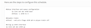

    'ethtool -L eth3 tx 3', there is an error,'netlink error: Device or resource busy'. We can see with 'ethtool -l eth3' that the TX in the current hardware settings is 1.
    You have to make ntelink down before changing the no.of Queues, using "#ifconfig eth3 down" command, so that device will be idle.
    After bringing the interface down, change the no.of Tx Queues and make ntelink up i.e. bring interface up using "ifconfig eth3 up" command.
    The same above sequence is mentioned in SDK Documentation also, as captured in below. (but below uses "ip link" commands instead of "ifconfig")

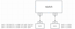

    The network topology diagram is as follows. The tda4vh is switch mode.

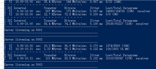

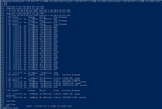

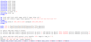

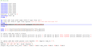

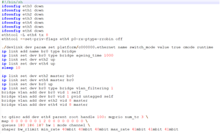

    I still have some questions about CBS. Here is a description of my test environment. The eth2 of the sender TDA4vh is connected to the eth2 of the switch TDA4vh and the eth4 of the switch TDA4vh is connected to the eth1 of the receiver TDA4vm.
    The commond in the sender TDA4vh:
    The command in the switch TDA4vh:
    The command in the receiver TDA4vm:
    I didn't set the vlan id because it was already set on tda4vm. Testing with iperf3 on sender tda4vh:
    The test result:
    The probability of packet loss  for the pri6 is 18%. The probability of packet loss for this vlan 4 is 18%, compared to 10% on the official documentation(3.2.2.10.3.3.2.3. CBS — Processor SDK Linux for J784s4 Documentation). Either 18% or 10% is a bit high in my opinion. I checked CBS in the INET(Credit-Based Shaping — INET 4.5.0 documentation (omnetpp.org)). If at some point in time the credit value is negative, these packets should be saved in the queue. The packet loss probability shouldn't be so high.
    Best Regard,
    Lei

    I set all the config speed limits to 40MB and left the rest of the configs unchanged. The configuration script is as follows.
    The sender TDA4VH:
    The switch TDA4VH:
    The recevier TDA4VM:
    The iperf3 commond in the sender tda4vh:
    The test result:
    The test statistics:

    If the sender's speed is 39M, then there are no packet loss. However, if the speed exceeds 40M, the packet loss rate increases dramatically.
    Lei
    Any progress? If so, please let me know.
    Lei
    Can you please check by reducing the priority6 traffic also to 100Mbps and check if the drop percentage is still high or not?
    I have tested it as per your method. This vlan6 with the highest packet loss rate is still there.
    Lei
  • Hi Lei,
    This would be true in general.
    When going through switch the data will go through 4 FIFOs. In general, FIFO do not have a clean behavior while dropping packets and there are jitters expected for the same. When this happens 4 times the drop rates for the traffic can increase significantly.
    Using CBS, you can guarantee that the traffic on a priority won't exceed the limit set. So as long as you have bandwidth less than that, there is no issue. When you have sustained traffic exceeding the limit on that priority, the drop in bandwidth would depend on a lot of hardware factors and will be significantly less than the programmed values.
    This can be controlled to an extent using flow control and priority based flow control. But in all the cases, you would see significant drops when you exceed limits.
    Tanmay
