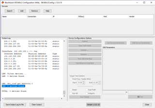

  • I run "Blackhawk XDS560v2 Configuration Utility" with the device plug in. the utility can not detect the device:
    the device usb led is always red. and the mode led is always blinking green. looks like it never finish the booting. So it did not enter safe mode or other mode.
    My computer (in control panel) can not detect the device neither.
