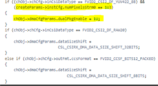

2.But after I add the patch:  e2e.ti.com/.../faq-processor-sdk-j721e-how-to-enable-multiple-displays-by-sending-bigger-size-frames-from-dss
the frame rate will only be 30FPS. What is the reason? How should we solve this problem?

  • Hi Brijesh,
    Why will the camera frame rate change from 60 to 30FPS after adding the patch?
    We must create two cameras as a superframe input to DSS for DSI output so that splitter display can be performed in DSI->serdes.
    How should we modify this patch now so as not to affect the 60FPS frame rate?
    Can you help us send the relevant patch? Thanks.

    Which SDK release are you using? Have you tried changing numPIxels parameter in the CSIRX to 1?

    The result of numPIxels value 0/1 is 30FPS, which does not change the problem.

  • Why will the camera frame rate change from 60 to 30FPS after adding the patch?
    One question, is the graph running fine without this patch? Lets say if there is no display in the graph, does it capture at 60fps?
    Also i see you are using two CSIRX instances, are both the instances managed by single instance of CSIRX capture node?
    Brijesh
  • Hi Brijesh,
    Thanks Reply.
    As I mentioned repeatedly upstairs, without adding this patch, the frame rate can reach 60.
    Our CSI0 is not connected to the camera, but CSI1 is connected to two 60FPS cameras.
    Barry
  • Hi Barry,
    Strange, this patch just enables a second pipeline to display second camera input and most likely both the display pipelines are connected to the same display, so there should not be any delay in display. This should not be due to display. This is why i was asking to check if it works without this patch? Even if this is due to display, increasing number of buffers should have helps, because then there is enough margin for the delay due to display.
    I feel the issue is due to something else.
    Can you try increasing numPIxels to 1 in the capture node? You might require changes that i suggested in below link.
    https://e2e.ti.com/support/processors-group/processors/f/processors-forum/1260910/tda4vh-q1-can-csi-rx-module-handle-two-4k-cameras-at-yuv422-8bit-30-fps
    Brijesh
  • Hi Brijesh,
    Thanks for reply.
    I reviewed the SDK8.6 I am currently using, and it is the same as the patch code you mentioned.
    Try to modify The result of numPIxels value 0/1 are both 30FPS, which does not change the problem.
    This is app_multi_cam/main.c after we added the patch:
    packages/ti/drv/csirx/src/csirx_drvUdma.c:
    /*                          Function Definitions                              */

    Sorry, we don’t have an EVM camera, and the output method we verified is DSI, so we can’t verify it on the EVM board.
    DSI-SERDES-LCD
    Our final goal is to use serdes to split the superframe into two 1280*800 images that can be displayed independently.
    We set the DSI output timing to 2560*800 on the customer board, so we add this patch to make it output a superframe:https://e2e.ti.com/support/processors-group/processors/f/processors-forum/1107628/faq-processor-sdk-j721e-how-to-enable-multiple-displays-by-sending-bigger-size-frames-from-dss
    As mentioned repeatedly above, the fps dropped from 60 to 30 after adding the patch.
    In addition, if you switch to two 30 cameras, the output will still reach 30 after adding the patch, and it will not drop to 15.
