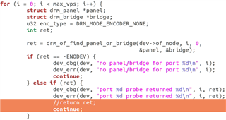

We make a customized TDA4VL board. In this board, we keep the DP0 port, and remove DP1 port, panel & bridge. Some code from SDK were modified but the DP0 port can't work in both Linux & RTOS SDK. Please help us find root cause.
Modify & test in Linux SDK 8.6.1.2:
Before:
got error message while running "modetest -M tidss -c":
root@j721s2-evm:/usr/bin# modetest -M tidss -c
failed to open device 'tidss': No such file or directory
Modify:
remove 4 nodes: dp1_pwr_3v3, panel, dsi0_ports:port@0, dsi_dep_bridge_ports from device tree (k3-j7821s2-common-proc-board.dts)
ignore the error when tidss driver try to find panels and bridges (because we don't have panels and bridges) (tidss_dispc_modeset_init() in tidss_kms.c)
After:
It show message while kernel booting:
[drm] Initalized tidss 1.0.0 20180215 for 4a00000.dss on minor 0
It still can't get connector id while running "modetest -M tidss -c"
It response some messages while running "modetest -M tidss -p" as log:
It response some error message while running "weston" as log:

root@j721s2-evm:~# dmesg|grep tidss
[    1.031210] tidss 4a00000.dss: port 0 probe returned -517
[    1.036611] tidss 4a00000.dss: no panel/bridge for port 1
[    1.042015] tidss 4a00000.dss: port 2 probe returned -517
[    1.047407] tidss 4a00000.dss: no panel/bridge for port 3
[    1.053434] [drm] Initialized tidss 1.0.0 20180215 for 4a00000.dss on minor 0
[    1.060567] tidss 4a00000.dss: tidss_probe  done
root@j721s2-evm:~#

Problems:
How do we confirm the DP0 and tidss driver are initialized correctly?

Problems:
What's the problem? And how do we fix it?
