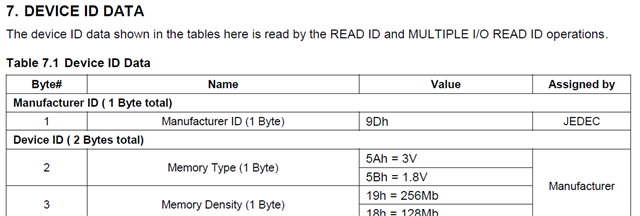

  • Hello Prashant Shivhare.
    Thank you for your reply.
    Regarding the custom board, the DDR is the same but the FLASH is different.
    FLASH has been changed from S28HS512T to IS25LX256.
    I configured FLASH using CCS's sysconfig.
    I am creating a new *.hs_fs.tiimage for sbl_uart_uniflash and sbl_null.

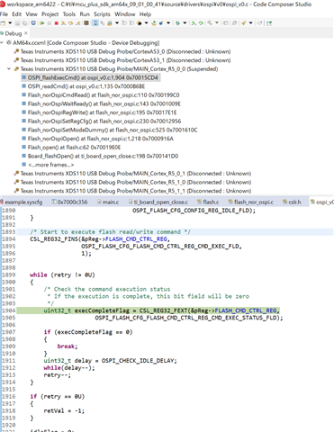

  • Hello Kiyomasa,
    From the address 0x7001F19E, it looks like the `sbl_uart_uniflash` images boots but gets stuck somewhere.
    The next step would be to load the symbols of sbl_uart_uniflash using:
    Run -> Load -> Load Symbols... -> Browse -> <MCU_PLUS_SDK_PATH>/examples/drivers/boot/sbl_uart_uniflash/am64x-evm/r5fss0-0_nortos/ti-arm-clang/sbl_uart_uniflash.debug.out
    This should tell you where the control is stuck in the code.
    Prashan
    It looks like below.
    Kiyomasa Imaizumi.
    When I step through with F5, it looks like below.
    Kiyomasa Imaizumi.
  • Hello Kiyomasa,
    It looks like the flash configurations may not be correct.
    If you continue the Step Through, does the control move forward in the code or just stuck there?
    Prashant
    I did a step through.
    The program seems to loop until timeOut reaches 0 using the code below for Flash_norOspiWaitReady.
        while((status != SystemP_SUCCESS) || (timeOut > 0))
            status = Flash_norOspiCmdRead(config, cmd, cmdAddr, numAddrBytes, dummyBits, readStatus, numBytesToRead);
            if((status == SystemP_SUCCESS) && ((readStatus[0] & bitMask) == 0))
                break;
            timeOut--;
    Kiyomasa Imaizumi.
    I made the diag output result into a json file and read it from sysconfig.
    The following error occurred.
    However,I made the FLASH settings one by one and created uart_uniflash.
    I ran sbl_uart_uniflash.py from the command prompt.
    When debugging with symbol loading, Board_driversOpen() returns -1.
    I think Flash_open is failing.
    Kiyomasa Imaizumi.
    I stopped just before Boad_driversOpen and debugged with symbol loading.
    I confirmed that the status becomes -1 in Flash_norOspiReadId(config) in the Flash_norOspiOpen function.
    Kiyomasa Imaizumi.
    additional information. I am debugging with symbol loading.
    The status will be -1 below.
    (flash_nor_ospi.c)
            if (!((manfID == config->attrs->manufacturerId) && (devID == config->attrs->deviceId)))
                /* Try the other 3 bytes */
                manfID = (uint32_t)idCode[3];
                devID = ((uint32_t)idCode[4] << 8) | ((uint32_t)idCode[5]);
                    status = SystemP_FAILURE;
    When I checked the parameters, manufacturingId was 52 and deviceId was 23322, but manfId was 0 and devID was 0.
    As a result, the status is SystemP_FAILURE.
    Maybe Flash_norOspiCmdRead is failing?
    But the function is returning 0.
    Kiyomasa Imaizumi.
    I made a mistake in the description.
    The following is correct.
    When I checked the parameters, manufacturingId was 0x9D and deviceId was 23065, but manfId was 0 and devID was 0.
    Kiyomasa Imaizumi.
  • Hello Kiyomasa,
    My question is: Have you checked if the IDs reported by `ospi_flash_diag` matches with the IDs mentioned in your flash datasheet?
    Also, can you share correct JSON output of the `ospi_flash_diag`. The previous JSON output is not formatted correctly.
    Prashant
  • Hello Preshant Shivhare
    Thank you for youre reply.
    I checked Manufacturer ID and Device ID from data sheet.
    These are correct.
    I attach JSON file.
    Kiyomasa Imaizumi.
    When I tried it next, it seems to be looping as below.
    When I step with F5, readStatus[0] becomes 0x05 or 0xFF.
    Kiyomasa Imaizumi.

    The problem status is the same as before the change.
    The program has the following loop.
    Kiyomasa Imaizumi.
  • Hello Kiyomasa,
    There is this change in the flash_nor_ospi.c for your flash part. Can you stop before Board_driversOpen and see if the control is executing the else part and the function Flash_norOspiSet8D_ISSI
    Prashant
    I tried debugging as you suggested.
    Flash_norOspiSet8D_ISSI is called as follows.
    The status is 0 after the function is called.
    Kiyomasa Imaizumi.

  • Hello Kiyomasa,
    It looks like the driver is incompatible with your custom flash part. Before diving deep into the driver, I want to make sure the flash configurations we are working with are correct.
    In that regards, I notice that the shared JSON output of ospi_flash_diag is different from the JSON file present in the SDK. May I know the exact steps you are following to run the ospi_flash_diag example?
    Prashant

    I attach the latest data obtained with ospi_flash_diag.
    Does this mean that this is wrong data (json)?
    	"flashSize": 33554432,
    	"flashPageSize": 256,
    	"flashManfId": "0x9D",
    	"flashDeviceId": "0x5A19",
    	"flashBlockSize": 131072,
