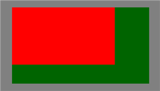

2、input image0   RGBA8888 1920*1080 Alpha=100
3、input image1   RGBA8888 2560*1440 Alpha=150
4、output image   RGBA8888 2560*1440
The output image appears to be just a simple overlay, without using alpha values to blend the two images. Please help answer this question. Thank you.

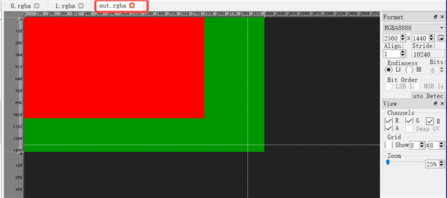

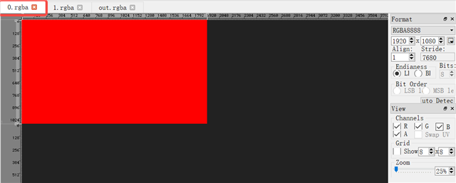

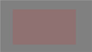

  • Hi,Brijesh;
    1、input image0 R=255 G=0 B=0 A=30
    2、input image1 R=0 G=255 B=0 A=100
    3、output image A=255
    After overlaying two semi transparent images, the Alpha value has changed to 255, which looks abnormal. I need the semi transparent effect after overlaying.
    Please help me solve this problem together, thank you.

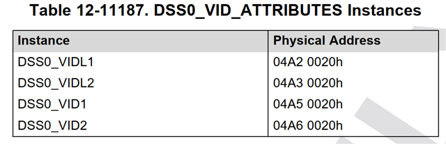

  • Hi xie jc,
    Are you sure that tiovx is rebuild and changes are in?
    Can you please read ATTRIBUTE register for both the channels and share the value of it?
    Brijesh
  • Hi,Brijesh;
    1、Are you sure that tiovx is rebuild and changes are in?
    >>>Yes,I am sure.
    2、Can you please read ATTRIBUTE register for both the channels and share the value of it?
    >>>As shown below
    dss register value
    0x04A20020 0x00000000
    0x04A30020 0x00000000
    0x04A50020 0x00080011
    0x04A60020 0x00080011
    thanks
