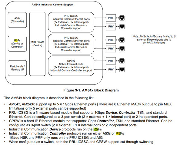

  • Hello Daolin,
    Can you explain why the SOC of am62x does not support Ethercat slave stations? We would like to know the specific reasons why it is not supported
  • Hi Li,
    The simplest answer/reason AM62x does not support EtherCAT subdevice functionality is due to EtherCAT subdevice protocol only being supported on R5F cores which AM62x does not have, additionally the pinmux done for SoC design was done in a way to only support controller functionality - it is not intended to support subdevice functionality by design. If you take a look at the following diagram from https://www.ti.com/lit/po/sprt769/sprt769.pdf, it states that
    • Industrial Communication Device protocols run on the R5Fs
    • Industrial Communication Controller protocols run on either A53s or R5Fs
    This is why AM62x can support EtherCAT controller/master functionality since it does have A53 cores. This is also why AM64x or AM243x is recommended for EtherCAT subdevices (since both have R5F cores).
    More depth explanation is that the software stack for an EtherCAT controller vs EtherCAT subdevice has different requirements:
    EtherCAT controllers can run on standard compliant Ethernet ports (such as CPSW standard ethernet which is the only ethernet AM62x supports).
    EtherCAT subdevices require special Ethernet hardware with real-time capabilities which is currently only offered from PRU_ICSSG ethernet which is especially designed as industrial comms ethernet.
    Another way I think of it is that the EtherCAT controller/master sends a frame to each subdevice and each subdevice needs to be able to "reads the data addressed to it 'on the fly' and inserts its data in the frame as the frame is moving downstream" and standard CPSW ethernet would just not be fast enough to do this.
    To reiterate, for the above reasons, AM62x would not be suitable if you are looking for EtherCAT subdevice functionality, instead, AM64x or AM243x would be better suited. I highly recommended taking a look at https://www.ti.com/lit/po/sprt769/sprt769.pdf if you have not already.
    Please let me know if this helps answer your question.
