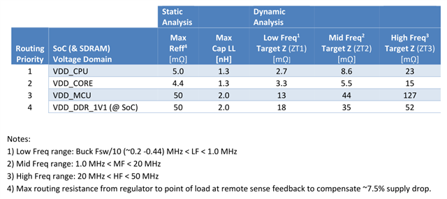

We do have PDN targets for each Jacinto7 device. For AM68, here are the targets. I thought documented in device data manual, but I didn't see them.
Regarding the decoupling capacitor strategy, I recommend following the EVM. I'm not aware of an application note similar to that discussed i the other E2E thread.
