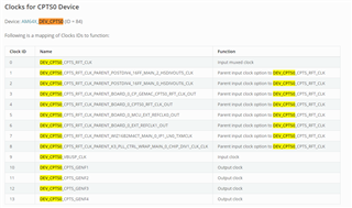

  • Hello Mario,
    Are you implementing this on a custom board or the AM62x EVM (TMDS64EVM) or SK-AM64B?
    According to the following section of the default "k3-am64-main.dtsi",
    • the 84 comes from the device ID of "DEV_CPTS0"
    • the 0 comes from the clock ID of "DEV_CPTS0_CPTS_RFT_CLK"
    • the 8 comes from the clock ID of selected clock parent input clock to "DEV_CPTS0_CPTS_RFT_CLK" -----> "DEV_CPTS0_CPTS_RFT_CLK_PARENT_K3_PLL_CTRL_WRAP_MAIN_0_CHIP_DIV1_CLK_CLK"
      • --> see "assigned-clock-parents = <&k3_clks 84 8>;"
    I obtained this information from https://downloads.ti.com/tisci/esd/latest/5_soc_doc/am64x/clocks.html#clocks-for-cpts0-device and using https://e2e.ti.com/support/processors-group/processors/f/processors-forum/1049800/faq-pru_icssg-how-to-check-and-set-pru-core-frequency-in-linux as reference for how the device tree defines the clock properties. I highly recommend reviewing section "Multiple levels of clock muxing" in the FAQ for how parent clocks are defined in the device tree.

    Using "k3conf dump clocks" in the console of AM64x, I see the following which corresponds to the device tree. As you can see there is a "EXT_REFCLK1_OUT" corresponding to clock ID 6. Due to this, I think you could try changing the "<&k3_clks 84 8>" to "<&k3_clks 84 6>" in the device tree. Please let me know if this works.
    |   84    |    0   | DEV_CPTS0_CPTS_RFT_CLK                                                                              | CLK_STATE_READY | 500000000      |
    |   84    |    1   | DEV_CPTS0_CPTS_RFT_CLK_PARENT_POSTDIV4_16FF_MAIN_2_HSDIVOUT5_CLK                                    | CLK_STATE_READY | 225000000      |
    |   84    |    2   | DEV_CPTS0_CPTS_RFT_CLK_PARENT_POSTDIV4_16FF_MAIN_0_HSDIVOUT6_CLK                                    | CLK_STATE_READY | 200000000      |
    |   84    |    3   | DEV_CPTS0_CPTS_RFT_CLK_PARENT_BOARD_0_CP_GEMAC_CPTS0_RFT_CLK_OUT                                    | CLK_STATE_READY | 0              |
    |   84    |    4   | DEV_CPTS0_CPTS_RFT_CLK_PARENT_BOARD_0_CPTS0_RFT_CLK_OUT                                             | CLK_STATE_READY | 0              |
    |   84    |    5   | DEV_CPTS0_CPTS_RFT_CLK_PARENT_BOARD_0_MCU_EXT_REFCLK0_OUT                                           | CLK_STATE_READY | 0              |
    |   84    |    6   | DEV_CPTS0_CPTS_RFT_CLK_PARENT_BOARD_0_EXT_REFCLK1_OUT                                               | CLK_STATE_READY | 0              |
    |   84    |    7   | DEV_CPTS0_CPTS_RFT_CLK_PARENT_WIZ16B2M4CT_MAIN_0_IP1_LN0_TXMCLK                                     | CLK_STATE_READY | 0              |
    |   84    |    8   | DEV_CPTS0_CPTS_RFT_CLK_PARENT_K3_PLL_CTRL_WRAP_MAIN_0_CHIP_DIV1_CLK_CLK                             | CLK_STATE_READY | 500000000      |
    |   84    |    9   | DEV_CPTS0_VBUSP_CLK                                                                                 | CLK_STATE_READY | 125000000      |

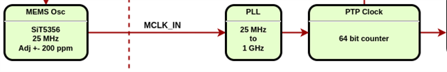

    Just to clarify, you said using devmem2 you were able to configure your desired clock frequency? Can you share the exact command you used to write to the register to set your clock frequency?
    No that is a misinterpretation.  I can see with devmen that the EXT_REFCLK1 (0x43008150) has been selected and that Pimuxing ( 0xf4274 ) is also correct.
    I have written a driver for the sit5356 which is parametrised cleanly by the devtree (see also the dev tree snippet above with sit5356) and I can see with clk_summary.
    oot@lanxi-dbe:~# cat /sys/kernel/debug/clk/clk_summary
                                     enable  prepare  protect                                duty
       clock                          count    count    count        rate   accuracy phase  cycle
     ext_refclk1                          0        0        0    25000000          0     0  50000
     clk:155:2                            0        0        0   160000000          0     0  50000
     clk:155:1                            0        0        0    48000000          0     0  50000
    The question I have is this a viable way or is there another way to communicate the frequency to the CPTS0 unit?

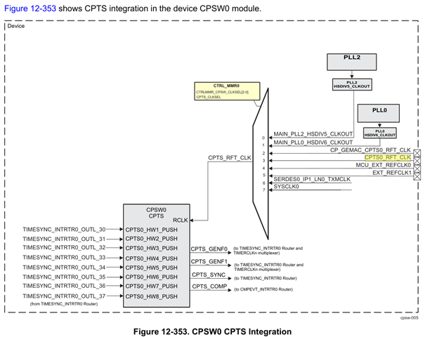

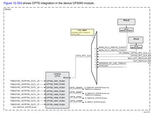

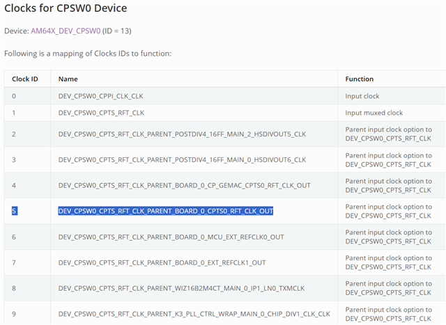

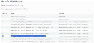

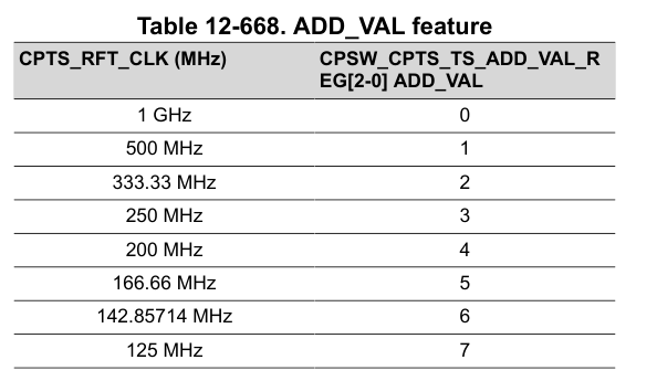

  • Hi Mario,
    After talking to an expert on the team, I realized the CPTS0 is the not the correct CPTS instance you should be using for PTP synchronization. Instead, you should be using CPSW0_CPTS0. (The below table on the TRM is wrong - CPSW0_CPTS0 should be in MAIN domain and we will get this fixed.)
    Using default AM64x EVM device tree files, this means instead of "main_cpts0" in k3-am64-main.dtsi, you should be modifying "cpts@3d000" under "cpsw3g: ethernet@8000000" node. To obtain the correct CPSW0_CPTS with EXT_REFCLK1, use Device ID 13 Clock ID 7. This change also corresponds to register CTRLMMR_CPSW_CLKSEL register 0x43008140.
    cpsw3g: ethernet@8000000 {
        cpts@3d000 {
            compatible = "ti,j721e-cpts";
            reg = <0x0 0x3d000 0x0 0x400>;
            clocks = <&k3_clks 13 1>;
            clock-names = "cpts";
            assigned-clocks = <&k3_clks 13 1>;        <--------ADDED
            assigned-clock-parents = <&k3_clks 13 7>; <--------ADDED
            interrupts-extended = <&gic500 GIC_SPI 102 IRQ_TYPE_LEVEL_HIGH>;

  • Hello Daolin
    Thank you for your support.
    In relation to your question, what we are trying to achieve is shown in this diagram.
    MCK_IN is connected to the EXT_REFCLK1 pin and the oscillator (SiT5356) adjustibale via I2C.
    My thought is to adapt the code of am65_cpts.c.
    So that a PTP frequency adjustment so the ptp4l deamon basically directly adjusts the frequency of the SiT5356 clock.
    I think a possible candidate for the change would be the function.
    am65_cpts_ptp_adjfreq(): The idea is to change the frequency of the PTP clock, connecting the necessary adjustments directly to the SiT5356 via I2C.

  • I have seen in a previous answer from you. The clock ID should be 4.
    So assigned-clock-parents = <&k3_clks 13 4>;
  • Hi Mario,
    I believe it should be device ID 5 for CPTS0_RFT_CLK according to https://downloads.ti.com/tisci/esd/latest/5_soc_doc/am64x/clocks.html#clocks-for-cpsw0-device. So assigned-clock-parents should be <&k3_clks 13 5> if you are using CPTS0_RFT_CLK instead of EXT_REFCLK1.
    May I ask how you discovered EXT_REFCLK1 input was limited to 100MHz? Out of curiosity, why did you choose 125MHz to be the desired input clock reference?
    -Daolin
  • Hello Daolin
    The limitation to 100 MHz can be found in the TI documentation for EXT_REFCLCK1 cycel Time
    We use pin D18 and that is CP_GEMAC_CPTS0_RFT_CLK, it was a typo.
    The 125 MHz is due to the limitation of the ADD_VAL.
    Mario Relaxed
  • Ah I see, I'm assuming TRM Table 12-640 CPSW0 Integration Attributes is where you found the clock limitation for EXT_REFCLK1?
    Any reason why you are using CP_GEMAC_CPTS0_RFT_CLK specifically? I think CPTS0_RFT_CLK is also a pinmux option for D18.
    Out of curiousity, what end application/equipment are you targeting with this PTP synchronization?
    -Daolin
  • Hello Daolin,
    thanks for the additional information.
    The reason why I selected CP_GEMAC_CPTS0_RFT_CLK is because of the clocktree tool. I think it is a bug in this tool as CPTS0_RFT_CLK is missing in both CLOCK INPUTS and CPSWO_IN section.
    I neither use CPTS0_RFT_CLK as you suggest.
    Regarding the frequency limit of the EXT_REFCLK1 PIN, it was the following hint.
    To your last question
    We have several measurement modules and data acquisition devices that use PTP. We also want to use PTP for our new module, which uses the Sitara AM6422 for the first time. This time we have a slightly higher temperature stability requirement.
