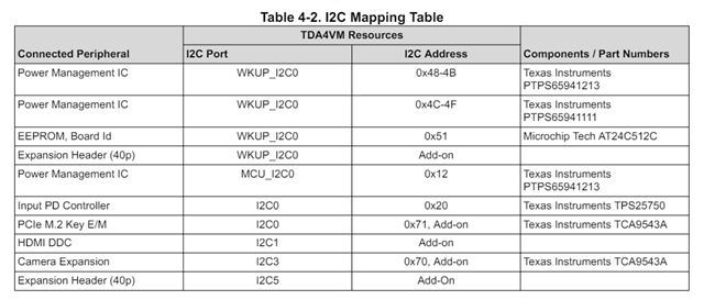

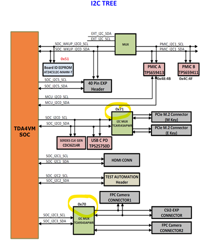

    Could you let me know how I could get the information or document of the i2c bus number for the rest of I2Cs such as SOC_I2C5 / MCU_I2C0 / SOC_I2C0 /SOC_I2C1/ SOC_I2C2/ SOC_I2C3 in SK-TDA4VM?
    root@tda4vm-sk:/opt/edgeai-gst-apps# i2cdump -f -y 0x0 0x48

  •  Hi,
    This is i2c address list on SK-TDA4VM.
    I need to check all the i2c device can be scanned. For now 0x48/49/4a/4b/4c/4d/51 has been confirmed.
    But the MUX device 0x70 on SOC_I2C3 / the MUX device 0x71 on SOC_I2C0 has not been confirmed yet.
  • The I2C map for the SK-TDA4VM is in its user guide, and I've taken a snap shot if the table below:
    Are you asking which pins are used for I2C3?
  • Thanks for the snap shot.
    I marked yellow which haven't been scanned.
  • Is there a device on either the PCIe slot or camera connector you are attempting to communicate?  I believe the TCA9543A devices should respond regardless.  I'm not aware of any existing issue.
  • There is no device on either the PCIe slot or camera.
    But even though there is no device I think TCA9543A should be scanned.
    I want to check what these five address (yellow marked) stands for in the i2c port in Table 4-2.

    Are you able to see the slaves corresponding to TCA?
    Keerthy
