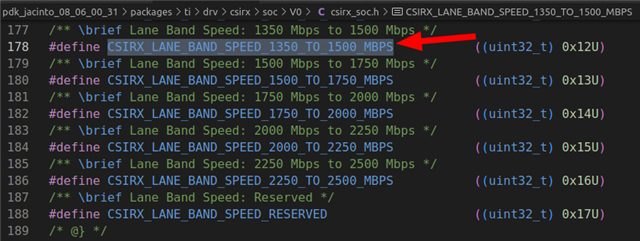

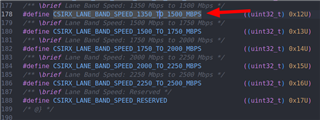

1920x1536 YUV422_8 * 2  ---> max96792A - - ->   CSI1
1.We now have 2 60fps cameras connected,The data_land of 60FPS is 864Mbps/lane.
max96792A deserializer rate set to: 1800MHz
2.
reg 0x483  ---  0x81   DESKEW enabled
3.
What should csi_laneBandSpeed be set to?
