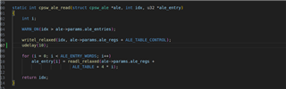

My board is TDA4 connected with SJA1105(ethernet switch with RGMII) using MCU_CPSW(RGMII) .The SJA1105 is RGMII 1000M fixed link with TX and RX delay, and MCU_CPSW is also 1000M fixed link.
Sja1105 connect nvidia orin with sja1105. TDA4 and nvidia use middleware for communication. After few hours, tda4 cann't receive frames from nvidia orin, and no ping response.
Here is the connection:
But  after I execute eth0 down/up command on TDA4, the network return to normal.
Here is Tda4 register when the issue occurred
Read at address  0x46000000 : 0x6BA00101

    May I know which SDK version are you using?
    Please share the debug as well if you are using Native Linux Driver on A72.
    Sudheer
    The SDK version is 8.2.
  • Here is the log use ethtool :

    I add more prints in cpsw_ale.c:
    diff --git a/kernel/linux-5.10.41+gitAUTOINC+4c2eade9f7-g4c2eade9f7/drivers/net/ethernet/ti/am65-cpsw-nuss.c b/kernel/linux-5.10.41+gitAUTOINC+4c2eade9f7-g4c2eade9f7/drivers/net/ethernet/ti/am65-cpsw-nuss.c
    index 2b52c75f7..f006dc8ed 100644
    --- a/kernel/linux-5.10.41+gitAUTOINC+4c2eade9f7-g4c2eade9f7/drivers/net/ethernet/ti/am65-cpsw-nuss.c
    +++ b/kernel/linux-5.10.41+gitAUTOINC+4c2eade9f7-g4c2eade9f7/drivers/net/ethernet/ti/am65-cpsw-nuss.c
    @@ -334,6 +334,8 @@ static void am65_cpsw_nuss_ndo_slave_set_rx_mode(struct net_device *ndev)
     					   port_mask, 0, 0, 0);
    +	netdev_err(ndev, "%s\n",__func__);
     static void am65_cpsw_nuss_ndo_host_tx_timeout(struct net_device *ndev,
    diff --git a/kernel/linux-5.10.41+gitAUTOINC+4c2eade9f7-g4c2eade9f7/drivers/net/ethernet/ti/am65-cpsw-switchdev.c b/kernel/linux-5.10.41+gitAUTOINC+4c2eade9f7-g4c2eade9f7/drivers/net/ethernet/ti/am65-cpsw-switchdev.c
    index b9ab087b6..0c5d63aba 100644
    --- a/kernel/linux-5.10.41+gitAUTOINC+4c2eade9f7-g4c2eade9f7/drivers/net/ethernet/ti/am65-cpsw-switchdev.c
    +++ b/kernel/linux-5.10.41+gitAUTOINC+4c2eade9f7-g4c2eade9f7/drivers/net/ethernet/ti/am65-cpsw-switchdev.c
    @@ -231,7 +231,7 @@ static int am65_cpsw_port_vlan_del(struct am65_cpsw_port *port, u16 vid,
     	cpsw_ale_del_mcast(cpsw->ale, port->ndev->broadcast, port_mask,
     			   ALE_VLAN, vid);
    -	netdev_dbg(port->ndev, "VID del: %s: vid:%u ports:%X\n",
    +	netdev_err(port->ndev, "VID del: %s: vid:%u ports:%X\n",
     		   port->ndev->name, vid, port_mask);
     	return ret;
    diff --git a/kernel/linux-5.10.41+gitAUTOINC+4c2eade9f7-g4c2eade9f7/drivers/net/ethernet/ti/cpsw_ale.c b/kernel/linux-5.10.41+gitAUTOINC+4c2eade9f7-g4c2eade9f7/drivers/net/ethernet/ti/cpsw_ale.c
    index be75bb009..8511edd1f 100644
    --- a/kernel/linux-5.10.41+gitAUTOINC+4c2eade9f7-g4c2eade9f7/drivers/net/ethernet/ti/cpsw_ale.c
    +++ b/kernel/linux-5.10.41+gitAUTOINC+4c2eade9f7-g4c2eade9f7/drivers/net/ethernet/ti/cpsw_ale.c
    @@ -449,6 +449,7 @@ int cpsw_ale_flush_multicast(struct cpsw_ale *ale, int port_mask, int vid)
     		cpsw_ale_write(ale, idx, ale_entry);
    +		dev_err(ale->params.dev, "%s  idx: %d,port_mask 0x%x\n", __func__,idx,port_mask);
     	return 0;
    @@ -470,6 +471,7 @@ int cpsw_ale_add_ucast(struct cpsw_ale *ale, const u8 *addr, int port,
     	u32 ale_entry[ALE_ENTRY_WORDS] = {0, 0, 0};
     	int idx;
    +	dev_err(ale->params.dev, "%s \n", __func__);
     	cpsw_ale_set_vlan_entry_type(ale_entry, flags, vid);
     	cpsw_ale_set_addr(ale_entry, addr);
    @@ -487,6 +489,7 @@ int cpsw_ale_add_ucast(struct cpsw_ale *ale, const u8 *addr, int port,
     		return -ENOMEM;
    +	dev_err(ale->params.dev, "%s  vid: %d,idx : %d,addr: %02x:%02x:%02x:%02x:%02x:%02x\n", __func__,vid,idx,addr[0],addr[1],addr[2],addr[3],addr[4],addr[5]);
     	return 0;
    @@ -502,6 +505,7 @@ int cpsw_ale_del_ucast(struct cpsw_ale *ale, const u8 *addr, int port,
     	cpsw_ale_set_entry_type(ale_entry, ALE_TYPE_FREE);
     	return 0;
    @@ -535,6 +539,7 @@ int cpsw_ale_add_mcast(struct cpsw_ale *ale, const u8 *addr, int port_mask,
     		return -ENOMEM;
    +	dev_err(ale->params.dev, "%s  vid: %d,idx : %d,port_mask 0x%x,addr: %02x:%02x:%02x:%02x:%02x:%02x\n", __func__,vid,idx,port_mask,addr[0],addr[1],addr[2],addr[3],addr[4],addr[5]);
     	return 0;
    @@ -545,6 +550,7 @@ int cpsw_ale_del_mcast(struct cpsw_ale *ale, const u8 *addr, int port_mask,
     	int mcast_members = 0;
     	int idx;
     	idx = cpsw_ale_match_addr(ale, addr, (flags & ALE_VLAN) ? vid : 0);
     	if (idx < 0)
     		return -ENOENT;
    @@ -564,6 +570,7 @@ int cpsw_ale_del_mcast(struct cpsw_ale *ale, const u8 *addr, int port_mask,
     	return 0;
    @@ -582,6 +589,7 @@ static void cpsw_ale_set_vlan_mcast(struct cpsw_ale *ale, u32 *ale_entry,
     	idx = cpsw_ale_vlan_get_fld(ale, ale_entry,
     				    ALE_ENT_VID_UNREG_MCAST_IDX);
     	writel(unreg_mcast, ale->params.ale_regs + ALE_VLAN_MASK_MUX(idx));
     static void cpsw_ale_set_vlan_untag(struct cpsw_ale *ale, u32 *ale_entry,
    @@ -602,6 +610,7 @@ int cpsw_ale_add_vlan(struct cpsw_ale *ale, u16 vid, int port_mask, int untag,
     	int idx;
     	idx = cpsw_ale_match_vlan(ale, vid);
     	if (idx >= 0)
     		cpsw_ale_read(ale, idx, ale_entry);
    @@ -633,6 +642,9 @@ int cpsw_ale_add_vlan(struct cpsw_ale *ale, u16 vid, int port_mask, int untag,
     		return -ENOMEM;
    +	dev_err(ale->params.dev, "%s  vid: %d,idx:%d,port_mask 0x%x\n", __func__,vid,idx,port_mask);
     	return 0;
    @@ -642,6 +654,8 @@ static void cpsw_ale_vlan_del_modify_int(struct cpsw_ale *ale,  u32 *ale_entry,
     	int reg_mcast, unreg_mcast;
     	int members, untag;
     	members = cpsw_ale_vlan_get_fld(ale, ale_entry,
     					ALE_ENT_VID_MEMBER_LIST);
     	members &= ~port_mask;
    @@ -674,6 +688,7 @@ static void cpsw_ale_vlan_del_modify_int(struct cpsw_ale *ale,  u32 *ale_entry,
     	cpsw_ale_vlan_set_fld(ale, ale_entry,
     			      ALE_ENT_VID_MEMBER_LIST, members);
    +	dev_err(ale->params.dev, "%s  vid: %d,port_mask 0x%x\n", __func__,vid,port_mask);
     int cpsw_ale_vlan_del_modify(struct cpsw_ale *ale, u16 vid, int port_mask)
    @@ -681,6 +696,7 @@ int cpsw_ale_vlan_del_modify(struct cpsw_ale *ale, u16 vid, int port_mask)
     	int idx;
     	if (idx < 0)
     		return -ENOENT;
    @@ -689,7 +705,7 @@ int cpsw_ale_vlan_del_modify(struct cpsw_ale *ale, u16 vid, int port_mask)
     	cpsw_ale_vlan_del_modify_int(ale, ale_entry, vid, port_mask);
     	return 0;
    @@ -698,6 +714,8 @@ int cpsw_ale_del_vlan(struct cpsw_ale *ale, u16 vid, int port_mask)
     	int members, idx;
     	if (idx < 0)
     		return -ENOENT;
    @@ -724,6 +742,8 @@ int cpsw_ale_del_vlan(struct cpsw_ale *ale, u16 vid, int port_mask)
    +	dev_err(ale->params.dev, "%s idx:%d\n", __func__,idx);
     	return 0;
    @@ -760,7 +780,7 @@ int cpsw_ale_vlan_add_modify(struct cpsw_ale *ale, u16 vid, int port_mask,
     		dev_err(ale->params.dev, "Unable to add vlan\n");
     		return ret;
    -	dev_dbg(ale->params.dev, "port mask 0x%x untag 0x%x\n", vlan_members,
    +	dev_err(ale->params.dev, "port mask 0x%x untag 0x%x\n", vlan_members,
     		untag_mask);
     	return ret;
    @@ -791,6 +811,7 @@ void cpsw_ale_set_unreg_mcast(struct cpsw_ale *ale, int unreg_mcast_mask,
     				      unreg_members);
    +	dev_err(ale->params.dev, "%s\n", __func__);
     static void cpsw_ale_vlan_set_unreg_mcast(struct cpsw_ale *ale, u32 *ale_entry,
    @@ -856,6 +877,7 @@ void cpsw_ale_set_allmulti(struct cpsw_ale *ale, int allmulti, int port)
     struct ale_control_info {
    Here is the dmesg log when the issue happens:
    3666.dmesg_cpsw.log
  • Hi, we added more printing in the code, and get more update.

    the "#1#" printing is in the following function:
    It means the type of idx 0 was free to be written. But it is hard to tell who changed it, because we have added printing in all the functions that has cpsw_ale_write,
    but did not see them called in the log when the issue happens.
    while checking the code we found a modification in SDK 9.2 is suspicious, we don't know whether it can cause the issue:
    please help to check code and find the reason.
    best regards.
    I have seen VLAN entry over written by MAC entry in yesterday log.

    Can you please add delay (udelay(10);) in cpsw_ale_read after writing ALE TABLE CONTROL register i.e. adding delay for reading.
    With above change can you please check is issue is reproduced or not?
    Sudheer
    Add delay (udelay(10);) in cpsw_ale_read, the issue still can be reproduced.
    Best Regards
    I have reported the Issue internally with IP team to confirm the procedure to access ALE table.
    Can you check by increasing the delay, whether it was helping or not?
    If still not working after increasing the delay, can you check by writing the ALE TABLE CONTROL register twice i.e.
    writel_relaxed(idx,ale->params.ale_regs + ALE_TABLE_CONTROL);
    Sudheer
     Writing the ALE TABLE CONTROL register twice, this issue is not reproduced.
