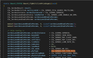

    And I see that PCIe + QSGMII multilink configuration in board_serdes_cfg.c file within PDK is the only configuration that sets phyType to PCIe:
    - So it could be that PCIe is only getting configured when it detects multilink, which could explain why PCIe is only coming up when configuring multiple lanes. Unless you have developed a new function that configures phyType for PCIe for a single link.
