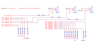

  • Hello Richard,
    I have already asked this question at Segger's forum, but no one answered.
    I want to know the meaning of "a no-boot sysboot mode" . Are you referring to the sysboot[5:0] configration that is NOT appear in this picture below?
    If I guess correctly, please show me your configration of sysboot[5:0].
    My English is poor, but I think you understand what I'm saying.
    Thanks.
    Steve sun

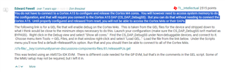

  • Hello Richard,
    I asked this question at segger's forum. Alex thinks you are a very capable guy, and I also highly approve of it.
    https://forum.segger.com/index.php/Thread/9468-Can-not-halt-m4-on-AM572x-evaluation-module-by-JTrace/
    Based on the information provided by both of you, I will try again.
    If you find any new clues, please reply to me.
    Thanks very much.
    Steve sun
  • Hello Steve,
    I was out of the office last week.  Sorry for the delay.  As I mentioned the most likely case is some code execution which is conflicting with your script.  For boot modes, I would suggest picking one which cannot boot (both primary and backup are impossible as your board does not have them).   I usually picked an SD card boot type and just removed the card to get to a known no boot state.  I would guess you might have a QSPI backup which has code running and causing some issue.
    Richard W.
  • Hello Richard,
    I've been dealing with other things these days.
    My board is https://www.ti.com/tool/TMDSEVM572X. Since I bought it from TI, I haven't made any modifications.
    The sysboot[5:0] could be 0bXX 001X. If I don't modify the configuration of the resistors, what can I do to let it get to no boot state.
    I think Alex is right. The A15 is master core, so my jtrace can work correctly. But the M4(IPU) is slave core, how to start it without A15 by jtrace?
    Is it related to the initialization of ICEPICK-D? I have a Reference Guide of  ICEPICK-C, but not  ICEPICK-D.
    I tried to understand what your colleague meant, but it was a bit difficult to understand.
    If you have a jtrace, could you make a jlink script to debug M4?
    Thanks very much.
    Steve sun
  • Hello Steve,
    I do not have a jtrace to try out what is being proposed. It is true that configuration of the M4 can be done using the AHP-AP post an attach to the icepick.  This can be done without touching the ARM core's debug logic.  Since you can connect to the A15 you will have the option to try and control the M4's power/reset/clock using the A15 or the AHP-AP.
    As I was guessing, the primary reason you would not be able to attach to the M4 was if was somehow crashed in a bad state from some previous code execution. You should make sure nothing has run before you try and attach. This might mean corrupting flash code to ensure a failed boot. Regarding the PRCM and the IPU reset status, you should be able to read the reset state from the status registers. Already the IPU gels are manipulating these registers.  I would recommend reading back status and seeing if the IPU is stuck in transition or something else.
