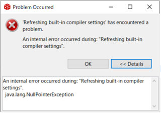

Hi Teja,
Thanks for your information.
I am trying to test the enet_lwip_icssg_am64x-evm_r5fss0-0_freertos_ti-arm-clang in industrial SDK v9.02.
However, error occord when import CCS project to CCS v12.6.
I done Re-install SDK, re-boot my PC, installing newest sysconfig, but it not solved.
The hello world sample from compleatly same version of the ind-SDK can build nomally.
Do you know how to fix this probrem?
GR
Hi GR,
you need to install CCS 12.7.0 for SDK 9.2
AM243x MCU+ SDK: Download, Install and Setup CCS (ti.com)
Ashwani
