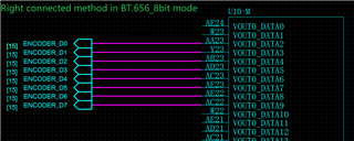

Hi TI Experts,
  We want to output YUV DATA to external CVBS Encoder by using AM62P DPI Interface, I saw the  two LSBs are ignored and only bits[9-2] are effectively for BT.656 Mode, and the  four LSBs are ignored and only bits[9-2]、bits[19-12] are effectively for BT.1120_16-bit Mode in TRM.
  We want to know the following questons,
1.Does the AM62P support the Y,C divided mode when outputing YUV data(like below pictures)?
2.Does the data line of AM62P must follow the reference connneted method(only bits [9-2] are effectively used in BT.656_8-bit mode and only bits [19-12] are effectively used in BT.656_16-bit mode)? My understand is belowm, is right?
