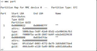

    I followed the previous thread you mentioned, i had progressed a littile bit. but now I have a different issue. its failed to load the kernal from rootfs.
    my rootfs partition is number 2. does it matter ? or it has to be number 1 ?
    contents of rootfs/boot
    This is my partition map
  • Hi Diwakar
    i am able to boot the linux now by following the steps in the ticket. we can close this ticket.

  • I encounter the same issue, I would suggest BU team update the uboot parameter for each boot mode accordingly.

    need to => setenv bootpart 0:1 or => setenv bootpart 0:2 according to file system partition.
    [2024-06-18 13:17:51.028] => setenv bootpart 0:2
    [2024-06-18 13:18:00.513] => boot

    The initial error is:
    [2024-06-18 13:21:33.589] eth0: ethernet@8000000port@1
    [2024-06-18 13:21:33.589] Hit any key to stop autoboot: 2 1 0
    [2024-06-18 13:21:37.605] MMC: no card present
    [2024-06-18 13:21:37.700] SD/MMC found on device 1
    [2024-06-18 13:21:39.702] MMC: no card present
    [2024-06-18 13:21:39.702] ** Bad device specification mmc 1 **
    [2024-06-18 13:21:39.702] Couldn't find partition mmc 1
    [2024-06-18 13:21:39.702] Can't set block device
    [2024-06-18 13:21:41.714] MMC: no card present
    [2024-06-18 13:21:41.716] ** Bad device specification mmc 1 **
    [2024-06-18 13:21:41.716] Couldn't find partition mmc 1
    [2024-06-18 13:21:41.716] Can't set block device
    [2024-06-18 13:21:43.719] MMC: no card present
    [2024-06-18 13:21:43.719] ** Bad device specification mmc 1 **
    [2024-06-18 13:21:43.719] ## Error: "main_cpsw0_qsgmii_phyinit" not defined
    [2024-06-18 13:21:45.733] MMC: no card present
    [2024-06-18 13:21:45.733] ** Bad device specification mmc 1 **
    [2024-06-18 13:21:45.733] Couldn't find partition mmc 1:2
    [2024-06-18 13:21:45.733] Can't set block device
    [2024-06-18 13:21:47.752] MMC: no card present
    The parameter always search filesystem from mmc1, not according to boot mode.
