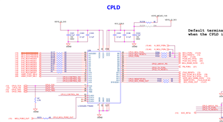

Could you provide spread sheet for CPLD in SK-TDA4VM that describes default pull up or pulled down pin assignment?

    3) The CPLD content is included in the zip file under "Design files" on the SK-TDA4VM purchase page: https://www.ti.com/tool/SK-TDA4VM. I will also link the direct link on the SK-TDA4VM for convenience: https://www.ti.com/lit/zip/sprr438. The file named "top_cpld.v" has the content that is programmed into the CPLD.

  • Thanks for your kindness.
    Actually I have the file named "top_cpld.v".
    But this file doesn't seem to include these information as I call it "spread sheet" of CPLD.
    a pin assignment of each pins (I/O physical connection number)
    a I/O level of each pins (such as LVCMOS33)
    a Pull mode of each pins (such as pull down / pull up)
    a Drive strength of each pins
    I want to be shared how SK-TDA4VM CPLD defined and set those things.

  • 2) I would recommend referencing the SK-TDA4VM user guide: https://www.ti.com/lit/ug/spruj21d/spruj21d.pdf. Particularly, section "4.5 Identification EEPROM" which I have screenshotted and copied below for convenience:
    Can we write those data to an empty EEPROM?
    If it is possible. could you share command how to write on boot mode in SK-TDA4VM?

    As for CPLD pin assignments, I would again recommend referencing top_cpld.v. However, in addition to this file, please reference PROC112B(001)_SCH.pdf file that is included in the same location as top_cpld.v file. The value of these pins depend on the hardware schematics. I see that most of the inputs are connected to the bootmode DIP switches, and some reset signals for PCIe and the SoC. The names are pretty similar between schematic and top_cpld.v such that you can map which pins connect to where, and whether they have pull up/pull down resistors, etc.
    Takuma
