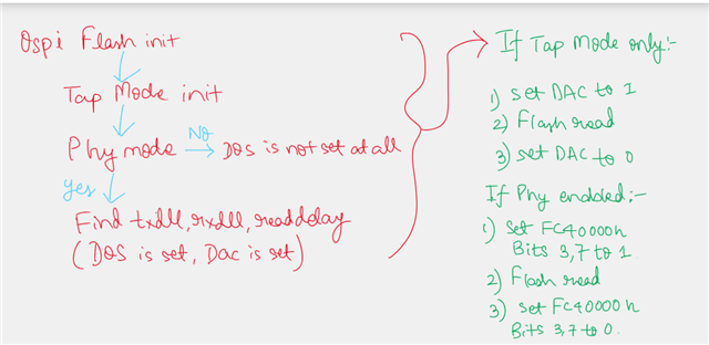

  • Hello Koichiro,
    As per my understanding the idea is when Phy mode is enabled, we do Direct read operations.
    Hence, we need to have DAC mode enabled.
    Can you please go ahead and tell me the value of the following registers after you have made the configurations?
    Register name: OSPI_CONFIG_REG Address: 0x0FC40000h
    Register name: OSPI_RD_DATA_CAPTURE_REG Address: 0x0FC40010h
    I would need to know the value of this register in both the modes which you are operating in. that is TAP and PHY.
    Vaibhav

  • Hello Koichiro,
    So, I ran a SDK example based out of MCU PLUS SDK just to see what will be the value of the registers when PHY mode is enabled vs when TAP mode is enabled: FYI this is from AM64x execution and will be mostly same for AM62x for sure. But will cross check with AM62x as well.
    Before any configuration is done for Phy mode enabled OR Tap mode the register values are the same:
    After all the configurations for OSPI are done for PHY Enabled mode the register values are:
    After all the configurations for OSPI are done for TAP mode the register values are:
    Vaibhav
    Thanks for your patience.
    The below is the register dump for AM62x. The above one is from AM64x.
    Before any configurations both the cases the register values are the same:
    After PHY Mode enabled configurations for OSPI:
    After Tap mode configurations for OSPI:
    Vaibhav

  • Hello Koichiro,
    Thanks for your reply and sorry for my late feedback.
    It is fine.
    Now the customer is able to read/write to the memory using PHY mode configuration you provided.
    I am glad that the customer is able to do the write and read operations with the register configurations I provided. Good to hear this.
    Q1) Is this expected PHY_MODE_ENABLE_FLD is 0 for PHY mode?
    So I will explain this in another response as it needs some explanation.
    Vaibhav
    Thank you for the patience.
    So, I am yet to respond on this question
    Here we go,
    You see that the register configurations I have given you and which worked for the customer is absolutely fine.
    The Phy enable field should only be set to 1, when doing read operations, else most of the times this phy enable field should be set to 0.
    And when the read is done, we need to disable phy and then do the other operation like write.
    Vaibhav

  • 1) OSPI_RD_DATA_CAPTURE_REG[8].DQS_ENABLE_FLD value
    Lucas said it should be 0, but PHY mode register dump sent by Vaibhav shows the bit is 1.
    0x0FC40010 is 0x0000123 for both PHY mode and TAP mode.
    I have checked properly by executing the code again.
    What I have observed is upon resetting DQS field gets reset to 0. Which I think while running and giving you the register dump earlier, I did not happen to reset correctly.
    So, safe to say:
    1. DQS filed should only be set to 1, when the Phy is enabled.
    2. If the Phy is not enabled, meaning the operation is in TAP mode, no need of having DQS set to 0, it should be always 0 in TAP mode.
    2) Difference between PHY mode and TAP mode is only OSPI0_CONFIG_REG[7].ENB_DIR_ACC_CTLR_FLD.
    0x0FC40000 is 0xC1083881(PHY) or 0xC1083801(TAP).
    This is strange.
    I will explain this in another response with the help of a whiteboard diagram.
    3) Below comments for OSPI0_CONFIG_REG[3].PHY_MODE_ENABLE_FLD does not seem correct.
    As soon as PHY_MODE_ENABLE is set, the customer cannot read memory data.
    The customer thinks above comment is to for OSPI0_CONFIG_REG[25].PIPELINE_PHY_FLD.
    TRM Table 14-18650.
    Please see the diagram I am drawing for you to understand this visually.
    FYI, Allow me sometime to put forward the diagrams.
    I have drawn a rough sketch. Please find it as follows:
    If the customer is going to read more than 1024 bytes at a time, then let me know, in that case, the diagram would need a bit of modification.
    Vaibhav
