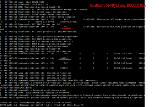

    During my testing today, I discovered that I do indeed encounter interrupt storms.
    I can easily reproduce the interrupt storm on the PCBA when I connect the UART wireless module. The number of interruptions is huge, approximately 10,000 times per second, causing the operating system to crash.
    The picture below shows that the number of interruptions increased by 500,000 in just 2 seconds:
    It seems that we have to choose between losing data or mitigating the storm. The current solution doesn't work for me because on my PCBA, it could lose data on the serial port and it could experience interrupt storms on the WiFi module. Is it possible to solve them simultaneously?
    In my observation, the WiFi module exhibits strange behavior: it sends strange data to the SoC when powered on. I suspect this may be the reason for triggering the interrupt storm.
    I also observed that the RTS has a peculiar jump before the interrupt storm occurs, as shown at point B, and point C marks the time when the interrupt storm occurs:
    A: When powering on
    B: Abnormal RTS jump
    C: Interrupt storm occurs
    Sean

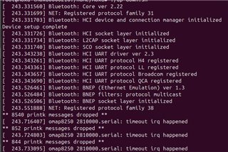

    After entering the "hciattach /dev/ttyS3 any 3000000 flow" command, a large number of timeout messages will be displayed.
    [  243.331560] Bluetooth: Core ver 2.22
    [  243.331699] NET: Registered protocol family 31
    [  243.331703] Bluetooth: HCI device and connection manager initialized
    Device setup complete
    [  243.331726] Bluetooth: HCI socket layer initialized
    [  243.331734] Bluetooth: L2CAP socket layer initialized
    [  243.331740] Bluetooth: SCO socket layer initialized
    [  243.343238] Bluetooth: HCI UART driver ver 2.3
    [  243.343261] Bluetooth: HCI UART protocol H4 registered
    [  243.343361] Bluetooth: HCI UART protocol LL registered
    [  243.343657] Bluetooth: HCI UART protocol Broadcom registered
    [  243.343690] Bluetooth: HCI UART protocol QCA registered
    [  243.526461] Bluetooth: BNEP (Ethernet Emulation) ver 1.3
    [  243.526484] Bluetooth: BNEP filters: protocol multicast
    [  243.526506] Bluetooth: BNEP socket layer initialized
    [  243.551888] NET: Registered protocol family 38
    ** 8540 printk messages dropped **
    [  243.716407] omap8250 2810000.serial: timeout irq happened
    ** 852 printk messages dropped **
    [  243.724803] omap8250 2810000.serial: timeout irq happened
    Sean

    [   47.154484] omap8250 2810000.serial: apply solution of Errata i2310
    [   47.161208] omap8250 2810000.serial: apply solution of Errata i2310
    [   47.174169] omap8250 2810000.serial: apply solution of Errata i2310
    [   47.180732] omap8250 2810000.serial: apply solution of Errata i2310
    [   47.187220] omap8250 2810000.serial: apply solution of Errata i2310
    [   47.193615] omap8250 2810000.serial: apply solution of Errata i2310
    [   47.200012] omap8250 2810000.serial: apply solution of Errata i2310
    [   47.212727] omap8250 2810000.serial: apply solution of Errata i2310
    [   47.220957] omap8250 2810000.serial: apply solution of Errata i2310
    [   47.223323] omap8250 2810000.serial: apply solution of Errata i2310
    [   47.225393] omap8250 2810000.serial: apply solution of Errata i2310
    [   47.227511] omap8250 2810000.serial: apply solution of Errata i2310
    [   47.229695] omap8250 2810000.serial: apply solution of Errata i2310
    [   47.232371] omap8250 2810000.serial: apply solution of Errata i2310
    [   47.235017] omap8250 2810000.serial: apply solution of Errata i2310
    [   47.242442] omap8250 2810000.serial: apply solution of Errata i2310
    [   47.265473] omap8250 2810000.serial: apply solution of Errata i2310
    [   47.267479] omap8250 2810000.serial: apply solution of Errata i2310
    ** 578 printk messages dropped **
    [   47.271436] omap8250 2810000.serial: timeout irq happened
    ** 2572 printk messages dropped **
    [   47.288943] omap8250 2810000.serial: apply solution of Errata i2310
    ** 1467 printk messages dropped **
    [   47.298428] omap8250 2810000.serial: timeout irq happened
    ** 1242 printk messages dropped **
    [   47.306354] omap8250 2810000.serial: apply solution of Errata i2310
    The solution for Errata i2310 seems like it could not prevent the 'timeout irq' from occurring.

    When you booted the board with this patched kernel, then run command 'serialstats -i 1 -d /dev/ttySx' ('x' is the index of the UART port under test) on your board console, it prints the port 'x' status in 1 second interval, the first variable 'cts' is the count of RX TIMEOUT interrupts. Then you start the UART communication with the modem to generate the UART interrupt storm, get the UART interrupt count (/proc/interrupts) in 1 second interval too. Finally comparing the 'cts' counts and the UART interrupt counts to see if the RX TIMEOUT interrupt is the source of the interrupt storm.
  • Hi Bin,
    Here are the test results:
    The number of interrupts appears to be in sync with CTS.
    ./serialstats -i 1 -d /dev/ttyS3
    cts: 0 dsr: 0 rng: 0 dcd: 0 rx: 792 tx: 808 frame error 0 overuns 0 parity: 0 br                                                                   eak: 0 buffer overrun: 0
    cts: 0 dsr: 0 rng: 0 dcd: 0 rx: 1584 tx: 1616 frame error 0 overuns 0 parity: 0                                                                    break: 0 buffer overrun: 0
    cts: 0 dsr: 0 rng: 0 dcd: 0 rx: 2376 tx: 2424 frame error 0 overuns 0 parity: 0                                                                    break: 0 buffer overrun: 0
    cts: 55170 dsr: 0 rng: 0 dcd: 0 rx: 3118 tx: 2656 frame error 0 overuns 0 parity                                                                   : 0 break: 0 buffer overrun: 0
    cts: 222385 dsr: 0 rng: 0 dcd: 0 rx: 3168 tx: 3232 frame error 0 overuns 0 parity: 0 break: 0 buffer overrun: 0
    cts: 222385 dsr: 0 rng: 0 dcd: 0 rx: 3960 tx: 4040 frame error 0 overuns 0 parity: 0 break: 0 buffer overrun: 0
    cts: 278376 dsr: 0 rng: 0 dcd: 0 rx: 4481 tx: 4126 frame error 0 overuns 0 parity: 0 break: 0 buffer overrun: 0
    cts: 372711 dsr: 0 rng: 0 dcd: 0 rx: 4752 tx: 4848 frame error 0 overuns 0 parity: 0 break: 0 buffer overrun: 0
    cts: 372711 dsr: 0 rng: 0 dcd: 0 rx: 5544 tx: 5656 frame error 0 overuns 0 parity: 0 break: 0 buffer overrun: 0
    cts: 372711 dsr: 0 rng: 0 dcd: 0 rx: 6336 tx: 6464 frame error 0 overuns 0 parity: 0 break: 0 buffer overrun: 0
    cts: 372711 dsr: 0 rng: 0 dcd: 0 rx: 7128 tx: 7272 frame error 0 overuns 0 parity: 0 break: 0 buffer overrun: 0
    cts: 372711 dsr: 0 rng: 0 dcd: 0 rx: 7920 tx: 8080 frame error 0 overuns 0 parity: 0 break: 0 buffer overrun: 0
    cts: 372711 dsr: 0 rng: 0 dcd: 0 rx: 8712 tx: 8888 frame error 0 overuns 0 parity: 0 break: 0 buffer overrun: 0
    cts: 372711 dsr: 0 rng: 0 dcd: 0 rx: 8712 tx: 8892 frame error 0 overuns 0 parity: 0 break: 0 buffer overrun: 0
    cts: 372711 dsr: 0 rng: 0 dcd: 0 rx: 9504 tx: 9696 frame error 0 overuns 0 parity: 0 break: 0 buffer overrun: 0
    cts: 372711 dsr: 0 rng: 0 dcd: 0 rx: 10296 tx: 10504 frame error 0 overuns 0 parity: 0 break: 0 buffer overrun: 0
    28:       4135          0          0          0     GICv3 211 Level     2810000.serial
    28:       4138          0          0          0     GICv3 211 Level     2810000.serial
    28:     226682          0          0          0     GICv3 211 Level     2810000.serial
    28:     377333          0          0          0     GICv3 211 Level     2810000.serial
    Sean
  • Hi Sean,
    Thanks for the testing. Yes I think the result shows most the UART interrupts are the RX TIMEOUT interrupts.

    Test Case 2: Accumulate DSR at RX TIMEOUT.
    In Test Case 2, the CTS, DSR, and RNG are close to the UART interrupt.
    28:     412679          0          0          0     GICv3 211 Level     2810000.serial
    cts: 94425 dsr: 94476 rng: 94425 dcd: 0 rx: 806 tx: 1770 frame error 0 overuns 0 parity: 0 break: 0 buffer overrun: 0
    cts: 331765 dsr: 331816 rng: 331765 dcd: 0 rx: 806 tx: 1770 frame error 0 overuns 0 parity: 0 break: 0 buffer overrun: 0
    cts: 412570 dsr: 412670 rng: 412571 dcd: 0 rx: 1598 tx: 2578 frame error 0 overuns 0 parity: 0 break: 0 buffer overrun: 0
    This is the patch I used for Test Case 2:
