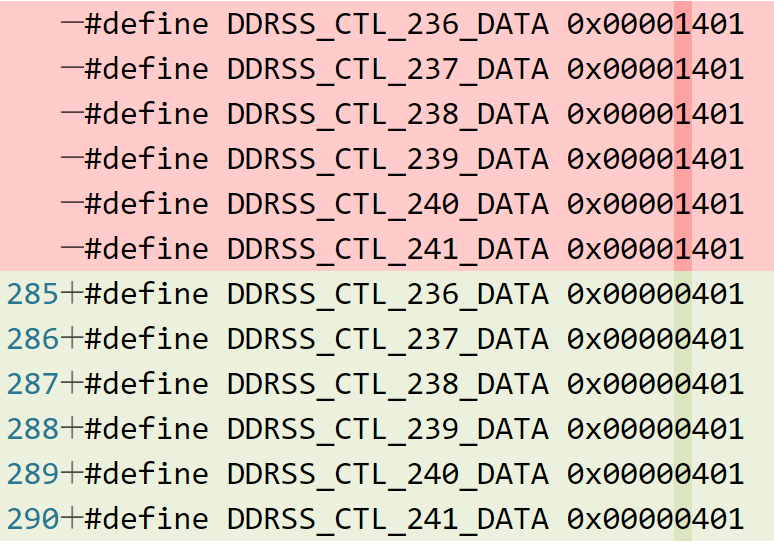

OK, but please note that they may encounter supply noise issues with a memory that doesn't support DBI. This is required for reliable operation.
They will have to manually make the following changes to their configuration:
James

Thomas, i would not recommend using the old tool. The latest tool has several enhancements and modifications. I can allow changing the read DBI in the next version of the tool, but i will still reiterate that it is not recommended to use a DDR4 that doesn't support read DBI.
For now, they will have to use the current tool, and make the manual changes i mentioned above
James

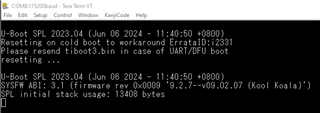

Hi James,
My DDR4 part number is IS43QR81024A-075VBLI K103 (ISSI, 8-bit, 1Gb).
For our customized AM6442 board, we use 2 pieces of such 8-bit DDR4 module to be a 16-bit system connecting with AM6442.
After following your above instruction, I try to DISABLE the "read DBI" function manually, but our system still cannot boot up, yet. (as attached screenshot)
PS: The EEPROM check process has been bypassed. (SDK 09.02.01.09)
Kind Regards,
Choson
Hi Choson, is the a new custom board, or has this board worked before and now it doesn't? I'm just trying to see if this is specifically a DBI problem, or there may be some other unrelated issue.
Can you send the schematic of the DDR interface from processor to memory? Did you implement VTT termination? Did you connect both BG[1:0] signals?
James
