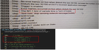

When we tested the CAN sampling points with professional equipment, we found that the tested values were too different from the values we configured.
Our actual configuration is 0.8, but the actual value tested is 0.84.
The following are the relevant parameters that we configured through EB
CAN clock We use the default clock source in the SDK.
Now we can't find out whether it is the software or the hardware problem, please ask the experts of TI to help us look at this problem
