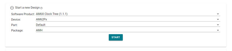

Hi TI teams
      I would like to ask what are the timer frequencies for MCU TIMER0, MCU TIMER1, MCU TIMER2, and MCU TIMER3 on the AM62P5 development board?Looking forward to your reply.
        SHI
  • Hi Li,
    Thanks for your question.
    The timer frequencies for all of the mentioned timer modules can be found at the clock tree tool page.
    You can find it at dev.ti.com/sysconfig
    Once done, select start and you can go to the timer sections as shown in the below screenshot.
    You can select each timer module and see the frequency for them.
    Hope this helps.
