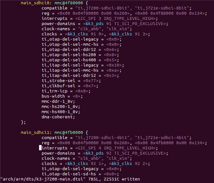

I have connected an eMMC to MMC0 in my custom TDA4VM board.
I noticed in U-Boot device tree that MMC0 is not there.
What are all the changes I have to do to boot through MMC port0?

  • Sathiya,
    I see the sdhci0 node that corresponds to MMC0 aka eMMC. What is your question? Can you elaborate what you mean by MMC0 is not there?
    - Keerthy
  • Hi Keerthy,
    Can you check k3-j721e-sk.dts and k3-j721e-sk-u-boot.dtsi?
    There it is mentioned status = "disabled"
  • Sathiya,
    That is because the SK board does not have the eMMC. It only has the SD card slot.
    EVM on the other hand has the eMMC. So if your custom board has the eMMC you can set status = "okay";

  • Hi Keerthy,
    Here are the changes I made in dts files related to mmc0:
    diff --git a/arch/arm/dts/k3-j721e-sk.dts b/arch/arm/dts/k3-j721e-sk.dts
    index 34b762cd0e..38a3523eb0 100644
    --- a/arch/arm/dts/k3-j721e-sk.dts
    +++ b/arch/arm/dts/k3-j721e-sk.dts
     &main_sdhci0 {
    -       /* Unused */
    -       status = "disabled";
    +       /* eMMC */
    +       non-removable;
    +       ti,driver-strength-ohm = <50>;
    +       disable-wp;
    diff --git a/arch/arm/dts/k3-j721e-sk-u-boot.dtsi b/arch/arm/dts/k3-j721e-sk-u-boot.dtsi
    index 9731094af2..082fd7bdd5 100644
    --- a/arch/arm/dts/k3-j721e-sk-u-boot.dtsi
    +++ b/arch/arm/dts/k3-j721e-sk-u-boot.dtsi
    @@ -27,6 +27,7 @@
                    i2c0 = &wkup_i2c0;
                    i2c1 = &mcu_i2c0;
                    i2c2 = &main_i2c0;
    +               mmc0 = &main_sdhci0;  /* eMMC */
                    mmc1 = &main_sdhci1;  /* SD Card */
    @@ -122,7 +123,7 @@
     &main_sdhci0 {
    +       bootph-pre-ram;
     &main_sdhci1 {
    And here is the u-boot log:

    So anywhere else I need to define mmc0?

  • Hi Sathiya,
    A72 SPL is failing to get MMC0. Can you double check if the A72 SPL dts is having that node enabled?
    - Keerthy
  • Hi Keerthy,
    Where exactly I can check that?
  • Hi Sathiya,
    Can you share the below file in your build setup:
    $SDK_PATH/board-support/ti-u-boot*/build/a72/spl/dts/k3-j721e-common-proc-board.dtb
    If you are using the sk version then:
    $SDK_PATH/board-support/ti-u-boot*/build/a72/spl/dts/k3-j721e-sk.dtb
    We can reverse compile and check if this has the MMC nodes correctly enabled.
    - Keerthy
