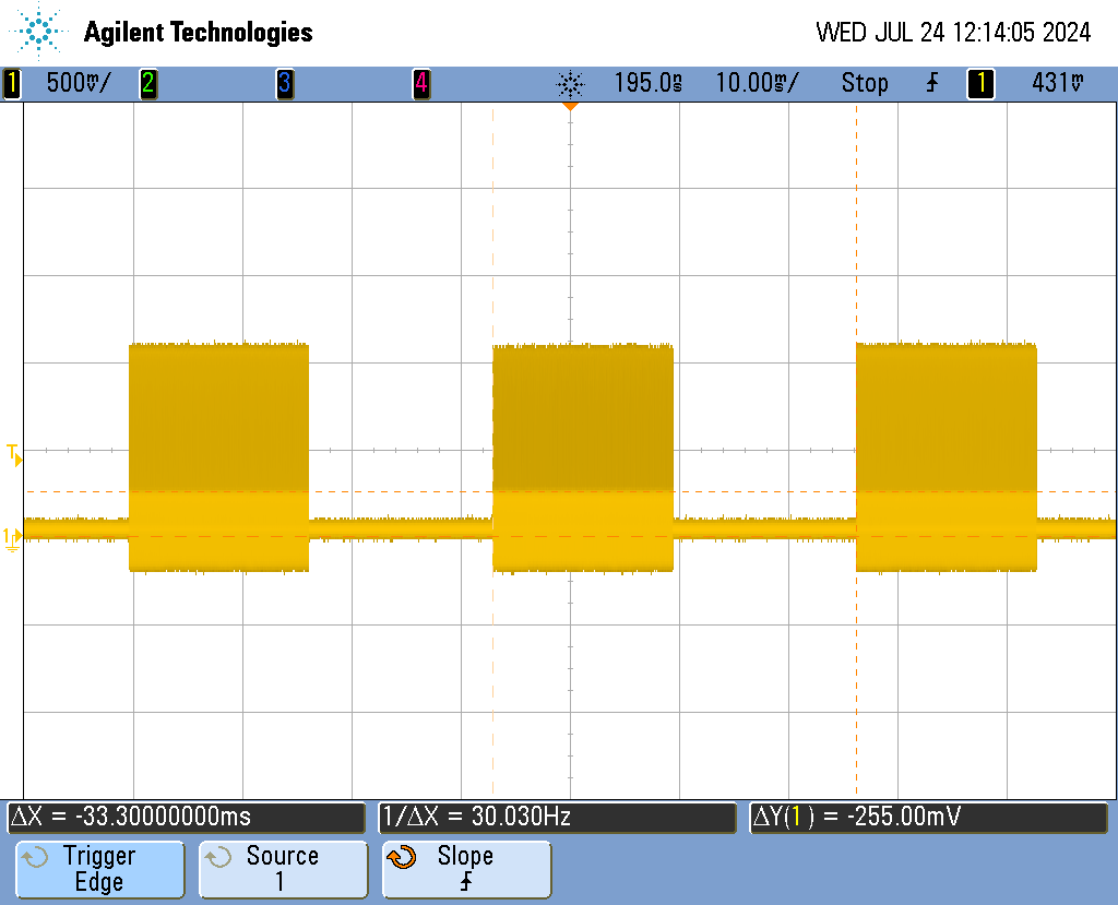

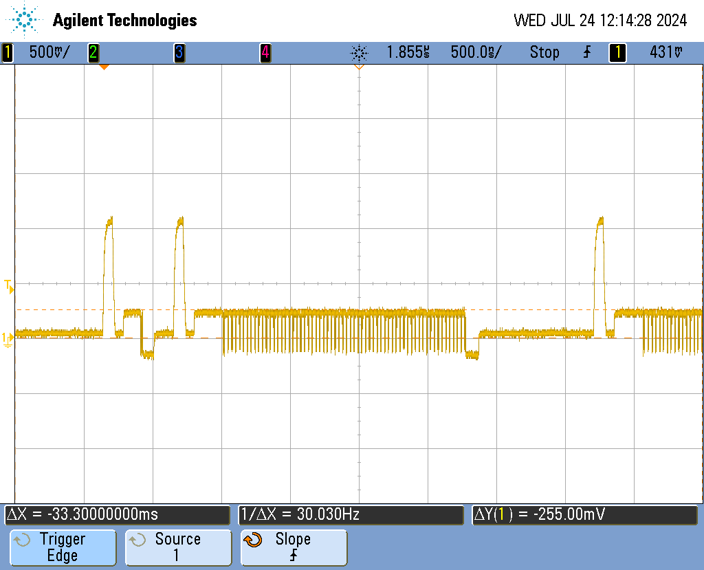

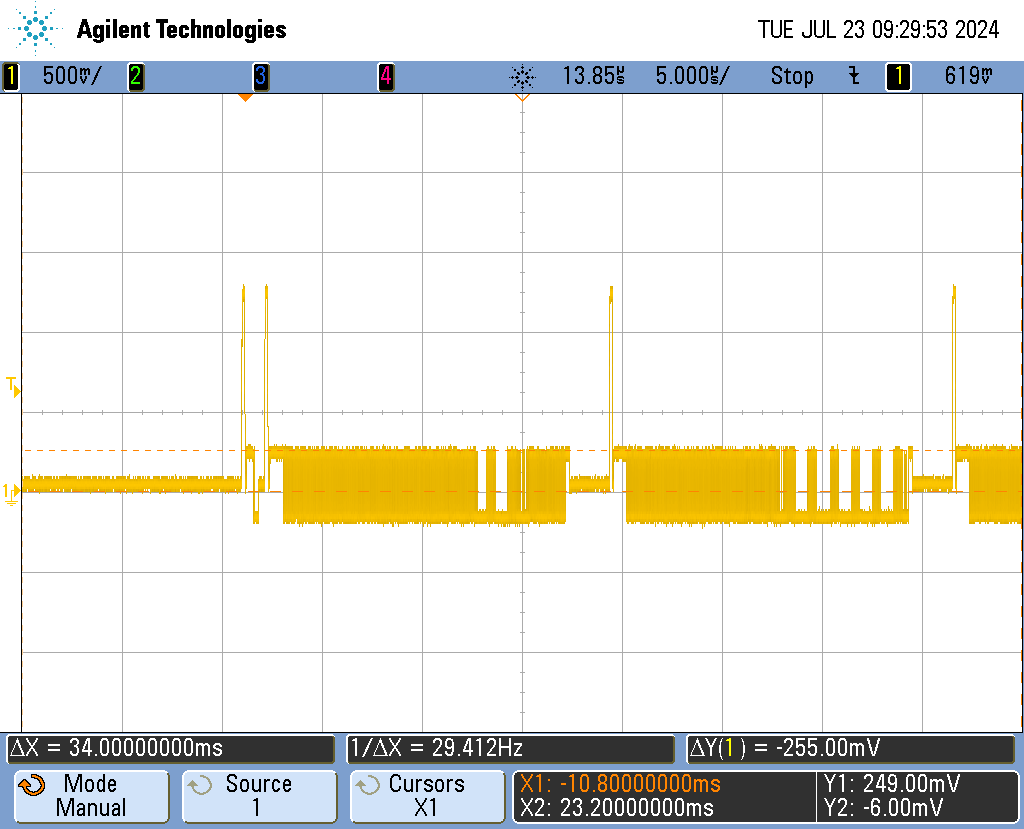

We are trying to connect a new sensor to our phytec AM62A board. What is the best way to debug this process? The sensor driver is created, and we see the video device in linux (visible with media-ctl and v4l2-ctl).
We have clock and data available on the CSI-2 lines, and those look ok, but when using v4l2-ctl -d 3 --stream-mmap we only get a frame rate of 0.2 fps instead of the 30 that we expect.
Is there a way to see what is going on underneath, whether packets are being discarded and if so, why, etc?

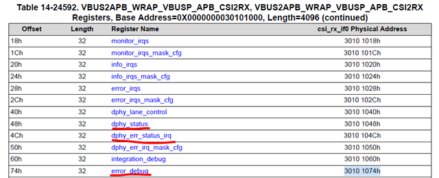

  • I have created a script that dumps the register space of the CSI2RX module:

    I get the following output for my new module:

  • When running my current driver (432 MHz line frequency, pixel clock of 144 MHz) the sensor sends 30 fps (verified with an osciloscope on the 4 lanes), and the DPHY has the following register values:
    DPHY_RX_CMN0_CMN_DIG_TBIT2 (0x30110020) =  0x00000429
    DPHY_RX_CMN0_CMN_DIG_TBIT10 (0x30110040) =  0x00800000
    DPHY_RX_CMN0_CMN_DIG_TBIT13 (0x3011004c) =  0x00000000
    DPHY_RX_CMN0_CMN_DIG_TBIT14 (0x30110050) =  0x00000000
    DPHY_RX_PCS_TX_DIG_TBIT0 (0x30110b00) =  0x000001CE
    DPHY_RX_PCS_TX_DIG_TBIT1 (0x30110b04) =  0x00000000
    DPHY_RX_PCS_TX_DIG_TBIT2 (0x30110b08) =  0xAAAAAAAA
    DPHY_RX_PCS_TX_DIG_TBIT3 (0x30110b0c) =  0x000000AA
    DPHY_ISO_DL_CTRL_L (0x30110c10) =  0x0000002D
    DPHY_ISO_DL_CTRL_L0 (0x30110c14) =  0x00000005
    DPHY_ISO_DL_CTRL_L1 (0x30110c20) =  0x0000000D
    DPHY_ISO_DL_CTRL_L2 (0x30110c30) =  0x0000000D
    DPHY_ISO_DL_CTRL_L3 (0x30110c3c) =  0x00000005
    DPHY_RX_lane (0x30111000) =  0xC0800000
    I believe bit 0 being set on DPHY_ISO_DL_CTRL_L* means that the lane is ready. Does this mean that the D-PHY detects data on those lanes?
    Why am I seeing different values for DPHY_ISO_DL_CTRL_L0/L3 and DPHY_ISO_DL_CTRL_L1/L2?
    What does bit 3 mean in those registers?
    Are bits 0-3 from those registers defined anywhere?
  • 432 MHz 3840x2160 @ 30 fps
    The frame start sequence
    Frame start with first data

    Can you check the error status registers in Table 14-24592. VBUS2APB_WRAP_VBUSP_APB_CSI2RX of the TRM from https://www.ti.com/product/AM62A7?
  • Can you check the error status registers in Table 14-24592. VBUS2APB_WRAP_VBUSP_APB_CSI2RX of the TRM from https://www.ti.com/product/AM62A7?
    dphy_status (0x30101048) =  0x00222206
    dphy_err_status_irq (0x3010104c) =  0x00000000
    error_debug (0x30101074) =  0x00000000
    I'm looking into the virtual channel and data ID, but those are not used for the onsemi sensors (at least in the two drivers that I've seen (ar0521 and ar0144).
