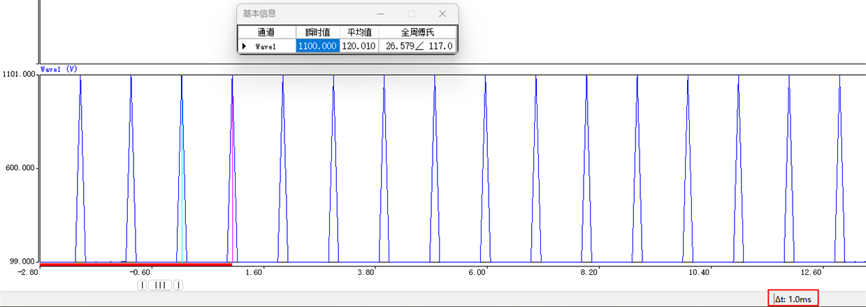

    I found that there would be abnormal values ​​of up to about 1100.

  • Hi Tushar,
    I have completed the test, and this change did not improve the problem. There is still an error period data of about 1ms.
    Wen

  • Hi Anil,
       I confirmed the modification of this part of the code again, and confirmed through break point debugging that this change has no effect on my measured results. I can still get abnormal values ​​of more than 1000us.
