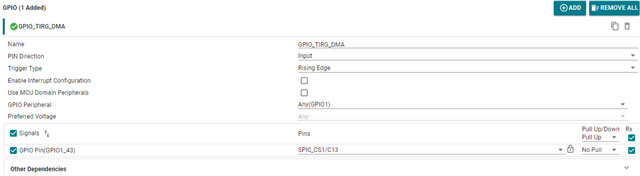

Follow the example project,   trigger DMA with the help of GPIO on AM64x devices.

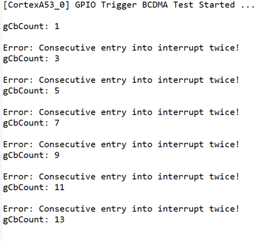

During the debugging process, it was found that a single change in GPIO level triggers two DMA interrupts.
After completing one conversion, refreshing the cache for DMA-related variate temporarily resolves this issue.
However, I cannot confirm that this approach addresses the issue comprehensively.
    In the FAQ example, I am routing GPIO Bank interrupt to GPIO MUX Router.
    So, it might be a chance on your customs board. There are some bank pins that are toggling due to these DMA triggers many times.
    To fix this issue, we need to route Pin interrupt rather than Bank interrupt.
    We need to change the below highlighted line to route Pin num to the GPIO Mux router.
    I am suspecting issue with the above one.
    Please confirm after changing the below fix  still you have the issue ?

  • I have tried the method you provided, but unfortunately, it hasn't resolved my issue. Below is my code. Could you please  help review it?

            if (gCbCount - last_gCbCount > 1)
                DebugP_log("Error: Consecutive entry into interrupt twice!\r\n");
            DebugP_log("gCbCount: %d\r\n", gCbCount);

  • Using a button to trigger (GPIO_43 on the EVM board), after the second activation, the behavior becomes abnormal.

  • 1. The GPIO configuration is as shown in the following diagram:
    2. Yes, it is currently running on the A53. I will provide the test results on the R5 later.
