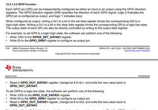

I applied pinctl with gpio0-0 pin in the device tree. I realized the control of gpio by manipulating the register as shown below. I would like to ask if GPIO pins, which are not described in the device tree, can be directly implemented by manipulating registers at the application layer?

    As Daolin mentioned, our GPIO expert is out of office, but I will provide my comments:
    Yes, the GPIO pins can be controlled directly by their registers. But please note that the GPIO DATA/DIR registers mentioned in your TRM screenshot are for controlling the GPIO input/output or high/low. Before you control these, please ensure the GPIO pin padconfig registers are set properly to put the pin in GPIO mode.
  • Hello, I would like to configure mcu_gpio0-0 to gpio mode. Which other registers do I need to configure? Do I still need to configure ctrl-MMR register, power register, and clock register in TRM 14.2?
    Configuring GPIO mode is done through kernel device tree, but not directly modifying registers.

    To define MCU GPIO via device tree, see below:
    diff --git a/arch/arm64/boot/dts/ti/k3-am62x-sk-common.dtsi b/arch/arm64/boot/dts/ti/k3-am62x-sk-common.dtsi
    index b1980b85c..d6794153f 100644
    --- a/arch/arm64/boot/dts/ti/k3-am62x-sk-common.dtsi
    +++ b/arch/arm64/boot/dts/ti/k3-am62x-sk-common.dtsi
    @@ -329,6 +329,15 @@ AM62X_IOPAD(0x0078, PIN_OUTPUT, 1) /* (U24) GPMC0_AD15.VOUT0_DATA23 */
    +&mcu_pmx0 {
    +    mcugpio0_pins_default: mcugpio0-default-pins {
    +        pinctrl-single,pins = <
    +            AM62X_MCU_IOPAD(0x003c, PIN_INPUT, 7) /* (E5) MCU_MCAN1_TX.MCU_GPIO0_15 */
    +            AM62X_MCU_IOPAD(0x0040, PIN_INPUT, 7) /* (D4) MCU_MCAN1_RX.MCU_GPIO0_16 */
     &wkup_uart0 {
         /* WKUP UART0 is used by DM firmware */
         status = "reserved";
    @@ -578,11 +587,12 @@ dpi1_out: endpoint {
    -/* mcu_gpio0 and mcu_gpio_intr are reserved for mcu firmware usage */
     &mcu_gpio0 {
    -    status = "reserved";
    +    status = "okay";
    +    pinctrl-names = "default";
    +    pinctrl-0 = <&mcugpio0_pins_default>;
     &mcu_gpio_intr {
    +    status = "okay";
    Then the GPIO can be toggled from Linux Command Line as shown in this FAQ: https://e2e.ti.com/support/processors-group/processors/f/processors-forum/1260373/faq-transitioning-the-gpio-userspace-interface-from-sysfs-to-chardev
