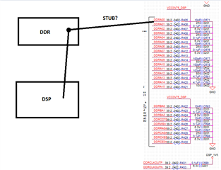

TMS320C6655: Routing Rules – Address and Command Lines (SDRAMs) - Stub between term resistors to DDR and DSP
Part Number: TMS320C6655
Hi Experts,

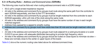

per document: DDR3 Design Requirements for KeyStone Devices.pdf
There is a request to keep stubs less than 80mils between Fly-by group of address and command signals.
If a DDR routes to a DSP and also to term resistors, does the routing to term resistor count as a stub?
find the examples below:
  • Yes - but I don't think its expected to be included in the highlighted recommendation.  The stubs to the memory devices have capacitive loading and create reflections.  The stub to the termination point affects the waveform differently.  I would still recommend trying to minimize the stub lengths to the termination.
