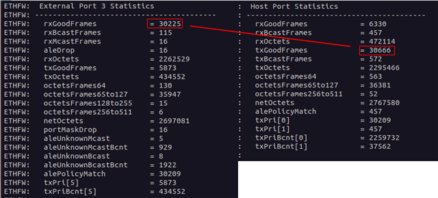

    I have done an additional experiment regarding this issue :
    - Sending UDP frames to a client
    - Pause the client (I also tried to pause both the server and the client)
    - Analyse with Wireshark for pause frames (no pause frame seen)
    -Analyse the statistics printed by the server :
    It seems like, the Host port still proceed to send data despite having a destination, because FIFO transfert the same amount of frames between Rx FIFO and Tx FIFO. So the Tx FIFO pursue to send data and doesn't pile up and that why there is no pause frame. So we loose packet and that is an issue.
    Is this comportement normal ? I thought that if DMA has no where to send packet, it doesn't send them...
    Can you please confirm on your side this comportement ?
    Matthias
    I think it may crate Top of FIFO Drops not pause frames.
    Sudheer
  •  Hello,
    Yes, there is a little difference of trames numbers surely due to other client (like the A72). But in other ports there is no significant action compared to the number of frames sent from port 3 to client.
    But the issue is regarding the lost of the large number of frames from the switch CPSW9g to the client.
    The statistic table show the number of Top of FIFO Drops if it's different from zero but in our case it is not shown so there is no Top of FIFO Drops in the stat.
    In the experiment, the client is stopped so it can no longer receive frames. So the number of Host port TxGoodFrame counter should stop but it's not the case, the Host continu to send frames to a stopped client. So that why there is no pause frame and no Top of FIFO drops.
    How can we proceed in order to stop the Host port from sending frames to a dead end ?

    Until Host Port find the free descriptors it will send the packets to the client. If packets received belongs to client MAC address.
    Yes, that what I think too but I don't understand how the packets are lost between host port and the client...
    Here are the statistics for broadcast frames with all the cores stopped. The comportement stay the same.
    Thanks for your time.
    Can you confirm, are you still sending the Broadcast frames even after all cores stopped. If so, you would have observed some error frames on the Broadcast receive port. Can you please dump other active Ports statistics as well.
    Sudheer
    Yes I sent Broadcast frames when all cores were stopped, and I confirmed it with Wireshark, but I find it weird too that the switch is unphased. Even in Unicast there is no error.
    Other ports aren't used, Statistics are empty.
    Matthias
    As cores are halted, and you are sending some frames..
    After few frames sending, have you stopped sending frames & ran core and check the statistics. As above cores are halted, you many not get the updated statistics.
    Sudheer
    My protocol is :
    1.  Start all cores with bootloader with SD card. It contain the app and they are linked to the right core.
    2.  When the network finish it init and the network is stable I stop all the cores.
    3.  I send on port 3, 37 000 Multicast messages.
    4. Once all the messages are sent, I start the cores.
    5. The mcu2_0 write on logs the statistics of the switch I have shown before.
    The result : frames are sent from the switch even if the cores are stopped.
    This is an issue so if you have more information on your side, I'm eager to know your thought.
    Matthias
    During core Halt, CPSW switch is still active and it can forward the packets to other ports.
    But, not to Host Port if packets intended core is halted (ex. packet are sending to MCU2_0 and MCU2_0 is halt) after all available DMA descriptors are used.
    Also, can you please confirm the Multicast packets are intended to any of core? Have you verified ALE table?
    Also, can you check on Wireshark side, whether CPSW is sending nay pause frames or not at sender side? Ideally drops should be expected if not controlling the flow would result in sending pause frames.
    Let me check internally with H/W, how to trigger pause frames from CPSW and update you soon.
    Sudheer
    Indeed, host shouldn't send the data because there is no destination. I'm sure I have stopped them because they are not responding in any way. And on Wireshark the data are sent but no responses, that is normal because the are stopped. The switch keep sending despite that and that's why there is no pause frame, because the FIFO stay empty.
    Did you get more information on your side ?
    Matthias
    When cores are stopped, FIFO should get overflow and observe drops in ports.
    But in your log we could not see any drop statistics.
    If no drops ideally pause frame should sent.
    What is the use case for flow control in your system.
    Sudheer
    Indeed, there is no drop statistics, no pause frame statistics, and the statistics say all frames are sent despite having no destination.
    In our system frames are very important, so we need to have no data drop. The Pause frame tenet response to our need, so we would very much like it to work.
    Matthias
    It look very odd.
    Ideally we should observe FIFO drops when no core is reading the data from the Host Port.
    When Host Port FIFO is empty, there could not be any data movement from external port FIFO to Host port, ideally in this scenario pause frame should sent from external port to avoid drops.
