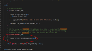

  • How to remove Broadcast ALE entry?
    I understand that adding POLICER is equivalent to whitelisting. If I zeroed out the port that I do not want to receive ARP packets and assigned the value to dstMacAddrInfo.portNum,
    Is the corresponding port unable to receive ARP broadcasts?
    You can comment  below from ethfw.c file.

  • we need to remove Broadcast ALE entry
    I turned off the broadcast on some ports through portMask.
    The port cannot send broadcasts but can receive broadcasts.
    How do I discard broadcast packets received by CPSW9G?
    We can't stop packets receiving.
    Once packet is received and no ALE match then packet can be dropped. But, we have Broadcast ALE entry so as per port mask packet will be sent out on other ports.
