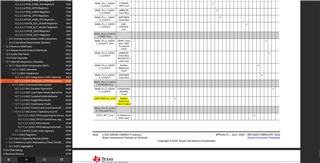

  • Hi Takuma,
    As we observed the given link suggesting to configure clock ouput on PCIE_REFCLK1_P/N_OUT pins and not on SERDES0_REFCLK_P/N pins.
    We have the similar HW configurations as TIDEP-01022 but there is no sdk available for J7VCL_EVM_200110.
    Kindly guide us to configure clock ouput on SERDES0_REFCLK_P/N.

  • Hi Nikhil,
    It is recommended to use PCIE_REFCLK1_P/N_OUT instead of SERDES0_REFCLK_P/N for PCIe reference clock, mainly because of errata i2237: https://www.ti.com/lit/er/sprz491d/sprz491d.pdf.
    However, assuming the workarounds are applied, in software the clocks are selected in device tree in this node: https://git.ti.com/cgit/ti-linux-kernel/ti-linux-kernel/tree/arch/arm64/boot/dts/ti/k3-j7200-main.dtsi?h=ti-linux-6.1.y#n676.
    For SERDES clock, SERDES must get initialized correctly for it to send a clock unlike an external clock generator that generates a 100MHz regardless of software. So, could you post the full "dmesg" logs so that I can review if there are issues with module/clock initialization?

  • Hi Takuma,
    In DRA821 processor there is no PCIE_REFCLK1_P/N_OUT pins present, so we configured SERDES0_REFCLK_P/N pin as ouput.
    We will go through the errata workarounds and SW worarounds shared, also find the dmesg log in for review.

    In TRM its mentioned that eDP0 REFCLK is serdes output clock.
    Kindly guide us how to enable this clock output
    Nikhil
  • Hi Nikhil,
    eDP, USB, and PCIe all share the same SERDES module, and therefore, the same reference clock.
    Takuma
