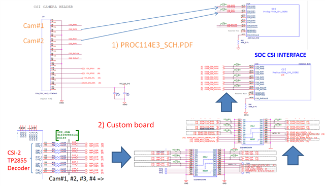

As in the attached "Enable_4Camera_WithTP2855.pdf", the connection interfaces are:
1) Camera [4 Cameras , NTSC format] connects to TP2855 via VIN1N, VIN2N, VIN3N, , VIN4N channel
2) TP2855 decodes each input channel to MIPI_D0P/N ,MIPI_D1P/N, MIPI_D2P/N, and MIPI_D3P/N respectively.
3) TP2855 to AM62x CSI-2
MIPI_D0P/N connects to AM62x CSI-2 [EDGE_CSI0_RXP0, EDGE_CSI0_RXN0]
MIPI_D1P/N connects to AM62x CSI-2 [EDGE_CSI0_RXP1, EDGE_CSI0_RXN1]
MIPI_D1P/N connects to AM62x CSI-2 [EDGE_CSI0_RXP2, EDGE_CSI0_RXN2]
MIPI_D1P/N connects to AM62x CSI-2 [EDGE_CSI0_RXP3, EDGE_CSI0_RXN3]
We need to define device tree for 3) to get it work. Please help.

I attached our HW schematic (TP2855 connection interfaces with AM62x SOC, tp2855_am62x.pdf) again.
Since AM62x CSI-2 has 4 lanes, we want to assign each lance per camera, which their connection interfaces are described in 3) previousely.
"Does it multiplex the data from 4 cameras and transmit to AM62x via the CSI interface?"
=> No, the 4 cameras input (analog) will pass throught TP2855 with diff channels, and TP2855 decodes each camera input saperatly and outputs (digital) them to 4 saperated diff lances (one lane per one camera) to CSI-2 of AM62x.
Our archecture is similiar to: https://e2e.ti.com/support/sensors-group/sensors/f/sensors-forum/833182/awr1243-mipi-csi2-format-of-4-lane-from-awr1243
"this case where each data lane is used for a separate sensor is not supported on AM62x."
=> AM62x support only one camera using 4-lane? if we use multiple cameras, we must multiplex the cameras? If so, please provide technical guide how to make it work. Thanks.

1) Our custom board design, we refer to E3 HW schematic.
In E3 (J19), we see two cameras are connected. There is an external CSI-2 aggregating component to combine the two camera output streams and send out an interleaved CSI-2 stream to AM62x's SOC CSI-2?
Originally we thought there is a pin-to-pin between a camera to soc' CSI-2 lane.
2) In our case, suppose that the TP2855 decoder chip could output an interleaved CSI-2 stream of 4 cameras (TP2855 acts as xternal CSI-2 aggregating component), May you guide device tree nodes in order to view the 4 cameras saperatly at AM62x? Thanks.

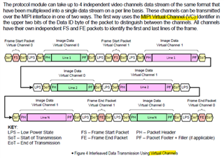

Yes, that's correct.
If the TP2855 uses virtual channels to send multiplexed (interleaved) 4 CSI-2 camera streams, this should work. Please refer to the ds90ub960.c and imx219 dtso files I provided earlier.
