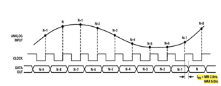

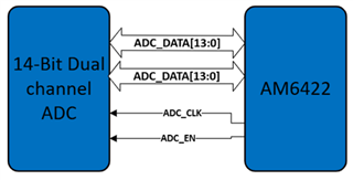

I am currently evaluating the AM6422 for an upcoming project that has hard real-time requirements. Specifically, we need to read 28 GPIO lines within a 50-nanosecond time frame. I have the following queries regarding the GPIO Read write timing
  1. How many clock cycles are required to read a single GPIO line on the AM6422?
  2. Is there an option to read all GPIO lines at once in parallel? If so, how many clock cycles would it require to read all 28 GPIO lines simultaneously?
  3. Considering the above factors, is it feasible to achieve the 50ns timing requirement using the AM6422 for reading the 28 GPIO lines?
