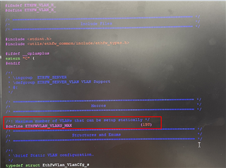

Hi TI experts,
We are using tda4vh SDK0902 for Ethernet adaptation work. The code uses a macro ETHFWVLAN_VLANS_MAX to limit the maximum number of VLANs supported by it to 10. If we modify the definition of the macro to achieve the goal of configurating more VLANs, the Ethernet function will behave abnormally. How can we expand the number of VLANs supported by it without affecting orther functions?
Xue
    You have to update the value of  "ETHFWVLAN_VLANS_MAX".
    Can you please share details about what problems you are facing, when you increase the above macro value?
    Sudheer
  • I increased the macro value from 10 to 15 and conducted the Ethernet function test under the condition of configuring 13 VLANs. The test environment was set up by connecting a laptop to the board. When the laptop pings the board, communication can be intermittently successful (with interruptions during the communication process). However, the board is never able to successfully ping the laptop. On the other hand, when 9 VLANs are set, both sides can successfully ping each other.
    Xue
    Can you please share ETHFW Log?
    Have you observe any error while adding policers? As the no.of available policers are limited to 55.
    Also, are trying to ping A72 Linux client from Laptop or EthFw Server?
    Sudheer
  • ETHFW日志.docx
    the log information is provided in the file, but I didn't see any error message from the alarm system. Currently, we are trying to ping the A72 Linux client from the laptop. However, after configuring 13 VLANs, the laptop can only intermittently ping the board, while the board cannot ping the laptop at all.
    Xue
    I could not not see any error prints from ETHFW, also only 9 VLANs only configured in the log.
    Also, I could see Ports are Link Down from Logs except Port-8.
    Can you please share the log with 13 VLANs,
    Also, can you please dump the ALE and Policer entries by following the patch in FAQ and share with us.

    I tested in the scenario of configuring 13 VLANs on the board and used Port-3 for testing, and the log content is attached.
    The content shown in the picture is a case of intermittent communication success, and the prerequisite for successful communication is that the laptop ping board is successful.
    I have also tried to obtain the ALE and police entries you mentioned, but were unsuccessful, so I can only provide you with the screenshots of the ping process and logs.
    Are you observing the Link Up and Link Down on Port-3 continuously. If so, there is a possibility for the fail and success of ping.
    I could observe this from the logs shared above.
    Also, can you please share me the "ifconfig" command data/information of A72 and test PC side.
    Sudheer
    According to observation, both ends are linked.
    The "ifconfig" command data of A72 is shown in the first picture, and that of the test PC side is shown in the second picture.

    We add 13VLANs configuration by EthFwVlan_VlanCfg gEthApp_vlanCfg in the file app_ethfw_freertos.c. At the same time, we also modify the macro "ETHFWVLAN_VLANS_MAX" to 15U.
    Xue

    How you have joined for VLAN from Linux client to ETHFW?
    I think Linux cpsw-proxy-client driver doesn't support the VLAN functionality.
    May I ask if you can ping your laptop normally while setting up 13 VLANs? Is there any new progress?
    I have tried non VLAN ping with ETHFW Server & Linux virtual switch client, It was working as expected and could not see any issue.
    Sudheer
    We implement this funcation like the picture below.
    We need to set up VLAN and the number of VLANs exceeds 10. Could you please test it?
    Xue
    Can you please share whole ETHFW logs? Also, can you please share ALE & Policer dump by following the patch in FAQ
    There are limited no.of policers, due to which you can't add more policers.
    Please refer to partition of policers entries from "gEthFw_policeerTablePartSize" from ethfw_api.c file.
    Partition-1 is for VEPA (High Priority) at top of policer entries -> 10 entries reserved.
    Parititon-2 is for QOS, Custom Policers by clients -> 20 entries reserved.
    Parititon-3 is for MAC Only Ports -> 10 entries reserved.
    Partition-4 is for general entries > 55
    So, only 55 policers can only be allowed. beyond the request will result in failure of adding policers.

    What modifications have you made to the RTOS code? Could you provide me with an explanatory file or screenshots?
    Xue
  • HI,
    I have not modified the code. I have updated VLAN ALE table using GEL scripts in SDK.

    I modified the RTOS code to add VLANs to the ALE table. When I increased the value of the macro to 20, it seemed that I had successfully added the VLANs to the ALE table. The result of using the corresponding function to dump the ALE table is shown in the figure.
    But once the number of newly added VLANs exceeds 9, the communication situation at both ends will be as described earlier.
    Do you have any thoughts on the causes of this problem? I also notice that in the RTOS0900's code, there are also related settings for the policer after the code of adding VLANs to the ALE table. If the policer code is not implemented, will it affect the process of the communication?

    When I set 8 VLANs and 13 VLANs separately, the policer table entries are the same, as shown in the figure.
    RTOS0900 sets a policer for each newly added static VLAN in a for loop, but the implementation of 0902 feels different. It still seems like setting a policer to bind MAC address and VLAN. Is it true that the implementation of RTOS0902 adding a policer entry to VLAN has changed?
