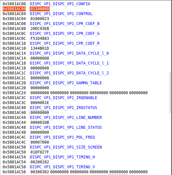

I changed the values by referring to TRM, but there was no change in the video.
Can I just change the values?
Kim
Hi
We are outputting progressive 640x480 BT656 Progressive format output from the camera to the LCD.
The LCD setting is set to Interlace and we are testing it.
devmem2 0x3020b000 w 0x01500000
We are proceeding with the AM62A register setting value, and the screen appears as below.
There was no change in the output even after applying the value.
If the LCD setting is set to Progressive, it appears as in the image below.
Is there anything else I need to set up?

It appears that the config register is a shadow register and you need to configure the go bit. I am wondering if you set the gobit after configuring to progressive mode.
Krunal
devmem2 0x3020b004 w 0x01000002
devmem2 0x3020b004 w 0x01000023
As above, gobit is set at the end.
Are the above settings wrong?

However, I confirmed that vdisplay (height) is halved when setting interlace in other soc (tda series) rtos settings.
The relevant registers are as follows.
devmem2 0x3020b050 w 0x00EF027F
I confirmed that the vdisplay value in panel-simple.c affects the SCREEN_SIZE register in tidss_dispc.c.
However, when the panel-simple vdisplay value was set to 240, the drm connector and crtc values were also set to 240. So, outputting to 480 was not possible.
I also want to know how to set it to 480 and output it.
