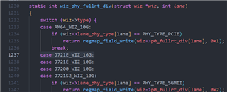

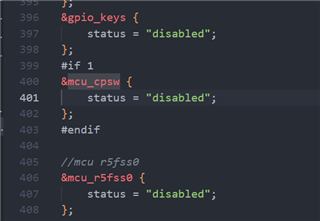

We need to use the CPSW9G of TDA4 on the linux side of the A72 to connect to the phy chip, the connection mode is SGMII mode, the connection configuration is as follows:
serdes0-lane0: rtl9010-1 (sgmii)
serdes0-lane1: rtl9010-2 (sgmii)
serdes0-lane0: rtl9010-3 (sgmii)
We refer to the file ti/k3-j721e-quad-port-eth-exp.dtbo and modify our own device tree file, after system startup, the phy driver can match the phy device, but the link fails, reporting error: am65-cpsw-nuss c000000.ethernet eth1. validation of sgmii with support 00000000,00000000,000062c0 and advertisement 00000000,00000000,000022c0 failed: -EINVAL
The following is the system startup log, and please help to analyze the cause of this error
Thank you very much!
