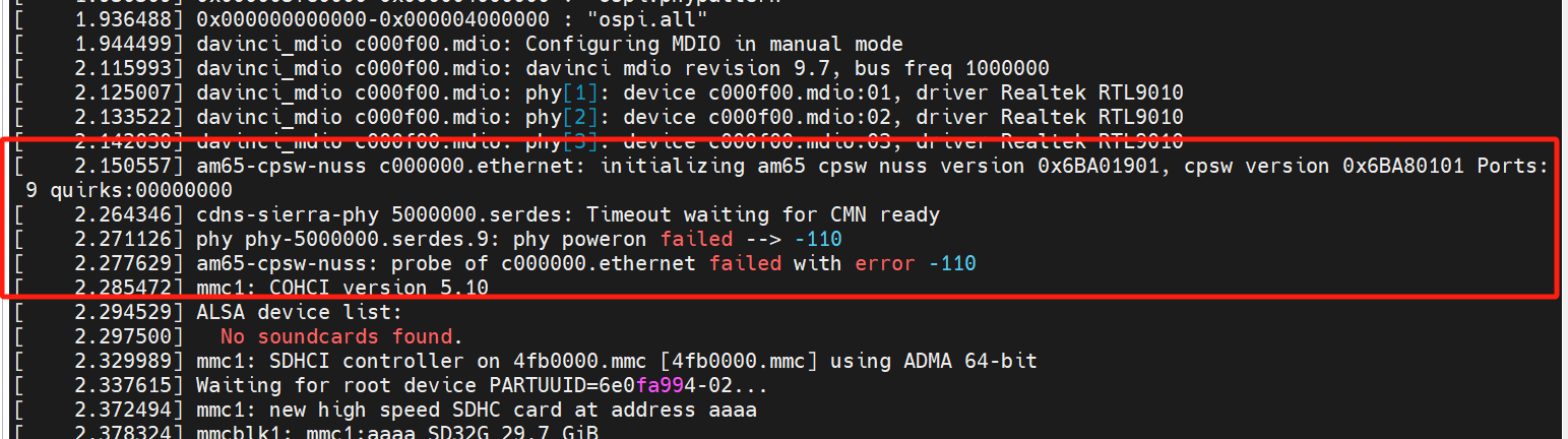

TDA4VM: Using TDA4's CPSW9G, connecting to phy chip, link fails.
Part Number: TDA4VM
HI:
I apologize for needing your help in answering my question.
We need to use the CPSW9G of TDA4 on the linux side of the A72 to connect to the phy chip, the connection mode is SGMII mode, the connection configuration is as follows:
serdes0-lane0: rtl9010-1 (sgmii)
serdes0-lane1: rtl9010-2 (sgmii)
serdes0-lane0: rtl9010-3 (sgmii)
We refer to the file ti/k3-j721e-quad-port-eth-exp.dtbo and modify our own device tree file, after system startup, the phy driver can match the phy device, but the link fails, reporting error: am65-cpsw-nuss c000000.ethernet eth1. validation of sgmii with support 00000000,00000000,000062c0 and advertisement 00000000,00000000,000022c0 failed: -EINVAL
The following is the system startup log, and please help to analyze the cause of this error
Thank you very much!

  • Hi Siddharth
    I have updated serdes0,running “ifconfig -a” still don`t have any eth port:
    This is kernel boot log:

    [    1.944499] davinci_mdio c000f00.mdio: Configuring MDIO in manual mode
    [    2.115993] davinci_mdio c000f00.mdio: davinci mdio revision 9.7, bus freq 1000000
    [    2.125007] davinci_mdio c000f00.mdio: phy[1]: device c000f00.mdio:01, driver Realtek RTL9010
    [    2.133522] davinci_mdio c000f00.mdio: phy[2]: device c000f00.mdio:02, driver Realtek RTL9010
    [    2.142030] davinci_mdio c000f00.mdio: phy[3]: device c000f00.mdio:03, driver Realtek RTL9010
    [    2.150557] am65-cpsw-nuss c000000.ethernet: initializing am65 cpsw nuss version 0x6BA01901, cpsw version 0x6BA80101 Ports: 9 quirks:00000000
    [    2.264346] cdns-sierra-phy 5000000.serdes: Timeout waiting for CMN ready
    [    2.271126] phy phy-5000000.serdes.9: phy poweron failed --> -110
    [    2.277629] am65-cpsw-nuss: probe of c000000.ethernet failed with error -110

    There are still some errors about serdes  in the kernel's  boot logs:
  • Could you share the device-tree files?
    I don't see the error that you are referring to, with the device-tree changes I referred to earlier, on the J721E-EVM.
    Also, the value of 0x0500E000 on the J721E-EVM in my local setup is:
    0x00002435
    I'm sorry that due to our computer limitations, i can't upload "dts" or "dtsi" files directly, so I'll have to change the file extension to “txt” to share it with you!
    "invo-k3-j721e-vision-apps.dtsi" is the device-tree file of  our board
    // SPDX-License-Identifier: GPL-2.0
     * vision-apps: device-tree overlay
     * Copyright (C) 2019 - 2021 Texas Instruments Incorporated - http://www.ti.com/
    #include "invo-k3-j721e-rtos-memory-map.dtsi"
    #include "devicetree.dtsi"
    #include <dt-bindings/mux/ti-serdes.h>
    #include <dt-bindings/phy/phy.h>
    #include <dt-bindings/phy/phy-cadence.h>
    #include "k3-pinctrl.h"
    #include <dt-bindings/gpio/gpio.h>
    	aliases {
    		ethernet1 = "/bus@100000/ethernet@c000000/ethernet-ports/port@1";
    		ethernet2 = "/bus@100000/ethernet@c000000/ethernet-ports/port@2";
    		ethernet3 = "/bus@100000/ethernet@c000000/ethernet-ports/port@3";
    		//ethernet4 = "/bus@100000/ethernet@c000000/ethernet-ports/port@4";
    #if 0
    	gpio_rst {
    		#gpio-cells = <2>;
    		compatible = "phy-rst-gpio";
    		pinctrl-names = "default";
    		pinctrl-0 = <&mygpio0_pins_default>;
    		rst-gpio = <&main_gpio0 2 GPIO_ACTIVE_LOW>, <&main_gpio0 7 GPIO_ACTIVE_LOW>, <&main_gpio0 10 GPIO_ACTIVE_LOW>;
    		status = "okay";
    #endif
    &cmn_refclk1 {
    	status = "okay";
    	clock-frequency = <100000000>;
    &cpsw0 {
    	status = "okay";
    &cpsw0_port1 {
    	status = "okay";
    	phy-handle = <&cpsw9g_phy0>;
    	phy-mode = "sgmii";
    	mac-address = [00 00 00 00 00 00];
    	phys = <&cpsw0_phy_gmii_sel 1>, <&serdes0_qsgmii_link>;
    	phy-names = "mac", "serdes";
    &cpsw0_port2 {
    	status = "okay";
    	phy-handle = <&cpsw9g_phy1>;
    	phy-mode = "sgmii";
    	phys = <&cpsw0_phy_gmii_sel 2>;
    	phy-names = "mac";
    &cpsw0_port3 {
    	status = "okay";
    	phy-handle = <&cpsw9g_phy2>;
    	phy-mode = "sgmii";
    	phys = <&cpsw0_phy_gmii_sel 3>, <&serdes1_qsgmii_link>;
    	phy-names = "mac","serdes";
    &cpsw9g_mdio {
    	status = "okay";
    	pinctrl-0 = <&mymdio1_pins_default>;
    //	reset-gpios = <&exp2 17 GPIO_ACTIVE_LOW>;
        reset-gpios = <&main_gpio0 7 GPIO_ACTIVE_LOW>, <&main_gpio0 10 GPIO_ACTIVE_LOW>, <&main_gpio0 2 GPIO_ACTIVE_LOW>;
    	// reset-delay-us = <20>;
    	reset-post-delay-us = <120000>;
    	#address-cells = <1>;
    	#size-cells = <0>;
    	cpsw9g_phy0: ethernet-phy@2 {
    		compatible = "rtk,rtl9010","ethernet-phy-ieee802.3-c22";
    		reg = <2>;
    		// ethphy-mode = "master";
    		// ethphy-speed = <1000>;
    		//reset-gpios = <&main_gpio0 2 GPIO_ACTIVE_LOW>;
    		// ti,rx-internal-delay = <DP83867_RGMIIDCTL_2_00_NS>;
            // ti,fifo-depth = <DP83867_PHYCR_FIFO_DEPTH_4_B_NIB>;
    		// ti,min-output-impedance;
    	cpsw9g_phy1: ethernet-phy@3 {
    		reg = <3>;
    		//reset-gpios = <&main_gpio0 7 GPIO_ACTIVE_LOW>;
    	cpsw9g_phy2: ethernet-phy@1 {
    //		compatible = "rtk,rtl9010","ethernet-phy-ieee802.3-c22";
    		reg = <1>;
    		//reset-gpios = <&main_gpio0 10 GPIO_ACTIVE_LOW>;
    &serdes_ln_ctrl {
    	idle-states = <J721E_SERDES0_LANE0_QSGMII_LANE1>, <J721E_SERDES0_LANE1_QSGMII_LANE2>,
    				<J721E_SERDES1_LANE0_QSGMII_LANE3>, <J721E_SERDES1_LANE1_QSGMII_LANE4>,
    				<J721E_SERDES2_LANE0_IP1_UNUSED>, <J721E_SERDES2_LANE1_IP1_UNUSED>,
    				<J721E_SERDES3_LANE0_IP4_UNUSED>, <J721E_SERDES3_LANE1_IP4_UNUSED>,
    				<J721E_SERDES4_LANE0_IP4_UNUSED>, <J721E_SERDES4_LANE1_IP4_UNUSED>,
    				<J721E_SERDES4_LANE2_IP4_UNUSED>, <J721E_SERDES4_LANE3_IP4_UNUSED>;
    // &cmn_refclk {
    // 	status = "okay";
    // 	clock-frequency = <100000000>;
    &wiz0_pll1_refclk {
    	assigned-clocks = <&wiz0_pll1_refclk>;
    	assigned-clock-parents = <&cmn_refclk1>;
    &wiz0_refclk_dig {
    	assigned-clocks = <&wiz0_refclk_dig>;
    &wiz1_pll1_refclk {
    	assigned-clocks = <&wiz1_pll1_refclk>;
    &wiz1_refclk_dig {
    	assigned-clocks = <&wiz1_refclk_dig>;
    &serdes_wiz0 {
    	status = "okay";
    &serdes_wiz1 {
    	status = "okay";
    &serdes0 {
    	status = "okay";
    	assigned-clocks = <&serdes0 CDNS_SIERRA_PLL_CMNLC>;
    	assigned-clock-parents = <&wiz0_pll0_refclk>;
    	#size-cells = <0>;
    	serdes0_qsgmii_link: phy@0 {
    		reg = <0>;
    		cdns,num-lanes = <2>;
    		#phy-cells = <0>;
    		cdns,phy-type = <PHY_TYPE_SGMII>;
    		resets = <&serdes_wiz0 1>, <&serdes_wiz0 2>;
    &serdes1 {
    	status = "okay";
    	assigned-clocks = <&serdes1 CDNS_SIERRA_PLL_CMNLC>;
    	assigned-clock-parents = <&wiz1_pll0_refclk>;
    	// assigned-clock-parents = <&wiz1_pll0_refclk>, <&wiz1_pll1_refclk>;
    	#size-cells = <0>;
    	serdes1_qsgmii_link: phy@1 {
    		reg = <0>;
    		cdns,num-lanes = <1>;
    		#phy-cells = <0>;
    		resets = <&serdes_wiz1 1>;
    #if 0
    &main_r5fss0_core0_shared_memory_queue_region {
    	status = "disabled";
    &main_r5fss0_core0_shared_memory_bufpool_region {
    #endif
    &serdes_wiz2 {
    &serdes_wiz3 {
    &serdes_wiz4 {
    &serdes2 {
    &serdes3 {
    &mhdp {
    &dss {
    &ti_csi2rx0 {
    &ti_csi2rx1 {
    #if 0
    &d5520 {
    &vxe384 {
    #endif
    /* new add */
    &pcie0_rc {
    &pcie1_rc {
    &pcie2_rc {
    &main_uart1 {
    &main_uart4 {
    &main_uart6 {
    &pru0_0{
    &rtu0_0{
    &tx_pru0_0{
    &pru0_1{
    &rtu0_1{
    &tx_pru0_1{
    &pru1_0{
    &rtu1_0{
    &tx_pru1_0{
    &pru1_1{
    &rtu1_1{
    &tx_pru1_1{
    &ufs_wrapper{
    &pcm3168a_1{

  • Hi Siddharth,
    this is the hardware connection diagram:
    P2 phy_addr:2
    p0 phy_addr:3
    p1 phy_addr:1
    CPSW configuration is not available in above device tree files, if it was overlay you need to add it to  "name_overlays".
    Also, can you please check if ETHFW is enabled in MCU2_0 or not. share below log.

  • Hi Doredla,
    The current problem we are experiencing is that if we add the phy_name attributes “mac”, “serdes” to the cpsw_port node in dts file, all eth network interfaces fail to be generated。
    And print the following error in the kernel's boot log:
    When we didn`t add the phy_name attributes “mac”, “serdes” to the cpsw_port node in dts file, All eth ports can be generated normally, and the status of phy is “link up”. but I can't ping other devices, and the status of CPSW and serdes registers are not normal.
        7.061044] am65-cpsw-nuss c000000.ethernet eth2: PHY [c000f00.mdio:01] driver [Realtek RTL9010] (irq=POLL)
    [    7.081304] am65-cpsw-nuss c000000.ethernet eth2: configuring for phy/sgmii link mode

    Can you add phy-names as below and check once.
    "phy-names = "portmode", "serdes-phy";"
    Sudheer

  • HI,
    From SGMII status register & SerDes Registers it seems like SERDES PLL is not locked.
    Please refer to below info for enabling SGMII on Sierra 2L SerDes, and check whether all changes are taken care or not.
    1. Update the SGMII support from Sierra SerDes.
    7462.0001-phy-cadence-Sierra-Add-Single-link-SGMII-PHY-configu.patch
    2. U-Boot is configuring the SerDes in PCIe + QSGMII configuration.
    Due to this, since the SerDes has already been configured in U-Boot, the Linux SerDes driver will not configure the SerDes for the desired SGMII mode.
    When building U-Boot (u-boot.img), please ensure that the following configs are disabled:
    CONFIG_PHY_CADENCE_SIERRA=n
    CONFIG_PHY_J721E_WIZ=n
    In order to ensure that U-Boot is not configuring the SerDes.
    3. Additionally, with the SDK, the Sierra driver which configures the SerDes supports "PCIe + SGMII" multilink configuration only. Therefore, with the default SDK, please modify the existing SerDes node to below.
    a) for 2 SGMII Ports:
    The serdes0 device-tree node has to be modified to:
    &serdes0 {
        serdes0_sgmii_link: phy@0 {
        reg = <0>;
        #phy-cells = <0>;
    Also, the serdes_ln_ctrl device-tree node has to be modified to:
    &serdes_ln_ctrl {
    idle-states = <J721E_SERDES0_LANE0_QSGMII_LANE1>, <J721E_SERDES0_LANE1_QSGMII_LANE2>, /*<J721E_SERDES0_LANE1_QSGMII_LANE2>, */
    <J721E_SERDES1_LANE0_PCIE1_LANE0>, <J721E_SERDES1_LANE1_PCIE1_LANE1>,
    <J721E_SERDES2_LANE0_PCIE2_LANE0>, <J721E_SERDES2_LANE1_PCIE2_LANE1>,
    <MUX_IDLE_AS_IS>, <J721E_SERDES3_LANE1_USB3_0>,
    <J721E_SERDES4_LANE0_EDP_LANE0>, <J721E_SERDES4_LANE1_EDP_LANE1>,
    <J721E_SERDES4_LANE2_EDP_LANE2>, <J721E_SERDES4_LANE3_EDP_LANE3>;
    And finally, the cpsw device-tree nodes have to be modified to
    &cpsw0_port1 {
    phy-handle = <&port1_phy>;
    phy-mode = "sgmii";
    phys = <&cpsw0_phy_gmii_sel 1>, <&serdes0_sgmii_link>;
    &cpsw0_port2 {
    phy-handle = <&port2_phy>;
    phy-mode = "sgmii";
    phy-names = "portmode";
    In above only CPSW Port 1's device-tree node points to the SerDes and requests both lanes of the SerDes to be configured in SGMII mode, on behalf of CPSW Port 2 as well.
    Above "port1_phy" & "port2_phy" should be PHY nodes under "cpsw9g_mdio" node corresponding to MAC Port-1 & MAC Port-2.
    Sudheer
  • Hi Sudheer,
    Thank you for your reply.
    I have updated this driver file, this is the code source:
    phy-cadence-sierra.c
    In uboot, these two configurations have been disabled:
    The device tree file has been modified exactly as you suggested!
    But the problem remains unsolved.
    this is kernel boot log And problem status:

    [    0.257212] thermal_sys: Registered thermal governor 'step_wise'
    [    0.264906] thermal_sys: Registered thermal governor 'power_allocator'
    [    0.271111] cpuidle: using governor menu
    [    0.281863] hw-breakpoint: found 6 breakpoint and 4 watchpoint registers.
    [    0.288825] ASID allocator initialised with 65536 entries
    [    0.302483] KASLR disabled due to lack of seed
    [    0.309977] HugeTLB: registered 1.00 GiB page size, pre-allocated 0 pages
    [    0.316919] HugeTLB: 0 KiB vmemmap can be freed for a 1.00 GiB page
    [    0.323322] HugeTLB: registered 32.0 MiB page size, pre-allocated 0 pages
    [    0.330255] HugeTLB: 0 KiB vmemmap can be freed for a 32.0 MiB page
    [    0.336656] HugeTLB: registered 2.00 MiB page size, pre-allocated 0 pages
    [    0.343589] HugeTLB: 0 KiB vmemmap can be freed for a 2.00 MiB page
    [    0.349990] HugeTLB: registered 64.0 KiB page size, pre-allocated 0 pages
    [    0.356924] HugeTLB: 0 KiB vmemmap can be freed for a 64.0 KiB page
    [    0.364003] k3-chipinfo 43000014.chipid: Family:J721E rev:SR2.0 JTAGID[0x1bb6402f] Detected
    [    0.373391] iommu: Default domain type: Translated
    [    0.378376] iommu: DMA domain TLB invalidation policy: strict mode
    [    0.384895] SCSI subsystem initialized
    [    0.388791] libata version 3.00 loaded.
    [    0.392788] usbcore: registered new interface driver usbfs
    [    0.398406] usbcore: registered new interface driver hub
    [    0.403843] usbcore: registered new device driver usb
    [    0.409180] pps_core: LinuxPPS API ver. 1 registered
    [    0.414251] pps_core: Software ver. 5.3.6 - Copyright 2005-2007 Rodolfo Giometti <giometti@linux.it>
    [    0.423587] PTP clock support registered
    [    0.427654] EDAC MC: Ver: 3.0.0
    [    0.431294] FPGA manager framework
    [    0.434805] Advanced Linux Sound Architecture Driver Initialized.
    [    0.441422] clocksource: Switched to clocksource arch_sys_counter
    [    0.447752] VFS: Disk quotas dquot_6.6.0
    [    0.451780] VFS: Dquot-cache hash table entries: 512 (order 0, 4096 bytes)
    [    0.461713] Carveout Heap: Exported 304 MiB at 0x00000000b8000000
    [    0.468004] NET: Registered PF_INET protocol family
    [    0.473144] IP idents hash table entries: 65536 (order: 7, 524288 bytes, linear)
    [    0.482121] tcp_listen_portaddr_hash hash table entries: 2048 (order: 3, 32768 bytes, linear)
    [    0.490884] Table-perturb hash table entries: 65536 (order: 6, 262144 bytes, linear)
    [    0.498809] TCP established hash table entries: 32768 (order: 6, 262144 bytes, linear)
    [    0.507011] TCP bind hash table entries: 32768 (order: 8, 1048576 bytes, linear)
    [    0.515529] TCP: Hash tables configured (established 32768 bind 32768)
    [    0.522302] UDP hash table entries: 2048 (order: 4, 65536 bytes, linear)
    [    0.529215] UDP-Lite hash table entries: 2048 (order: 4, 65536 bytes, linear)
    [    0.536652] NET: Registered PF_UNIX/PF_LOCAL protocol family
    [    0.542716] RPC: Registered named UNIX socket transport module.
    [    0.548776] RPC: Registered udp transport module.
    [    0.553580] RPC: Registered tcp transport module.
    [    0.558383] RPC: Registered tcp NFSv4.1 backchannel transport module.
    [    0.564965] NET: Registered PF_XDP protocol family
    [    0.569873] PCI: CLS 0 bytes, default 64
    [    0.574236] hw perfevents: enabled with armv8_cortex_a72 PMU driver, 7 counters available
    [    0.583269] Initialise system trusted keyrings
    [    0.587916] workingset: timestamp_bits=46 max_order=20 bucket_order=0
    [    0.596477] squashfs: version 4.0 (2009/01/31) Phillip Lougher
    [    0.602723] NFS: Registering the id_resolver key type
    [    0.607906] Key type id_resolver registered
    [    0.612177] Key type id_legacy registered
    [    0.616293] nfs4filelayout_init: NFSv4 File Layout Driver Registering...
    [    0.623141] nfs4flexfilelayout_init: NFSv4 Flexfile Layout Driver Registering...
    [    0.650049] Key type asymmetric registered
    [    0.654231] Asymmetric key parser 'x509' registered
    [    0.659235] Block layer SCSI generic (bsg) driver version 0.4 loaded (major 245)
    [    0.666867] io scheduler mq-deadline registered
    [    0.671498] io scheduler kyber registered
    [    0.677376] pinctrl-single 4301c000.pinctrl: 94 pins, size 376
    [    0.683567] pinctrl-single 11c000.pinctrl: 173 pins, size 692
    [    0.689865] pinctrl-single a40000.pinctrl: 512 pins, size 2048
    [    0.703548] Console: switching to colour frame buffer device 240x67
    [    0.712549]
    [    0.712549] vfb_probe: res=[1920x1080] virtual=[1920x3240] bpp=[32] line_length=[7680] color=[18-ARGB8888] @ [0xffff80000a7f1000:0x017bb000],base:0x(____ptrval____)!
    [    0.712549]
    [    0.715341] Serial: 8250/16550 driver, 4 ports, IRQ sharing enabled
    [    0.741928] arm-smmu-v3 36600000.iommu: ias 48-bit, oas 48-bit (features 0x00001faf)
    [    0.750083] arm-smmu-v3 36600000.iommu: allocated 65536 entries for cmdq
    [    0.757167] arm-smmu-v3 36600000.iommu: allocated 32768 entries for evtq
    [    0.764936] arm-smmu-v3 36600000.iommu: msi_domain absent - falling back to wired irqs
    [    0.775787] loop: module loaded
    [    0.779647] megasas: 07.719.03.00-rc1
    [    0.784558] tun: Universal TUN/TAP device driver, 1.6
    [    0.790012] thunder_xcv, ver 1.0
    [    0.793314] thunder_bgx, ver 1.0
    [    0.796629] nicpf, ver 1.0
    [    0.799458] e1000: Intel(R) PRO/1000 Network Driver
    [    0.804439] e1000: Copyright (c) 1999-2006 Intel Corporation.
    [    0.810323] e1000e: Intel(R) PRO/1000 Network Driver
    [    0.815393] e1000e: Copyright(c) 1999 - 2015 Intel Corporation.
    [    0.821453] igb: Intel(R) Gigabit Ethernet Network Driver
    [    0.826967] igb: Copyright (c) 2007-2014 Intel Corporation.
    [    0.832668] igbvf: Intel(R) Gigabit Virtual Function Network Driver
    [    0.839077] igbvf: Copyright (c) 2009 - 2012 Intel Corporation.
    [    0.845180] sky2: driver version 1.30
    [    0.849265] VFIO - User Level meta-driver version: 0.3
    [    0.854847] usbcore: registered new interface driver usb-storage
    [    0.861260] i2c_dev: i2c /dev entries driver
    [    0.866106] sdhci: Secure Digital Host Controller Interface driver
    [    0.872425] sdhci: Copyright(c) Pierre Ossman
    [    0.876960] sdhci-pltfm: SDHCI platform and OF driver helper
    [    0.882997] ledtrig-cpu: registered to indicate activity on CPUs
    [    0.889215] SMCCC: SOC_ID: ARCH_SOC_ID not implemented, skipping ....
    [    0.895923] usbcore: registered new interface driver usbhid
    [    0.901618] usbhid: USB HID core driver
    [    0.905974] optee: probing for conduit method.
    I/TC: Reserved shared memory is enabled
    I/TC: Dynamic shared memory is enabled
    I/TC: Normal World virtualization support is disabled
    I/TC: Asynchronous notifications are disabled
    [    0.910529] optee: revision 4.0 (2a5b1d12)
    [    0.926944] optee: dynamic shared memory is enabled
    [    0.936320] optee: initialized driver
    [    0.941217] Initializing XFRM netlink socket
    [    0.945603] NET: Registered PF_PACKET protocol family
    [    0.950799] Key type dns_resolver registered
    [    0.955328] registered taskstats version 1
    [    0.959526] Loading compiled-in X.509 certificates
    [    0.969841] ti-sci 44083000.system-controller: ABI: 3.1 (firmware rev 0x0009 '9.1.2--v09.01.02 (Kool Koala)')
    [    1.006326] omap_i2c 42120000.i2c: bus 0 rev0.12 at 400 kHz
    [    1.012511] omap_i2c 2000000.i2c: bus 1 rev0.12 at 400 kHz
    [    1.018651] omap_i2c 2010000.i2c: bus 2 rev0.12 at 400 kHz
    [    1.024613] omap_i2c 2060000.i2c: bus 3 rev0.12 at 400 kHz
    [    1.030400] ti-sci-intr 42200000.interrupt-controller: Interrupt Router 137 domain created
    [    1.038947] ti-sci-intr bus@100000:interrupt-controller@a00000: Interrupt Router 131 domain created
    [    1.048283] ti-sci-intr 310e0000.interrupt-controller: Interrupt Router 213 domain created
    [    1.056882] ti-sci-inta 33d00000.interrupt-controller: Interrupt Aggregator domain 209 created
    [    1.070285] k3-ringacc 2b800000.ringacc: Ring Accelerator probed rings:286, gp-rings[96,20] sci-dev-id:235
    [    1.080171] k3-ringacc 2b800000.ringacc: dma-ring-reset-quirk: disabled
    [    1.086932] k3-ringacc 2b800000.ringacc: RA Proxy rev. 66346100, num_proxies:64
    [    1.095956] k3-ringacc 3c000000.ringacc: Ring Accelerator probed rings:1024, gp-rings[440,150] sci-dev-id:211
    [    1.106113] k3-ringacc 3c000000.ringacc: dma-ring-reset-quirk: disabled
    [    1.112876] k3-ringacc 3c000000.ringacc: RA Proxy rev. 66346100, num_proxies:64
    [    1.120718] printk: console [ttyS2] disabled
    [    1.125110] 2800000.serial: ttyS2 at MMIO 0x2800000 (irq = 192, base_baud = 3000000) is a 8250
    [    1.133956] printk: console [ttyS2] enabled
    [    1.142398] printk: bootconsole [ns16550a0] disabled
    [    1.152845] 2820000.serial: ttyS0 at MMIO 0x2820000 (irq = 193, base_baud = 3000000) is a 8250
    [    1.162797] am65-cpsw-nuss c000000.ethernet: initializing am65 cpsw nuss version 0x6BA01901, cpsw version 0x6BA80101 Ports: 9 quirks:00000000
    [    1.175567] am65-cpsw-nuss c000000.ethernet: Use random MAC address
    [    1.181874] am65-cpsw-nuss c000000.ethernet: Use random MAC address
    [    1.188138] am65-cpsw-nuss c000000.ethernet: initialized cpsw ale version 1.4
    [    1.195256] am65-cpsw-nuss c000000.ethernet: ALE Table size 512
    [    1.201561] am65-cpsw-nuss c000000.ethernet: CPTS ver 0x4e8a010a, freq:200000000, add_val:4 pps:0
    [    1.212835] am65-cpts 310d0000.cpts: CPTS ver 0x4e8a010a, freq:200000000, add_val:4 pps:0
    [    1.221787] mmc0: CQHCI version 5.10
    [    1.264004] mmc0: SDHCI controller on 4f80000.mmc [4f80000.mmc] using ADMA 64-bit
    [    1.291432] vdd_mcu_0v85: Bringing 1100000uV into 850000-850000uV
    [    1.310683] vdd_ddr_1v1: Bringing 850000uV into 1100000-1100000uV
    [    1.322514] mmc0: Command Queue Engine enabled
    [    1.326963] mmc0: new HS200 MMC card at address 0001
    [    1.332317] mmcblk0: mmc0:0001 AAM20H 237 GiB
    [    1.339101] Alternate GPT is invalid, using primary GPT.
    [    1.344441]  mmcblk0: p1 p2 p3 p4 p5 p6 p7 p8 p9 p10
    [    1.350239] mmcblk0boot0: mmc0:0001 AAM20H 31.5 MiB
    [    1.355981] mmcblk0boot1: mmc0:0001 AAM20H 31.5 MiB
    [    1.361596] mmcblk0rpmb: mmc0:0001 AAM20H 4.00 MiB, chardev (240:0)
    [    1.843985] omap-mailbox 31f80000.mailbox: omap mailbox rev 0x66fc7100
    [    1.850790] omap-mailbox 31f81000.mailbox: omap mailbox rev 0x66fc7100
    [    1.857585] omap-mailbox 31f82000.mailbox: omap mailbox rev 0x66fc7100
    [    1.864377] omap-mailbox 31f83000.mailbox: omap mailbox rev 0x66fc7100
    [    1.871159] omap-mailbox 31f84000.mailbox: omap mailbox rev 0x66fc7100
    [    1.879655] ti-udma 285c0000.dma-controller: Channels: 26 (tchan: 13, rchan: 13, gp-rflow: 8)
    [    1.890284] ti-udma 31150000.dma-controller: Channels: 122 (tchan: 61, rchan: 61, gp-rflow: 16)
    [    1.904105] spi-nor spi0.0: mt35xu512aba (65536 Kbytes)
    [    1.909392] 10 fixed-partitions partitions found on MTD device 47040000.spi.0
    [    1.916515] Creating 10 MTD partitions on "47040000.spi.0":
    [    1.922073] 0x000000000000-0x000000080000 : "ospi.tiboot3"
    [    1.928099] 0x000000080000-0x000000100000 : "ospi.tifs"
    [    1.933756] 0x000000100000-0x000000180000 : "ospi.misc"
    [    1.939415] 0x000000180000-0x000002080000 : "ospi.mcu_boot_app"
    [    1.945758] 0x000000180000-0x000002080000 : "ospi.boot.bin"
    [    1.951748] 0x000002080000-0x000003f80000 : "ospi.mcu_recovery_app"
    [    1.958466] 0x000002080000-0x000003f80000 : "ospi.recovery.bin"
    [    1.964840] 0x000003f80000-0x000003fe0000 : "ospi.splash.img"
    [    1.971015] 0x000003fe0000-0x000004000000 : "ospi.phypattern"
    [    1.977179] 0x000000000000-0x000004000000 : "ospi.all"
    [    1.985722] davinci_mdio c000f00.mdio: Configuring MDIO in manual mode
    [    2.157433] davinci_mdio c000f00.mdio: davinci mdio revision 9.7, bus freq 1000000
    [    2.166077] davinci_mdio c000f00.mdio: phy[2]: device c000f00.mdio:02, driver Realtek RTL9010
    [    2.174593] davinci_mdio c000f00.mdio: phy[3]: device c000f00.mdio:03, driver Realtek RTL9010
    [    2.183118] am65-cpsw-nuss c000000.ethernet: initializing am65 cpsw nuss version 0x6BA01901, cpsw version 0x6BA80101 Ports: 9 quirks:00000000
    [    2.195884] am65-cpsw-nuss c000000.ethernet: Use random MAC address
    [    2.202188] am65-cpsw-nuss c000000.ethernet: Use random MAC address
    [    2.208452] am65-cpsw-nuss c000000.ethernet: initialized cpsw ale version 1.4
    [    2.215571] am65-cpsw-nuss c000000.ethernet: ALE Table size 512
    [    2.221810] am65-cpsw-nuss c000000.ethernet: CPTS ver 0x4e8a010a, freq:200000000, add_val:4 pps:0
    [    2.233303] am65-cpsw-nuss c000000.ethernet: set new flow-id-base 140
    [    2.242139] mmc1: CQHCI version 5.10
    [    2.252763] ALSA device list:
    [    2.255732]   No soundcards found.
    [    2.281978] mmc1: SDHCI controller on 4fb0000.mmc [4fb0000.mmc] using ADMA 64-bit
    [    2.289545] Waiting for root device PARTUUID=4ea6acf7-02...
    [    2.330108] mmc1: new high speed SDHC card at address aaaa
    [    2.335967] mmcblk1: mmc1:aaaa SD32G 29.7 GiB
    [    2.341853]  mmcblk1: p1 p2
    [    2.445645] EXT4-fs (mmcblk1p2): recovery complete
    [    2.451280] EXT4-fs (mmcblk1p2): mounted filesystem with ordered data mode. Quota mode: none.
    [    2.459822] VFS: Mounted root (ext4 filesystem) on device 179:98.
    [    2.467147] devtmpfs: mounted
    [    2.471021] Freeing unused kernel memory: 2112K
    [    2.475631] Run /sbin/init as init process
    [    2.479719]   with arguments:
    [    2.482675]     /sbin/init
    [    2.485368]   with environment:
    [    2.488496]     HOME=/
    [    2.490845]     TERM=linux
    [    2.493543]     rootfs=ext4
    [    2.823774] systemd[1]: System time before build time, advancing clock.
