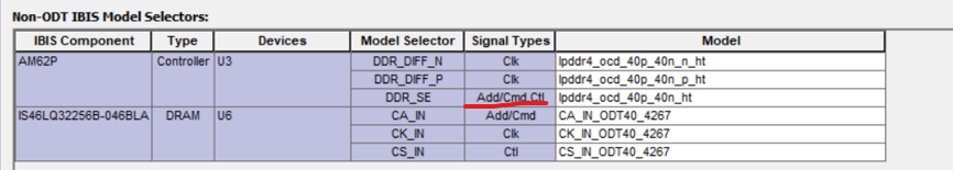

       What is troubling us now is how to adapt the configuration parameters in the AM62Px DDR subsystem to the simulation parameters in Hyperlynx, as shown in the figure below. Is there a simulation guide that can be provided to us? Thank you!

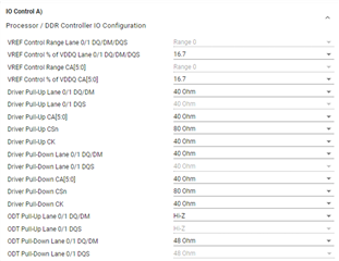

    1、CSn for the DDR Controller:
           In the simulation software, there is only the Add/Cmd,Ctrl configuration, and no separate Csn configuration, as shown in the figure below. Can I understand that in the AM62Px DDR subsystem, the 80ohm pull-up and pull-down of CSn needs to be configured to 40ohm to keep it consistent with Add, etc.?
    DDR Controller:
    • Driver Pull-Up/Down Lane 0/1 DQ/DM/DQS (DQ/DQS/DM driver): 40ohm
    • Driver Pull-Up/Down CA[5:0] (CA driver): 40ohm
    • Driver Pull-Up/Down CSn (CSn driver): 80ohm
    • Driver Pull-Up/Down CK (CKp/n driver): 40ohm
    • ODT Pull-Down Lane 0/1 DQ/DM/DQS (DQ/DQS/DM termination): 48ohm

  • Hi Yong,
    1. The controller has separate driver control for CS and CA.  As was done in the AM62Px configuration, i think you should keep CA 40ohm driver, CS 80ohm driver.  And then in the memory, you can choose 80ohm termination.  With the split CA bus, this would be the best way to match impedances.  What is the trace impedance on your board?

            We designed the layout according to the DDR guideline: point to point, single-ended impedance is 40 ohm
             As described in my question, for Hyperlynx software configuration, CA and CS cannot configure the drive strength separately, that is, CA 40ohm driver and CS 80ohm driver cannot be achieved; so my question is, in this case, should I keep the driver of CA and CS consistent so as to match the simulation results?

    Thanks, discussed with customer:
    #1. There is not separate CA and CS driver strength setting in Hyperlynx, this is the reality, it is a popular simulation tool not just for TI.
    #2. So can only simulate with same 40ohm impedance for CA and CS, and it passed simulation.
    #3. Their prototype boards passed test with 40ohm configuration so far.
    Questions:
    #1. Still need to change CS to 80ohm in DDR configuration?
    #2. Where is the recommended 80ohm comes from? and why need to be 80ohm?
  • Tony, i would say if they can pass simulations with a certain impedance, then they should use that for silicon.  They should still perform memory stress tests across temp to ensure robustness.
    Since memories only have one setting for CA/CS, we choose 80ohm.  Then since CS is point to point, CS driver is set to 80ohm.  Since CA signals are T-branched, CA driver is set to 40ohm, and because of the T-branch, each branch would then be 80ohm.  This combination provides the best chance for impedance matching.

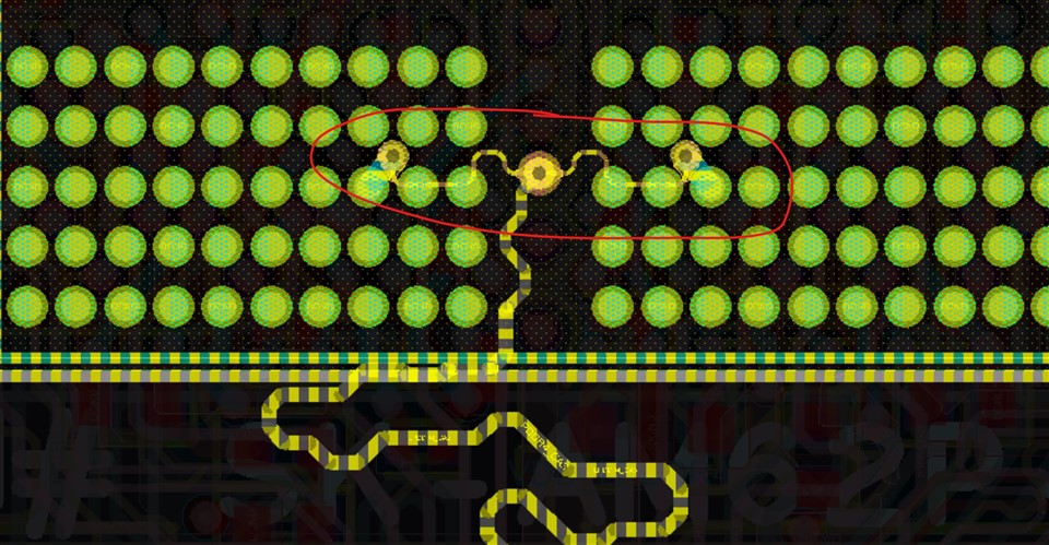

  • Since CA signals are T-branched, CA driver is set to 40ohm, and because of the T-branch, each branch would then be 80ohm.
    On EVM board, there is only one DDR device, what is the T-branch comes from? inside the DDR package?
  • Hi Tony,
    No, the CA signals are T-branched on the board to both A and B channels on the memory:
    Here is an example of one of the CA signals from the layout
    James
