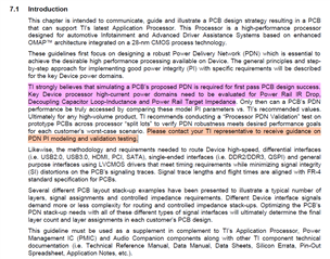

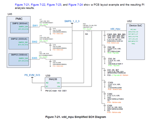

Hello.
I would like to know if you have more information on PI Modelling and Validation or PDN Design Guides that, for example, include more practical examples such as those in point 7.3.8 of the Processor Datasheet.
Thank you very much.
