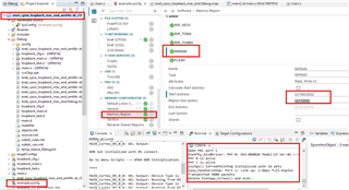

I have created a project as follows:
  1.Import empty_am64x-sk_r5fss0-0_freertos_ti-arm-clang
  2.Copy example.syscfg
  Copied from: {SDK installation folder}\examples\networking\enet_loopback\enet_cpsw_loopback\am64x-sk\r5fss0-0_freertos\example.syscfg
  Copy to:     My project folder

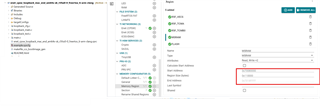

  3.Modify example.syscfg
  Memory Configurator > Memory Region > MSRAM
  start address 0x70080000 => 0x700C0000
  region size   0x110000
4.Copy the enet_cpsw_loopback application source files from the SDK installation folder
  loopback_cfg.c
  loopback_main.c
  loopback_test.c
  loopback_common.h
  loopback_cfg.h
5.Modified CCS project settings (added include path, etc.)
6.Clear FlashMemory => r5f 0-1 cores only
UART LOG:

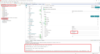

0: Internal MAC loopback
1: External PHY loopback
Enter option: 0
Enet Loopback: Iteration 1
CPSW_3G Test
Enabling clocks!
EnetAppUtils_reduceCoreMacAllocation: Reduced Mac Address Allocation for CoreId:2 From 4 To 2
Mdio_open: MDIO Manual_Mode enabled
EnetUdma_openRxCh: [Enet UDMA] UDMA RX Channel open failed: 0xfffffffb
EnetHostPortDma_open: Failed to open Enet DMA RX channel: -1
Cpsw_openInternal: CPSW: Failed to open CPSW DMA
Assertion @ Line: 1027 in /nightlybuilds/mcupsdk_internal/jenkins/mcu_plus_sdk_am64x_09_02_01_05/source/networking/enet/core/src/per/V1/cpsw.c: hCpsw->hRxRsvdFlow != NULL
    I ran an External PHY loopback.
    Enter option: 1
    CPSW_3G Test
    Enabling clocks!
    EnetAppUtils_reduceCoreMacAllocation: Reduced Mac Address Allocation for CoreId:1 From 4 To 2
    EnetPhy_bindDriver: PHY 0: OUI:080028 Model:23 Ver:01 <-> 'dp83867' : OK
    PHY 0 is alive
    PHY 1 is alive
    initQs() txFreePktInfoQ initialized with 16 pkts
    Cpsw_handleLinkUp: Port 1: Link up: 100-Mbps Full-Duplex
    Transmitted 5000 packets
    Delete EnetApp_txTask() and exit..
    Yoshiki
    If the start address is 0x700C0000, the program terminates abnormally.

    When I run the enet_cpsw_loopback application with DDR, it terminates abnormally.
    The same error occurs.
    hCpsw->hRxRsvdFlow ! = NULL
    Could this be due to the same cause?
    Below are the error messages.
    EnetUdma_openRxCh:
    Cpsw_openInterval:
    These are failing.

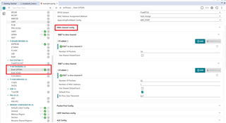

    I have checked the syscfg.
    The syscfg has Enet(CPSW) and DMA channel config definitions.
    If I change the memory allocation, do I need to modify these definitions?
    I don't see any configuration items in syscfg, so I don't know.

    My empty project should be the same as the sample code except for the address.
    I want to solve this strange error .
    I will check the url .
    "not assigned" to particular core or busy."
    I will look into why this error occurs.
    Thanks.
    I will post the results here.
    Yoshiki
  • Hello Ashwani
    I am having trouble with this error.
    Someone else is suffering from the same error as me.
    https://e2e.ti.com/support/processors-group/processors/f/processors-forum/1097991/sk-am64-ethernet-access-from-freertos/4081226#4081226
    Would following the URL below solve the problem?
    https://e2e.ti.com/support/processors-group/processors/f/processors-forum/1216936/faq-processor-sdk-am64x-enet-layer-2-cpsw-example-not-working-on-am64x-mcu-sdk-08-05-00-24
    {SDK install folder}\source\networking\.meta\enet_cpsw\templates\am64x_am243x\enet_soc_cfg.c.xdt
    numMacAddress has not yet been corrected to 3.
    I do not know how to build the SDK. I asked the question yesterday on e2e.
    I'll try <gmake -s -C *** all>.
    I still have questions.
    I will do some more research and post back.
    There is no enet_cpsw_loopback_mac_end sample in the mcu_plus_sdk_am64x_09_02_01_05 folder.
    I think you have the wrong SDK version.
    Please let us know the version.
    Yoshiki
  • Hi -san,
    I tried things on latest SDK MCU-PLUS-SDK-AM64X Software development kit (SDK) | TI.com
    Today, Itried with SDK 9.2 SDK example for R5F-0_0.
    MSRAM region change to "0x700C0000" and size "0x110000".
    It give no error.
    It seems to me a resource allocation problem for another core of R5F.
    You can refer makefile presnt in  {SDK install folder} = C:\ti\mcu_plus_sdk_am64x_09_02_01_05
    Ashwani
  • > "It give no error. "
    Why??
  • Because it is working fine on my setup.
    Please review my steps and let me know if you have any query?
    Ashwani
