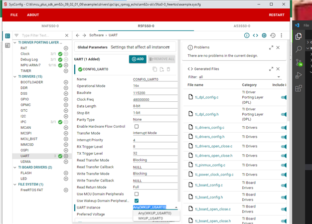

WKUP_UART0 outputs log when booting and executing rpmsg echo.
Sciserver Testapp Built On: Mar 15 2024 16:54:15
Sciserver Version: v2024.03.0.0-REL.MCUSDK.09.02.00.24+
RM_PM_HAL Version: v09.02.07a
Starting Sciserver..... PASSED
[IPC RPMSG ECHO] Version: REL.MCUSDK.09.02.00.24+ (Mar 15 2024 16:55:13):
[IPC RPMSG ECHO] Remote Core waiting for messages at end point 13 ... !!!
[IPC RPMSG ECHO] Remote Core waiting for messages at end point 14 ... !!!
I found WKUP_UART can be disabled in related question but I couldn't know the specific method.
Could you inform me how to disable WKUP_UART?

    I suppose these are the logs from wkup_uart0.
    I would suggest you to go ahead and remove the wkup_uart0 instance. That will make sure you do not see the logs over wkup_uart0. I hope that clarifies.
    The sysconfig window should be your go to point to remove the wkup_uart0 instance.

  • Hi Vaibhav,
    I ask additionally question.
    (1) The instance can be remover in MCU+ SDK and built as ipc_rpmsg_echo_linux.release.appimage.
    (2) I would like to boot linux with SPL. For that, I should replace ipc_echo_testb_mcu1_0_release_strip.xer5f to the above appimage in u-boot-ti-staging.
    I tried their.
    It seems that wkup_uart is already disabled, so I just only disabled "Enable UART Log".
    At the result, wkup_uart console could be disabled.

  • (2) I would like to boot linux with SPL. For that, I should replace ipc_echo_testb_mcu1_0_release_strip.xer5f to the above appimage in u-boot-ti-staging.
    Hi Koji,
    You need to replace the .out file, not the appimage.
    From the logs looks like DM is not running.
    Please check the below thread for the steps to build and replace the binary file correctly.
    https://e2e.ti.com/support/processors-group/processors/f/processors-forum/1308171/sk-am62a-lp-running-the-mcu-application-through-the-sd-card-boot-mode/4972931#4972931
    Aparna
  • Hi Aparna,
    When I used .out file, I could disable WKUP console.
    Finally, I could disable all of consoles.
    Thank you for your support.
