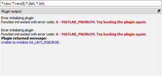

We are integrating IMX662 in TDA4VM in Linux SDK 9_00_02 for our customer and we are in the process of tuning the ISP/VPAC. We have been granted access to the DCC tool. We tried installing the application and faced "MSVCP110.dll" missing error.
We installed all the necessary applications ie. MS Visual Code Redistributable and Matlab r2015b yet the issue persisted. We had to manually copy the files to DCC folder to launch the application. Even then, few plugins ie Color Correction, EE, CFAI+WDR which are necessary for tuning the ISP/VPAC did not launch and throw the below error message.
Can you help us resolve this issue. We have an customer request dependent on this
  • Hi Yoosuf,
    That looks like problem with MCR.
    We are not able to reproduce that issue on our side.
    Could you please check if you have installed all the dependencies below?
    1. MATLAB Compiler Runtime version 9.0 (64-bit) [LINK]
    2. Microsoft Visual C++ 2010 Redistributable Package (x64) [LINK]
    3. Visual C++ Redistributable for Visual Studio 2012 Update 4 (x64) [LINK]
  • If you have trouble with V3.2, could you please try installing V3.1 to confirm if the issue persists in your system?
  • Hi ,
    Yes, we have installed all the dependencies.
    We installed v3.1 also and the issue persisted.

  • Hi Yoosuf,
    It looks like an issue of loading Matlab runtime properly in your system.
    Could you please check if path is set up correctly for Matlab runtime?
  • Hi ,
    I have verified the path variables, but nothing seems to help and still we are at the same point.
    Do you have any steps/methods to resolve this? It would be really very much helpful if you could.
  • Hi Yoosuf,
    This looks like an issue about Matlab and Windows and we don't understand why it happens.
    On the Windows PCs we have at TI, we have not been able to reproduce this behavior.
    Is it possible for to try on a different PC?
    BTW, which Windows version do you have?
  • Hi ,
    We checked with 2 Windows PC we have and we face similar problem in both the PCs
    We two systems running. One Windows 8.1 and another running 10pro
  • Hi Yoosuf,
    Thanks for the information!
    We only have 10pro at TI.
    My friend is looking at this issue now.
    It is a weird problem which we have not experienced previously with other customers.
    We are not sure yet if it is due to Matlab, Windows upgrade, installation, or any other dependencies.
  • Hi Yoosuf,
    may share with you some debug installer for you to try on your PCs.
    I would recommend trying the new installer and install the tool under your Windows account home folder rather than the default "c:\ti\DCC\".
    Let's see if that makes the tool working properly in your system.
    Please private message Chau to get the debug installer.

  • Hi ,
    Sorry for the delay. I was out of office for past few days and was unable to test the application.
    We tried installing the latest tool under "Windows" folder and we are not even able to access the tool properly. It closes as soon as we open a project and provide the sensor details.
    Also we tried installing it under "Program Files" and faced the previously reported "Matlab Runtime" issue.
    We also verified this behavior on two different PCs running Windows 10 pro and Windows 11 pro.
  • Hi Yoosuf,
    That sounds like a Windows user account issue.
    Could you please install the tool under your own user account?
    That is typically under "C:\Users\your_name\".
    Be default, it is installed at "C:\ti\" and most customers are fine with that.
    If you have any access issue, installing it under your own Windows user account folder may be better.
