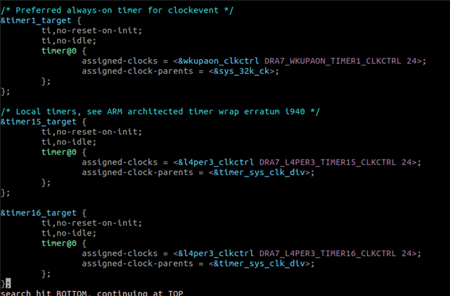

I'm trying to upgrade the linux kernel for one of our products. We have run 4.4.0 until now. When booting linux 6.1 I run into some initializations issues and later on a kernel panic.
The first timer initialization error marked in red seems to come from the dmtimer_percpu_timer_init() function function in timer-ti-dm-systimer.c. It returns -EINVAL since the timer belongs to cpu #1 which does not exist on AM5708. The function is called from here and as you can see dmtimer16 has cpu argument set to 1.
static int __init dmtimer_percpu_quirk_init(struct device_node *np, u32 pa)
    struct device_node *arm_timer;
    arm_timer = of_find_compatible_node(NULL, NULL, "arm,armv7-timer");
    if (of_device_is_available(arm_timer)) {
        pr_warn_once("ARM architected timer wrap issue i940 detected\n");
        return 0;
    if (pa == 0x4882c000) /* dra7 dmtimer15 */
        return dmtimer_percpu_timer_init(np, 0);
    else if (pa == 0x4882e000) /* dra7 dmtimer16 */
        return dmtimer_percpu_timer_init(np, 1);
    return 0;
Can you give me some advise how to solve the initialization errors and the kernel panic?
Thanks in advance!
BR,
Jonas

  • Jonas,
    Can you try the base image and report the results?
    Have you modified the following nodes from your DTS?
    -Josue
  • Hi Josue,
    I took the zImage from the prebuilt images under: ti-processor-sdk-linux-am57xx-evm-09_02_00_133/board-support/prebuilt-images and built it into my image. I still use my own device tree. It still fails. You can see the kernel log below.
    My dts file does not modify any of the nodes you mention.
    My dts file includes these dtsi files.
    #include "am5718.dtsi"
    #include <dt-bindings/gpio/gpio.h>
    #include <dt-bindings/interrupt-controller/irq.h>
    #include "am57xx-industrial-grade.dtsi"
    #include "dra7-mmc-iodelay.dtsi"
    #include "dra72x-mmc-iodelay.dtsi"
    #include "dra7-ipu-dsp-common.dtsi"
    I could not find a dtsi tile for am5708 so I include am5718.dtsi instead
    Has the release been tested on a am5708?
    Jonas

    [    0.001342] TI gptimer clockevent: always-on 31475 Hz at /ocp/interconnect@4ae00000/segment@10000/target-module@8000
    [    0.002960] TI gptimer percpu-dmtimer: 19200000 Hz at /ocp/interconnect@48800000/segment@0/target-module@2c000
    [    0.003021] Failed to initialize '/ocp/interconnect@48800000/segment@0/target-module@2e000/timer@0': -22

  • Hi Josue,
    Thank you for the help so far!
    I will look into the external abort issue. I doubt that this is the root cause for the timer setup issues though. But perhaps it is related to the kernel dump. Anyway, the External abort needs to be fixed so we will see.
    Regarding the timer failures, would you be able to get hold of a boot log from an AM5708 or AM5718 with the same version of SDK images for reference? It could be that these are normal and could be disregarded. If that is the case I don't have to chase the root cause for these anymore.
    As you can see In the original post timer16 will fail on an AM5708 and AM5716 since it requires a second cpu which this chip does not have.
    BR,
    Jonas
