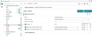

I am trying to test MCAN driver for R5 core therefore I have compiled this example: mcan_loopback_interrupt_am62ax-sk_mcu-r5fss0-0_nortos_ti-arm-clang.
this example use MCU_MCAN1 for sending 1 message kindly check the configuration:
and I could see this output on serial:

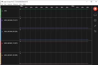

but when I have connected the logical analyzer to the TX and RX pins for MCAN1 I couldn't see any data on them:
Additionally I have tried to change the used CAN channel to be MCU_MCAN0 and while sniffing on the MCAN TX and RX pins I couldn't see any data also.
could anyone support in to identify why I couldn't see any data on CAN TX and Rx pins ?
