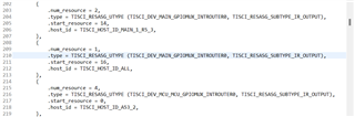

  • Hello Vraj,
    Actually, here is the SCI client problem with the resource allocations.
    Actually, if you look at the above FAQ, I routed GPIO Router 16 output to all destination cores in the sciclient_defaultBoardcfg_rm.c file.
    This change is missing in your environment and this needs to be integrated into your application and later compile the sciclient_defaultBoardcfg_rm.c file and compile the SBL and load the SBL.
    All these steps are properly given information in the FAQ and links you need to go through them and follow the same steps.

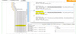

  • Hi Anil,
    Have you tried this thing manually? because when I tried to change the file manually and recompiled the code, then the manual changes were gone.
    This file was auto-generated by SysConfig.
    Can you suggest what I may be missing in SysConfig configurations, due to which I am not able to see the changes as yours?
    Vraj

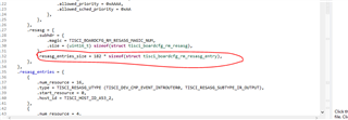

  • Hello Vraj,
    Yes, unfortunately, the above config is not supported in syscfg and I will raise the bug.
    To manually compile, you can follow the steps below.
    Add the router configure below to sciclient_defaultBoardcfg_rm.C file
                .num_resource = 1,
                .type = TISCI_RESASG_UTYPE (TISCI_DEV_MAIN_GPIOMUX_INTROUTER0, TISCI_RESASG_SUBTYPE_IR_OUTPUT),
                .start_resource = 16,
                .host_id = TISCI_HOST_ID_ALL,
    Next, increase the size of the new entry point to 182, and previously it was 181 and now added one entry.
    So, it increased to 182 .The entry size number may vary or not vary based on the MCU+SDK version.
    In my test set up, I have used versions of the MCU+SDK 10 version and, in that, the value is 181 and after adding one entry it is 182.
    Next, to complete these files, give commands below.
     gmake -s -C .\tools\sysfw\boardcfg  SOC=am64x
    After that you can follow steps from the above FAQ.
    Anil.
  • Hi Anil,
    I have implemented the changes you suggested and successfully compiled the sciclient_defaultBoardcfg_rm.C file.
    My EVM kit is set to NoBoot mode.
    Additionally, I recompiled the SBL, from SBL Null example, loaded the JS file as per the provided steps, and also recompiled the sciclient_ccs_init example.
    However, when I run the program, I encounter an error with the Sciclient_rmIrqSet() API, which returns a value of -1. Following this, the message [Error] Sciclient event config failed!!! is printed.
    Could you please assist me in resolving this issue?
    Vraj

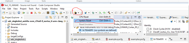

    After this, I load my application via CCS, and it runs without any errors. However, during development, I often modify and reload the application without rebooting the board. In this case, I encounter a SciClient config failure. If I reboot the EVM and then load the application, it works fine on the first attempt.
    I think this is the case which you mentioned in previous answer that SYSFW will not allocate the resources twice. Could you confirm if my understanding is correct? Additionally, is there any way to avoid rebooting the board each time?
    Vraj Joshi
  • After this, I load my application via CCS, and it runs without any errors. However, during development, I often modify and reload the application without rebooting the board. In this case, I encounter a SciClient config failure.
    Hello Vraj Joshi,
    Good to hear that you have solved the issue.
    The DMSC core is creating  an issue.
    As I mentioned above, the GPIO Router 16 output is allocated by the DMSC core when you call SCI call from your application for the first time.
    And, next time you modified  the code and not reset the SOC, then load an application from CCS, then you will get an issue.
    Here, the DSMC core is already allocated GPIO Router 16 to R5F core.
    Again you are trying to call the SCI API to allocate GPIO Router 16 for the second time and this is not possible. Since, DMSC core can allocate Resources for one time if user again sends same request then DMSC core can't allocate Resources and it gives negative response .
    To avoid these SCI client errors, you have to reset (WarmReset from CCS or POR ) the SOC for every loading application from CCS .
    For every loading an application , you do Reset from CCS with the step below and load an application .
    If you flash DMA application from OSPI, then you can't load the same application from CCS again. You may get an SCI client error.
    For development, use the SBL Null and load the Application from CCS and after modifying your code and before loading an application, do reset the SOC either from CCS or POR.

  • Thanks Anil,
    Resetting the System (mentioned in the image) has worked for me. Now I won't need to reboot the evm kit everytime.
